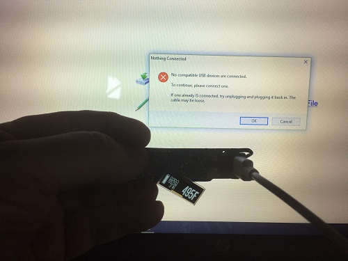

I have tried 4 different cables (all work and recognize my DNA 75). Used 2 different computers WIN 7 and 10 (all work and recognize my DNA 75). Hooked to a fullymax 900. Board will charge fully on USB! All functions work! just can't get it to work with ESribe! Any suggestions?
Why would it recognize the 75 but not the 250?? Am I missing something?? -
Ok explain that? It has power from battery when not hooked to USB and battery did charge to full when it was hooked to USB?
Can anyone help? I had a 250 board that I accidentally shorted out. Filed a ticket sent it in it was is under warranty. Was sent back a brand new board. Thanks Evolv! Customer service is top notch by the way. Anyway I can't get ESribe to recognize the board. I have tried 4 different cables (all work and recognize my DNA 75). Used 2 different computers WIN 7 and 10 (all work and recognize my DNA 75). Used 2 different battery's (fullymax 900). Board will charge fully! All functions work! just can't get it to work with ESribe! Any suggestions?

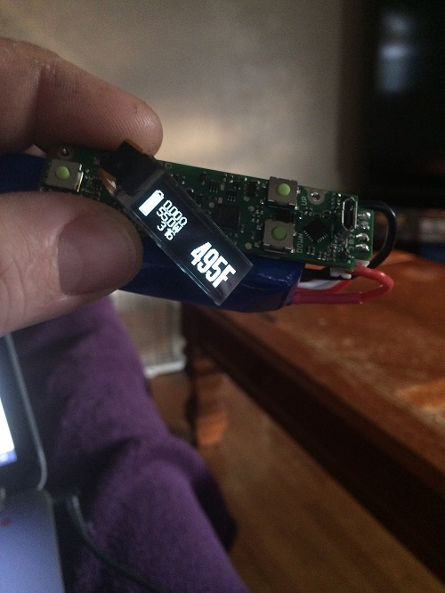

I believe it was my battery. I unhooked the balance charging plug and cell 1&3 read 0 but cell 2 was 1.7v with just the pos/neg leads attached. And when I unhooked the battery completely and only use the USB I could navigate some of the other screens that wouldn't come up before ie normal and stealth. Also when I would reheat the balance charger leads my cell 2&3 would swap volts ie cell2 would be 2.18 and cell 3 would be 5.2 then I would heat up my solder leads and make sure all was right and then cell 2 would be 5.3 and cell 3 would be 1.8 my volts for my cells would be all over the map. So I ordered a new battery actually 2. LOL! Thanks for the help!
I know this may be a dead horse but I'm having issues with my battery. I have done a hard, soft reboot, I have done a USB recovery charge, I have soldered and re-soldered my connections. updated firmware 2/23/16. I'm using a modcrate 950 box with a protovaper 510. I'm very frustrated and ready to toss it out the window! I just got this board and have broke 1 screen already (ordered 2 boards). Software is set to 3 cell lipo. The charging screen never comes up just the running screen. As you can see below none of my cells are below 1v I'm stumped! Any help? Oh and I'm using a turnigy 950 lipo.
