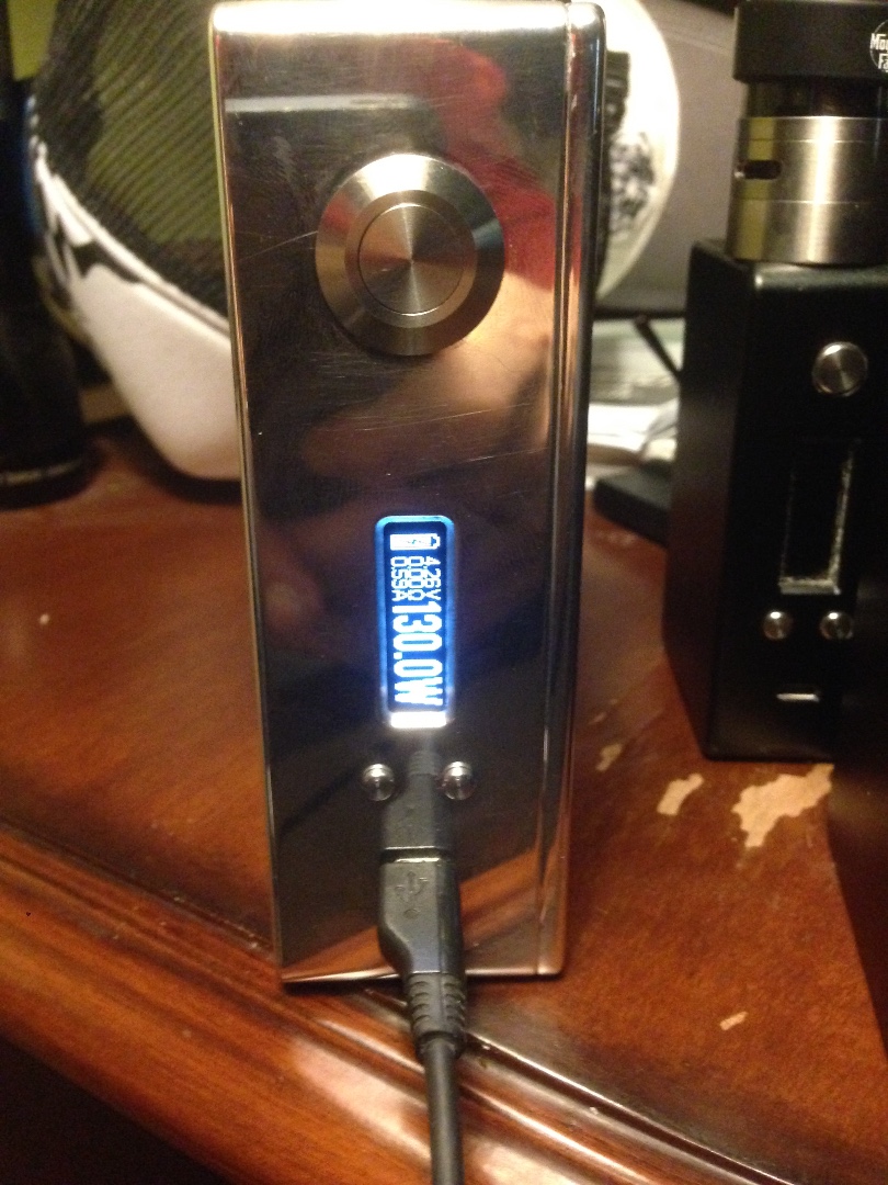

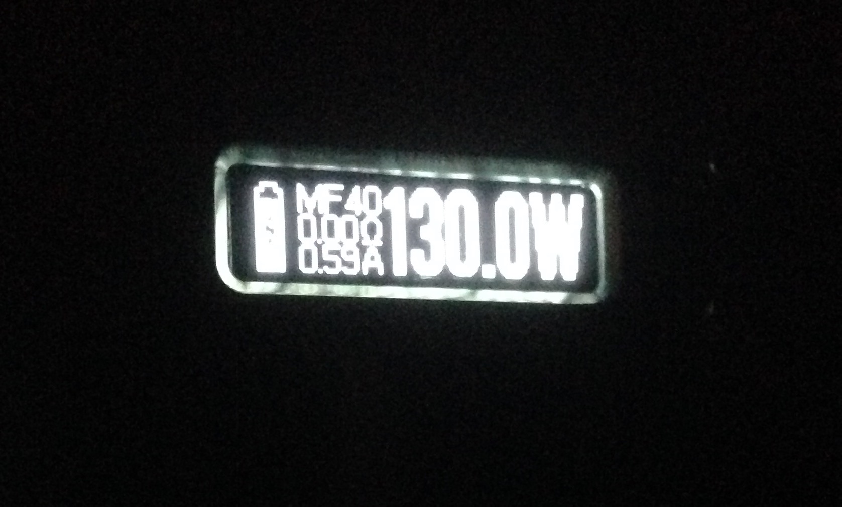

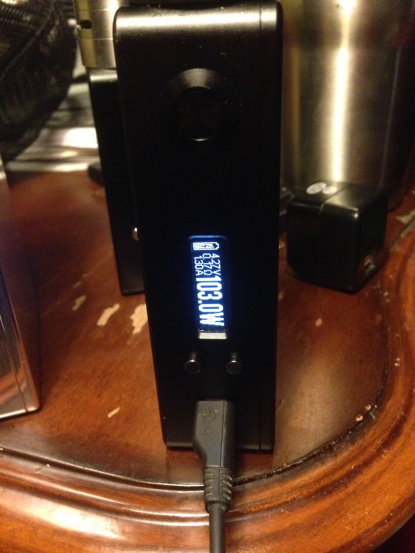

  4. I would understand if this were the case on all mods but it is this mod in particular. The same USB block and cable provide 2a (1.97a) charging on other mods without issue. I will set USB voltage on screen of two different mods and use various cables. Same block with the same cable produces same charging voltage and different amp. First picture is mod in question Second picture is another mod with same block and cable.
  5. Best I can do on tablet is picture with phone, print screen acts idiotic. I'll try though

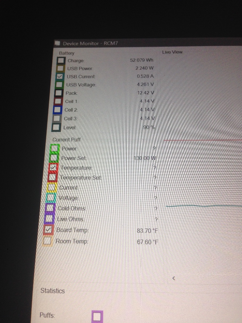

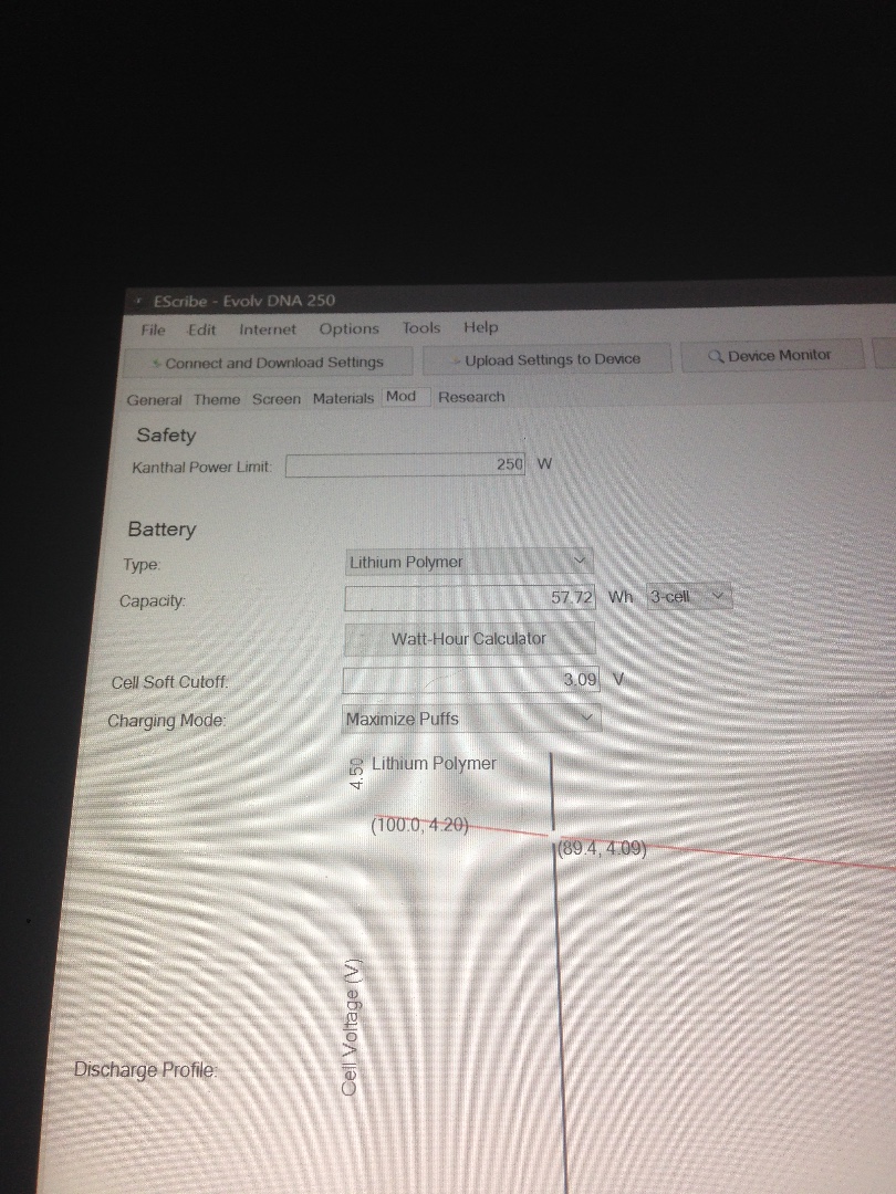

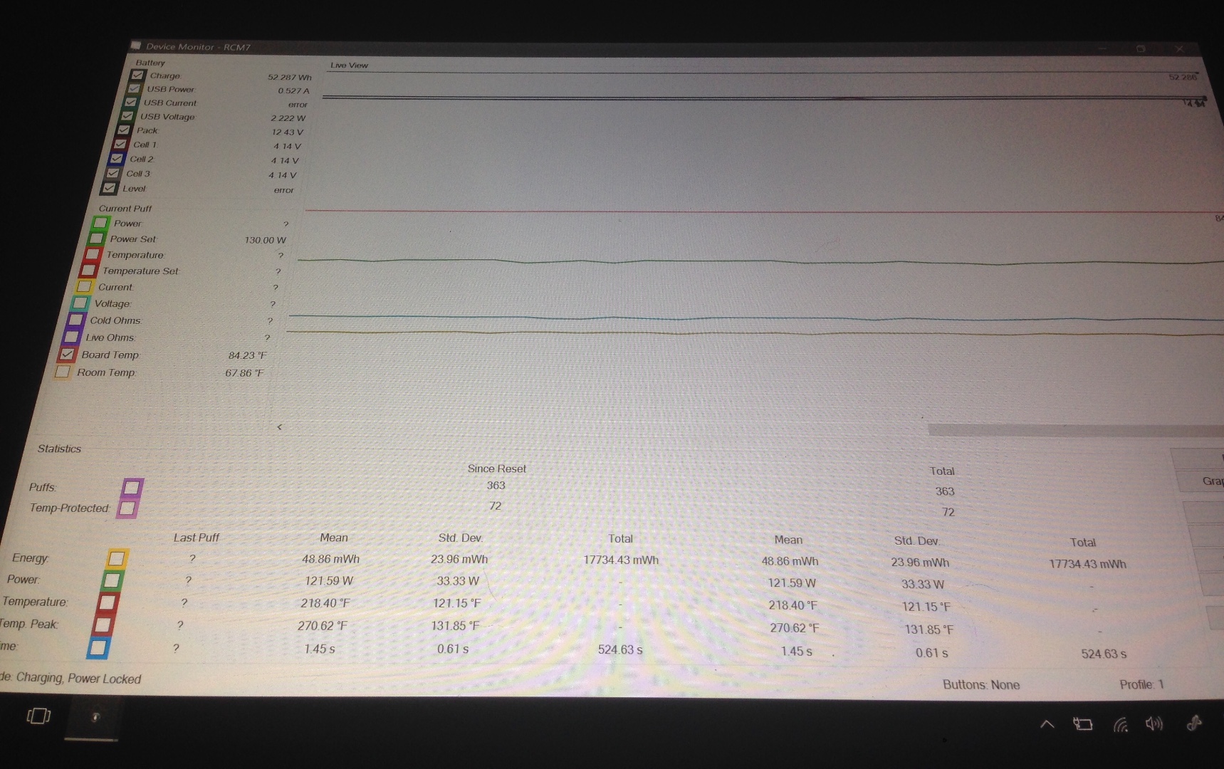

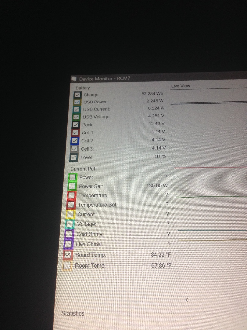

  6. First picture is of board screen when attached to wall charger that has verified output of 1.97a on another DNA 250. Second picture is of battery settings. Third picture is of device monitor with USB current and device board temp checked. Fourth and fifth picture with all battery settings checked. Firmware version 1.2 SP5
  7. Recently built a DNA 250 with a 5200mah lipo and the board is only allowing .59a input. I have tested cable and charging box on other DNA 250 mods and it supplies 1.97a so it has to be in the board. All settings have been changed to the correct value for battery. I can deal but charging this massive battery at .59a is extremely slow.
