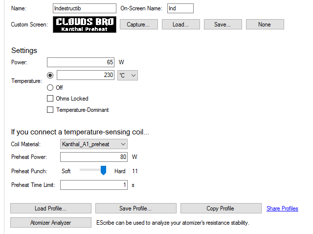

  1. Just click 'Restore Defaults' on the General Tab in Escribe. This will reset your device to the manufacturer settings.
  2. After this add the new wire to your Kantal Preheat profile. The pic shown below is from a profile on my Finder 133 but its the same on a DNA75 (except the 80 watts preheat... just make it 75). For big coils like claptons I set the punch to 11. For normal ones 5 or 6 will do...
