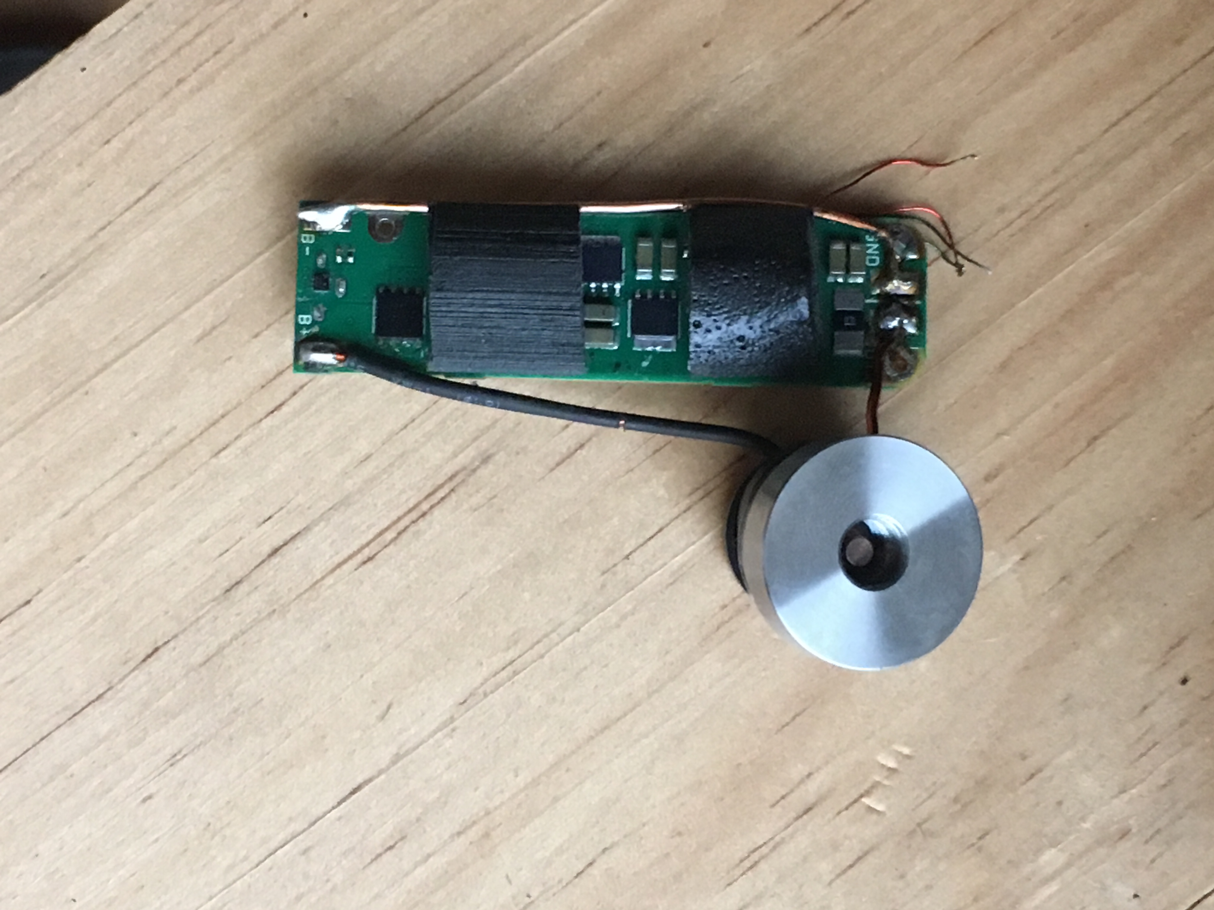

Nope, this is how the mod looks like from the top and bottom. As you can see there is no grounding wire to the battery negative pole. . 0
That is exactly what I thought, but this guy's acolytes kept telling me I was wrong regarding the "floating" set up, IMO it is missing a wire that connects B- to the battery negative pole.
I agree but since the chip is "floating" I guess this is why he did it this way. The OUT wire I cut to get it out of the mod it was longer and had insulation
Buddy I did not make this board, took it out of a shit mod that cost me 480 pounds for a DIY project. The chip is glued to a plastic sled, does not touch anything and the only two cables are for the B+ to the positive terminal of the battery and the power to the 510 pin. Here are some pics, maybe it is clearer.
Is this board wired correctly? Bear in mind that the B- does not go to the actual battery minus but is free standing.

Ok guys, I need your help. I am on another group where I gave a mod a bad review. Well along the discussion the subject that the chip on the mod is not grounded and these guys are telling me it does not need to be grounded, that it "earthens" (whatever that means) through the 510 pin....how can I explain this guy he is full of it and does not know what he is talking about? BTW the chip is not grounded to the 510 chip either.

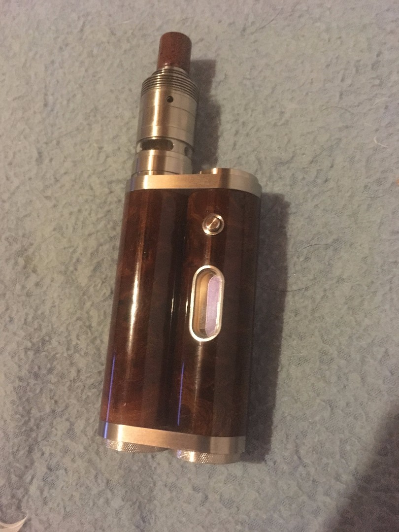

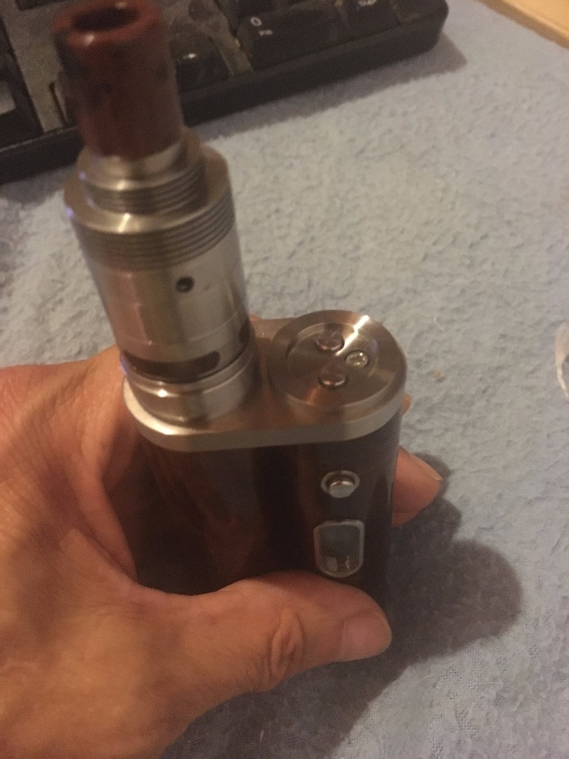

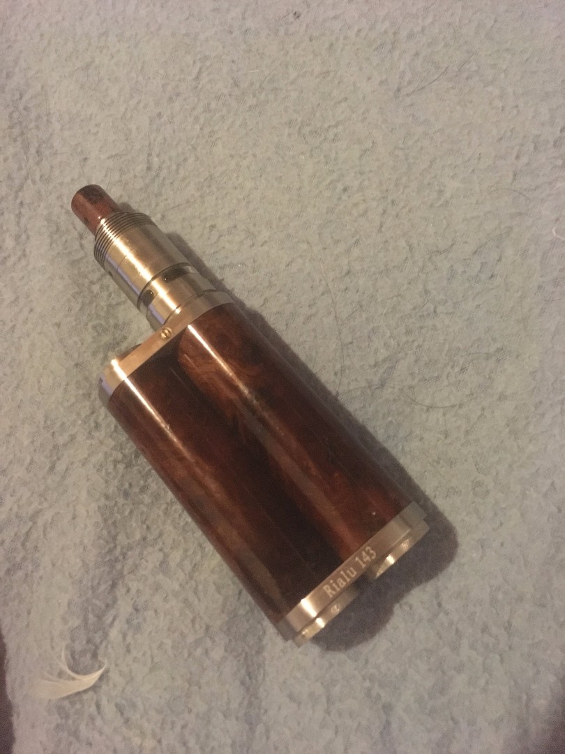

So guys, I have a mod from Lee Ash in England, he put a DNA 75 chip in it, but no USB port. Can the USB port on the chip be directed downward instead of to the side? I don't want to drill the wood. Here are a couple of pics of the mod so you get a better idea, the tube that has the window has a scre cap on the bottom that I could use to connect the chip. -
