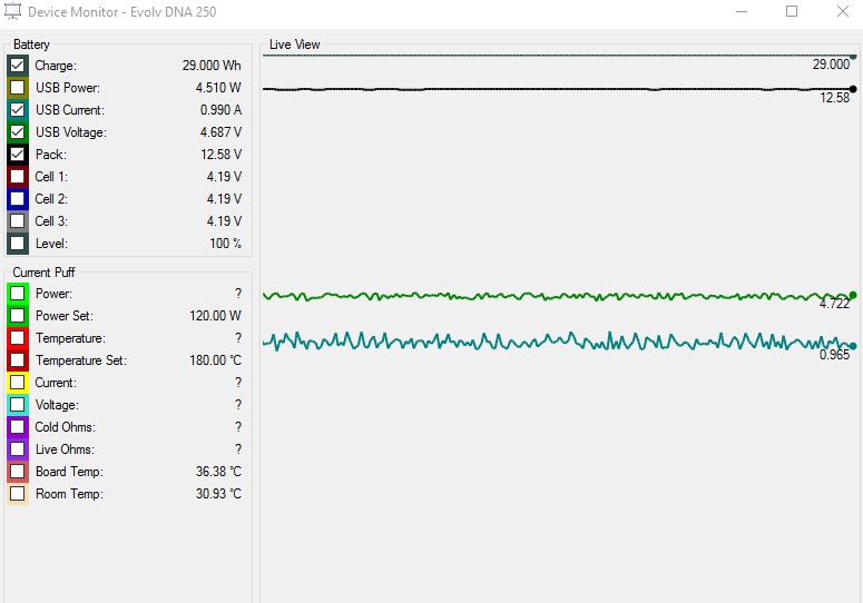

In regards to the Wh battery level. I am using the HG2 X3 @ 28.3wh kindly provided by giz_60. i have been charging this on my PC with device monitor open, was expecting it to stop charging once it hit the 28.3Wh but its been still charging for another 30min. I increased to Wh to 29Wh, it's now charged to the 29Wh and is still charging. Does this mean the Wh capacity is greater that what i have entered? should i keep increasing it?

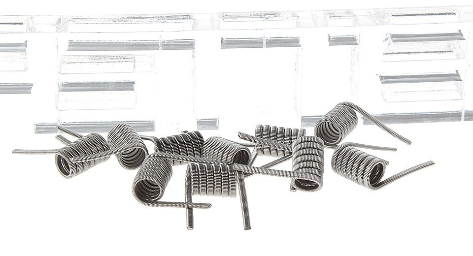

I'll try get that done tonight... but when you say contact coils could be a problem? am i supposed to be suing spaced coils only for TC mode? see from the fast tech website the coils i'm using below.
So I only been vaping in TC mode, MKWS SS316L Alien pre coiled from Fasttech (dual @ 0.15Ohms) lately the triade will spaz out and fire the coils like crazy like im running the full 250w into it and the last temp on the screen will show it has not even hit 100c, sometime it doesn't even get over 50 cause is smoking like a MOFO. the temp build up on the screen (right side) will sometimes climb up to 4000C... WTF? now i have checked and nothing is touching or shorting on the RDA. i have the rashomon RDA and Goon RDA both with the same coils, when it spazes out i immediately swap to the other RDA and it does the same thing. i switch between power and tc mode to fix it or sometimes when it cools off it goes back to normal... any ideas what it could be? are the coils dodgy? i am waiting on my coil variety pack and standard SS wire to arrive in the mail so i can't compare with diff coils as yet. any ideas?
