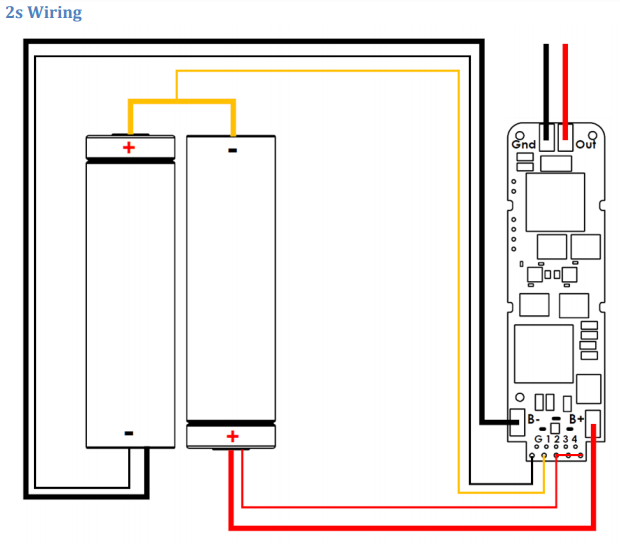

I did! You can wire it using the shortcut, but it will result it voltage drop across the board, which means the board will believe your batteries are slightly more "dead" than they really are. This is minor, but it is there so it is recommended to run the extra wires. You can use the shortcut though, and it is safe to do so. I ended up running the extra wires.

Good morning @retird! I feel like I may not have been clear. I know G, T1, T2, T3, and T4 control the balanced charging, and I know that the DNA boards support Vape while Charging (the charging circuit actually shuts off when you press the fire button so it isn't actually firing while charging, but it does allow you to use the device while it is plugged into USB for charging). What I'm looking to find out is whether or not I have to run the small charging wires parallel to Battery Sled Positive and Battery Sled Negative, or whether I can bridge the connections at the board. Below is a picture of a DNA250C build by David4500 (he's a big contributor to reddit.com/r/OpenPV). It certainly looks like he has gone with the bridging method in the picture (the second wiring diagram I linked in my post), and there are no secondary charging wires run from Battery Sled Positive and Battery Sled Negative (the top of the sled in the picture). He only ran the wire from the bottom of the battery sled (where Battery1 negative is connected to Battery2 positive) to T1 on the charging circuit. G on the charging circuit looks to be bridged off of B- on the chip, and T2, T3, and T4 appear to be bridged off of B+ on the board. I'm looking for confirmation on whether or not wiring as shown in my second wiring diagram (and appears to be shown on the build in the picture below) will work properly. In the end, what the "shortcut" method does is use the same wire for drawing in battery power as it does for sending power out to the batteries. Since the charging circuit shuts off when you fire the mod while it is plugged in, this "should" work fine in theory since the single wires to the battery sled positive and negative would never be drawing current (firing the mod) and sending current (charging the batteries) at the same time. The only risk I see in using the shortcut is that power is delivered to the charging circuit when you fire... But electricity takes the path of least resistance, so there should be no excess power delivered to the charging circuit. That said... I didn't engineer the board, and while I'm very familiar with board level IT work since I do it, I don't know if there is anything funky in this chip that would make this "shortcut" wiring not work properly. So in short, I know exactly what all of the pins on the board do. I know Evolv made this chip to support up to 4 cells, and that the charging circuit connections are laid out the way they are it to make is very easy to plug it into a LiPo battery by soldering a JST XH or JST PH connector directly onto G, T1, T2, T3, T4. For people using a battery sled though, the "shortcut" wiring method of bridging B- to G and B+ to T2, T3, and T4 "should" work. I'm just looking for clarity from someone who has done it saying "yes you can do that, I do that" or someone knows more about the way the charging circuit works to tell me something like, "No, this will send excessive voltage into T2, T3, and T4 which will burnt out your charging circuitry".
Hey everyone! All of my parts for my custom build came in today, and it will be the first mod I've built! I have a wiring question though. Here is the wiring diagram from the DNA250C manual: I noticed that there are two wire going form battery negative to B- and "G". Additionally, the positive going to the B+ has a second wire going from positive to 2, 3, and 4. So instead of running a second wire from Positive and Negative of the batteries, Can I just bridge B- and B+ to "G" and "2, 3, 4" respectively? Here's a diagram showing what I mean: Would the above allow the mod to draw from the batteries and do the balanced charging? And allow me to vape while charging? Or do I need to run the second wires? I've been looking at pictures of people's non-LiPo builds, and none of them show how they wire up the balanced charging due to the picture angle, but none appear to have a second set of wires from battery positive and negative to the balanced charging, so I'm assuming they are wired up bridged from B- and B+ like in my second photo. That or people don't connect the charging. Anyway, I'd love some clarity on this before I do my build this weekend! Thank everyone!

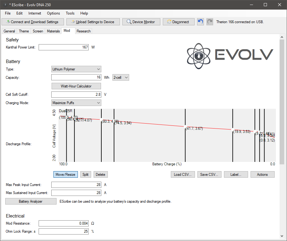

.004 for mod resistance is what the default is. I have not reset this for my mod yet, as I don't know how to get the mod's internal resistance value to put into eScribe. I assume it will be covered in the Evolv Training Course that I'm going through, I just haven't gotten to anything covering that yet. To my knowledge (and I could be wrong here), eScribe and the mod will use the settings provided, so even if .004 is wrong for my internal resistance, it should still set Cold Ohms to Nominal Ohms. So if my internal resistance was .007 but set to .004, the mod should still use .004 for nominal / cold ohms. In my case, Nominal Ohms is always .004 below Raw Ohms (as it should be). But Cold Ohms is always about .005 - .006 below Nominal and I have no idea why. -

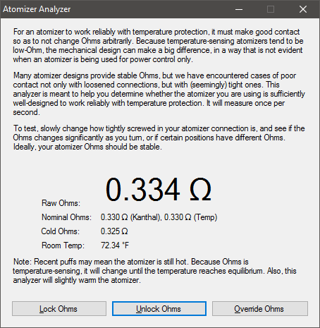

@Giz_60 Mod Resistance value is set to .004, as shown in the third picture of my original post. The first picture in my original post shows the issue with Raw, Nomimal, and Cold. I took that screenshot after letting the mod sit for 30 minutes while plugged into eScribe running the Atomizer Analyzer. I've entered what is shown in that screenshot below: Mod Resistance: .004 Raw Ohms: .334 Nominal Ohms: .330 Cold Ohms: .325 Raw and Nominal are correct. Cold ohms was set to .325 instead of .330 (to my knowledge cold ohms should be equal to nominal ohms when the coil has cooled to room temp). I've repeated this about 10 times with different builds on different atomizers and each time cold ohms are set lower than nominal ohms. -

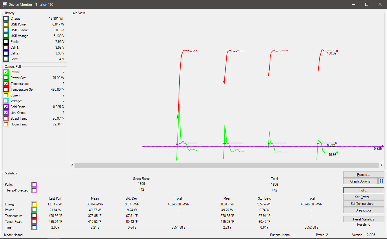

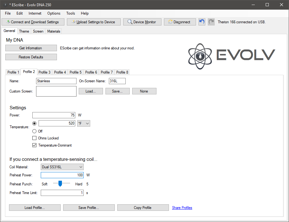

I got a Therion 166 earlier in the week, and spent a lot of time over the last two days trying to get TC to work well. My issue is that I'll put a coil on the mod and open the atomizer analyzer. I'll use the values of my current coil in this example, which fluctuated between .333 and .335. The internal resistance is set to .04, so the cold ohms should be read be ~.330, however the mod sets the cold ohms to .323-.325. I do get a consistent vape, but I have to have the temp set for 500-530 or so, instead of the 400-430 I typically use. It isn't "accurate" and that bothers me. Several times I've let the coil cool for half an hour, re-attach it, and the atomizer analyzer still shows .334 give or take .001, and when I fire it the cold ohms get set to .324 give or take .001 . The issue happens consistently with every attempted build, I'm looking to see how I can figure out why. Could anyone point me in the right direction? Thank you!! Tank: OBS Engine Wire: Master of Clouds 26g SS316L Build: Dual 9/10 spaced Registered Ohms: .334 Cold Ohms: Incorrectly get set to .323 I used the follow Steam-Engine values: "Temperature (degF)","Electrical Resistivity" -58.0000,0.9230640000 68.0000,1.0000000000 212.0000,1.0800000000 302.0000,1.1260000000 392.0000,1.1680000000 482.0000,1.2070000000 572.0000,1.2460000000 800.0000,1.3369666667
