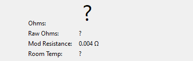

i know seeing my monitor in the background is a bit difficult, but you can see the ? in there (i think/hope). so with an atomizer attached i get the same thing. -

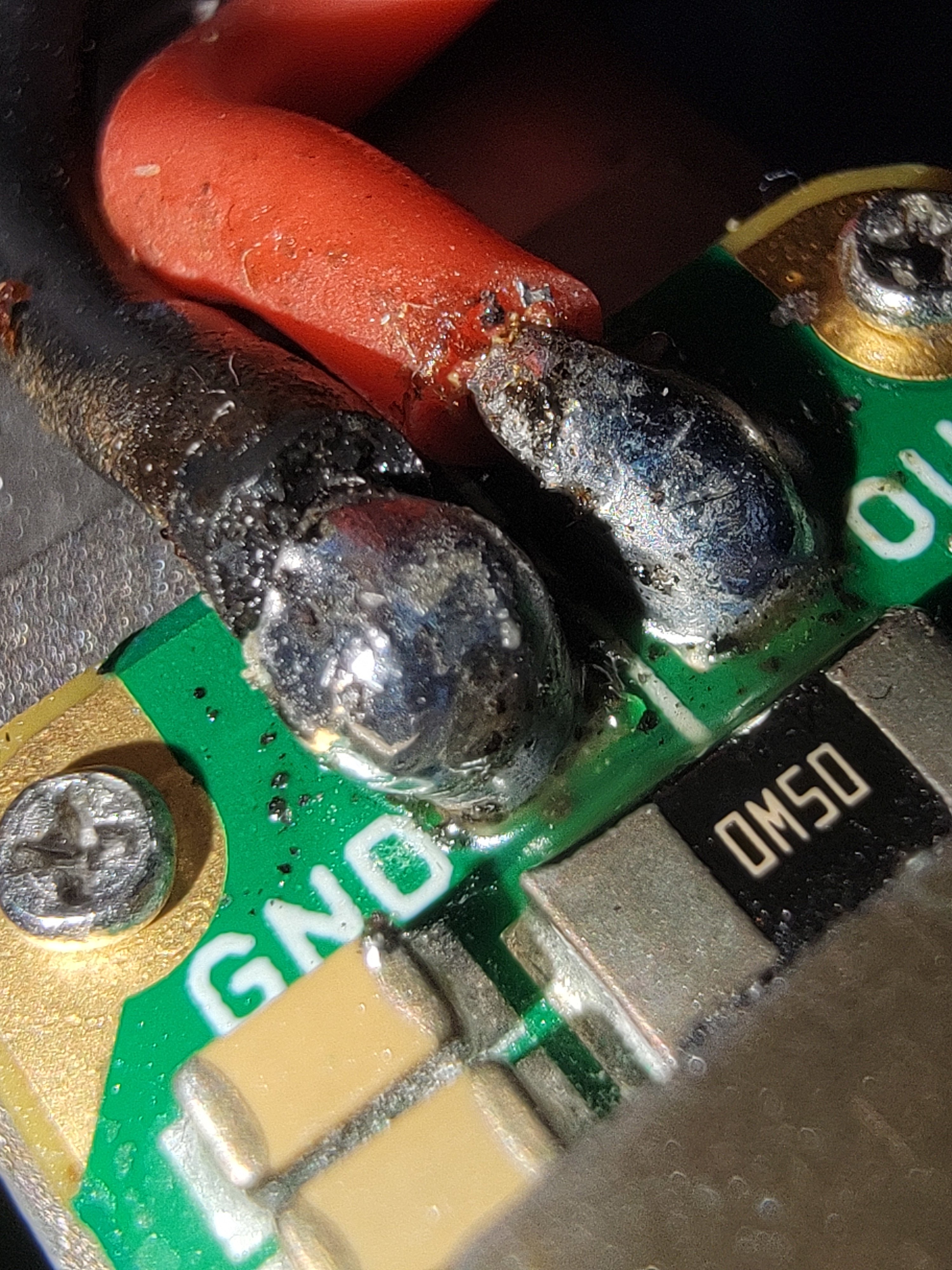

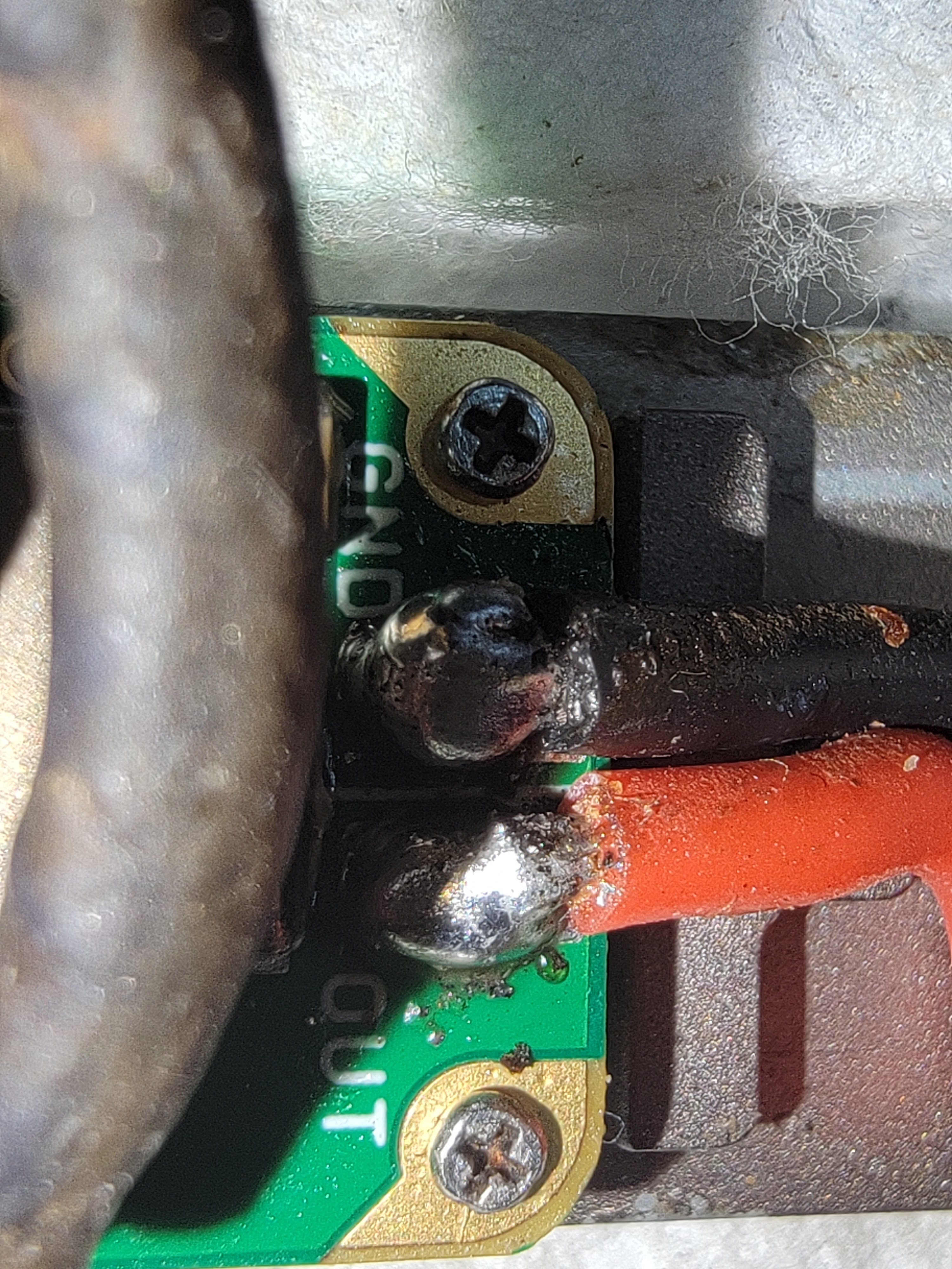

here are the best shot i can get of the 510 soldering points. am i the only one that thinks i can see a piece of solder that's laying a crossed the white line there -

i believe i found the root problem, which i didnt check. so im chalking it up to being blond. I did not check to make sure that all my solder points and areas around such were clean and clear. if you look at the board temp, that give the first clue as to what is going on. I didnt check the soldering around the 510 pads at the top of the board. I took a few pictures with my phone, and i have a crossing connection. so it looks like ill be resoldering the top again. hopefully this will clear up some / or all of the issues.
