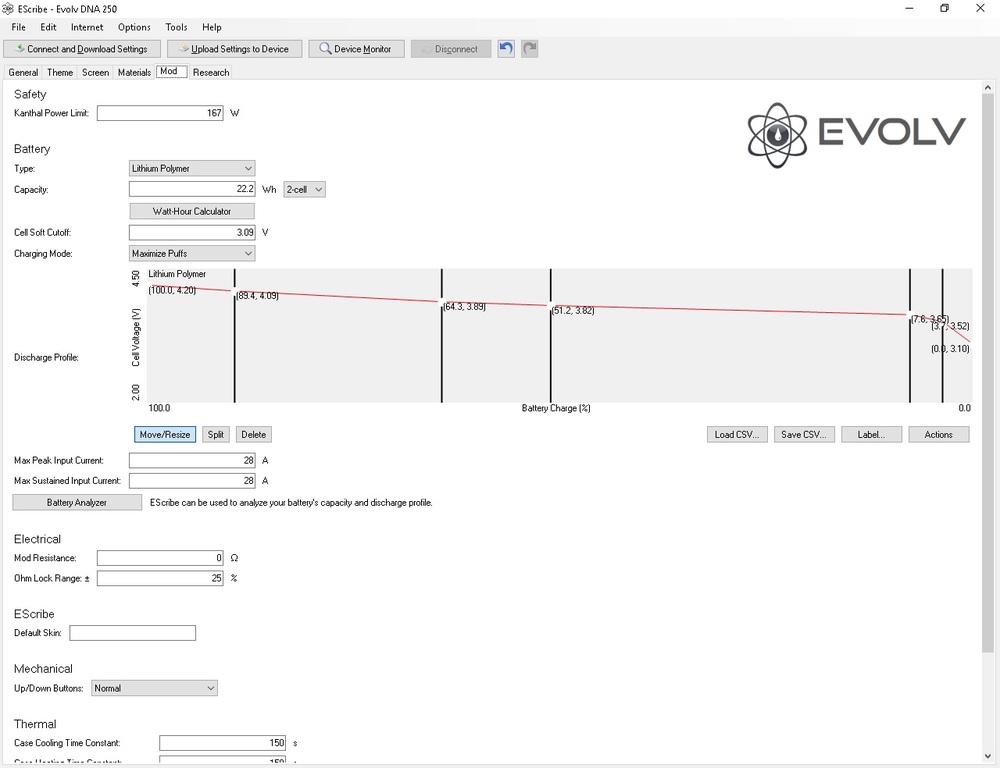

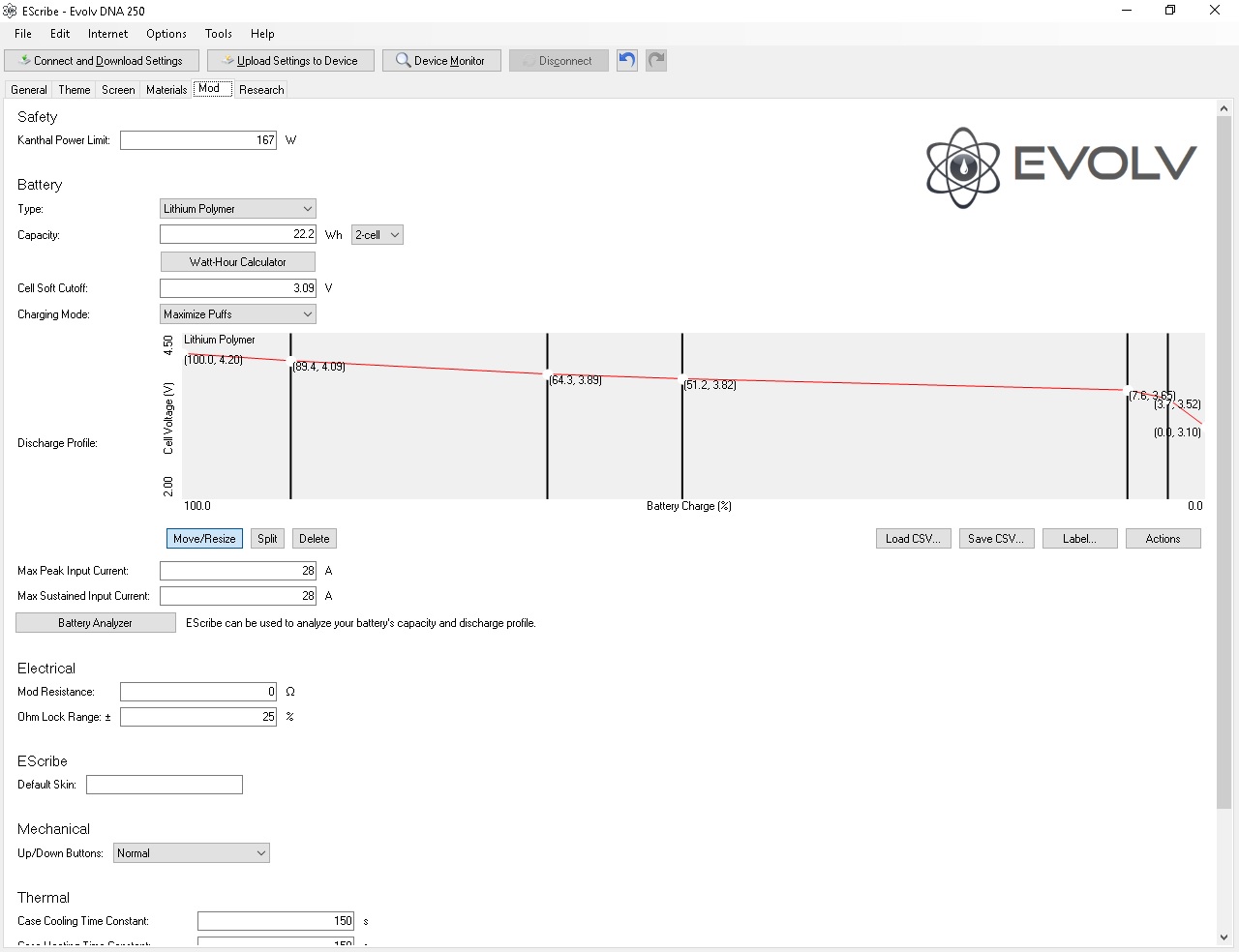

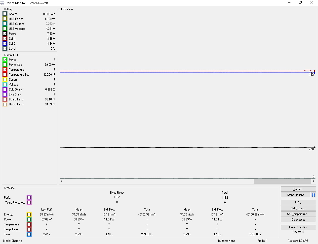

Okay. So im getting pretty anoyied about this.so i got my dna 250 board replacement. it was working fine until today it started acting strange , dna itself started showing that ohm is 0.01 when it actually wasnt tried it with different atomisers , so i just took out and put back in the batteries it was working okay again. but the issue is that it is showing that my battery level is 0% it works fine this time , cause the reason i got a replacement was that it showed 0% aaand i couldnt vape it. now the issue is that it shows 0% while in device manager it shows actual voltage it is 3.6 for now. So i wanted to ask maybe i wired something wrong or what is the problem now ? it was working just fine yeasterday and today until that thing happened... adding my escribe settings. any help would be apreciated. tired hard reset soft , reset , reseting to default.

Tried it already it didnt help as it was already set to 2 battery mode
Oh sorry that was just a copy paste of a letter i sent to think vape themselves my bad... Im not home right now will post it tommorow. But as far as i remember escribe showed that one battery is like 4.4v and another is 0.73 or something , and no it wasnt batteries fault , tried brand new vtc6 , vtc5 , 25r's. the only time i used escribe was to make wh and mah settings to fit my batteries, tried hard reseting , soft reseting... And im pretty hopeless , gearbest refuses to respond for like almost a month. As i said i will post the mod tab pictures when im home thank you for your help
