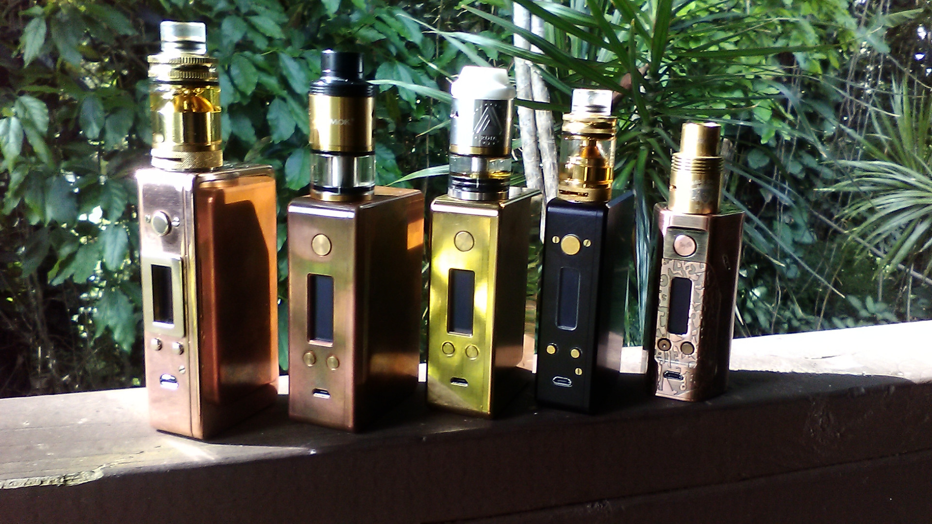

These new brass and copper dna kits from Dripp3d are the easiest and the prettiest pre-cut boxes on the market. 29.7mm wide P+ style box. I also made a purple anodized aluminium one for a friend but the color bled like crazy and the 510 on their aluminum box isn't centered, the copper and brass are. Also, while the screen is centered, the buttons are just a hair off center, barely noticeable, but if this triggers your OCD, like me, you can't un-see it. Anyway, still the best looking thing I've seen for a glu-n-go DIY. about $20-30 bucks more than an Alpinetech kit. it can take a big atty, I put a 1300mah nano-tech, fits perfect with xt30 connector and a board mounted jst. I really wish these companies would stop using these 3d printed mounts and just make the box with #0-80 holes for proper standoffs, maintenence on a glued box is a pain in the ass, and glue sucks. At least make the 3d one a 3 piece mount so the center portion with the screen doesnt get glued in too and can be removed with the rest of the board without removing the mount. If i make another one, I am cutting the mount in thirds, or drilling holes for standoffs- which can go horribly wrong. I do like the all flat, easy to polish, minimalist design that the screw-less look offers. Edit- I am 99% sure that the 2000mah maxamps can fit in here with a very well planned wriring job. Very tight fit, but looks like its possible.

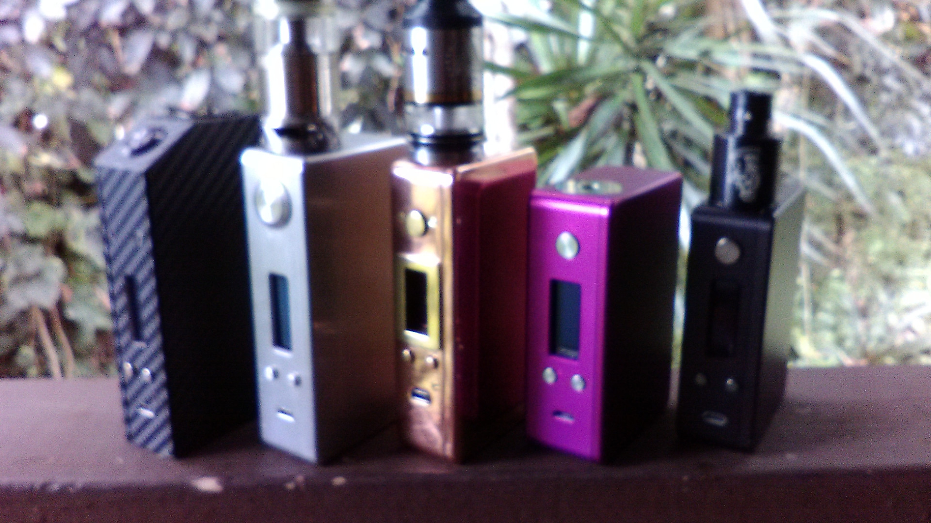

I have eyed my moonshot box 100 times thinking of this, but with a maxamps 1800. Very nice sir! Here are some of my babies,

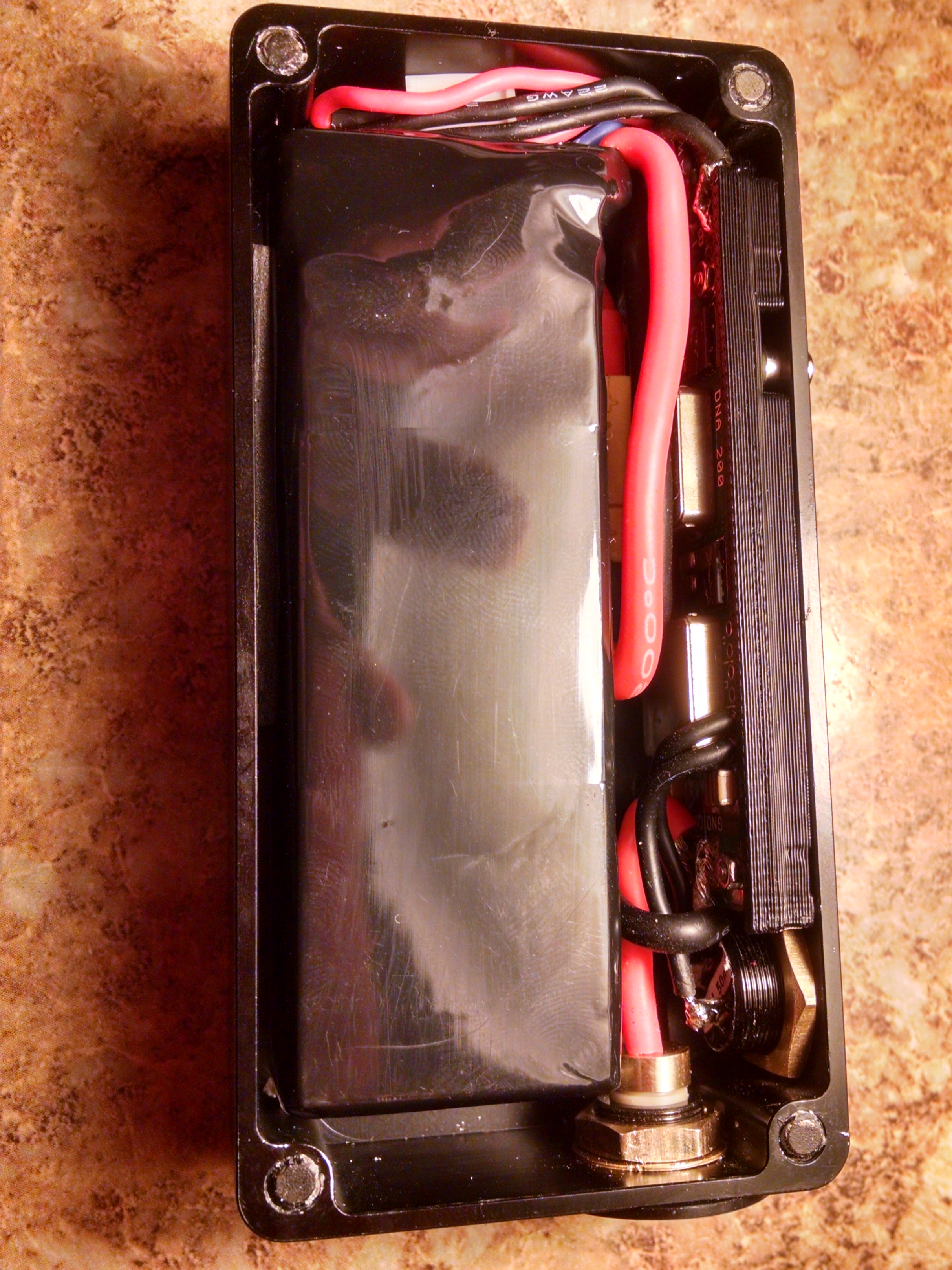

This is the fourth mod I built and I like it the least. Alpine G+ precut DNA200 type 2 box. The button hole was set too close to the corner so I had to file the nut down on one side, the board mount is described as able to remove chip if needed, but thats not true because the screws will just spin and since its designed to be glued in your not getting it out, plus the screen is not coming out and the space is far too small to re mount the ribbon. their boxes are made for grub screws, but they sell you magnets that dont fit. I contacted these guys three times before the listing came up on ebay, i was pretty much ignored then my order came and it was missing 3/4 of my items, when I let them know I was missing items they just sent a new shipping number... not a word otherwise. So after about 2 weeks I finally got all my things I dont know if they are too busy or what but I am going to avoid doing business with them in the future. This is a venom 1300 35c btw, it fits perfect in this with a velcro strip on bottom to secure the battery, but it fits in a standard 1590g as is it were made for it. been using this battery for about a month now and its shown no signs of puffing or flexing, still hard as the day I got it and I get a true 1300 mah. Luckily this box is sold already and I dont have to think about it anymore. Unfortunately I bought a gold box just like it but I am going to drill some board mount holes in the face so I can use some proper brass standoffs, these plastic board mounts just make everything feel kinda cheap, and I hate glue.

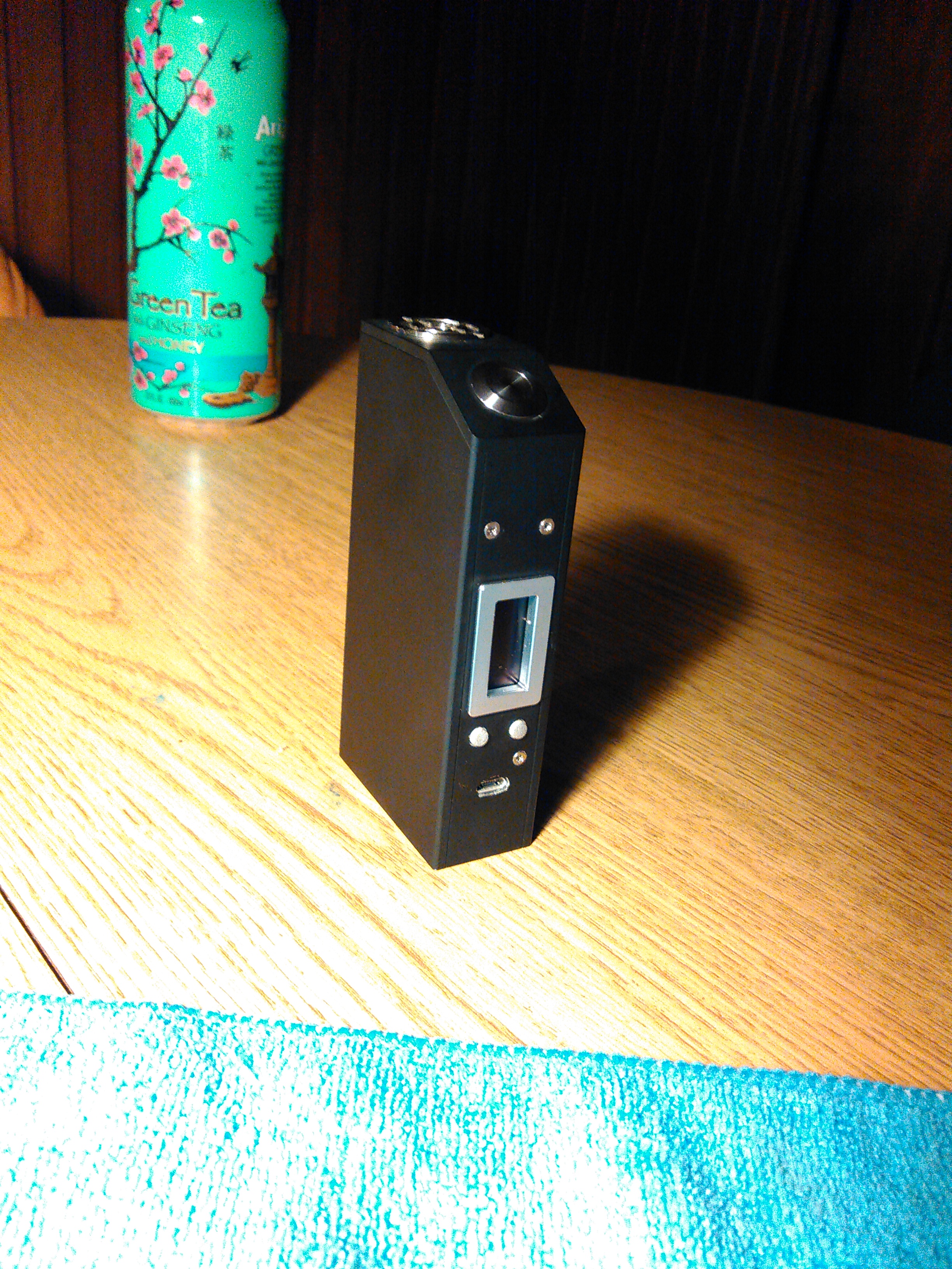

And this is James Dean. James is a FDV "Big G" enclosure...hadn't seen anybody use one of these yet. Sliding door with a spring-loaded lock on the bottom, no screws or magnets needed. Very liteweight. No glue or epoxy used on my project unless its superglue on a magnet.

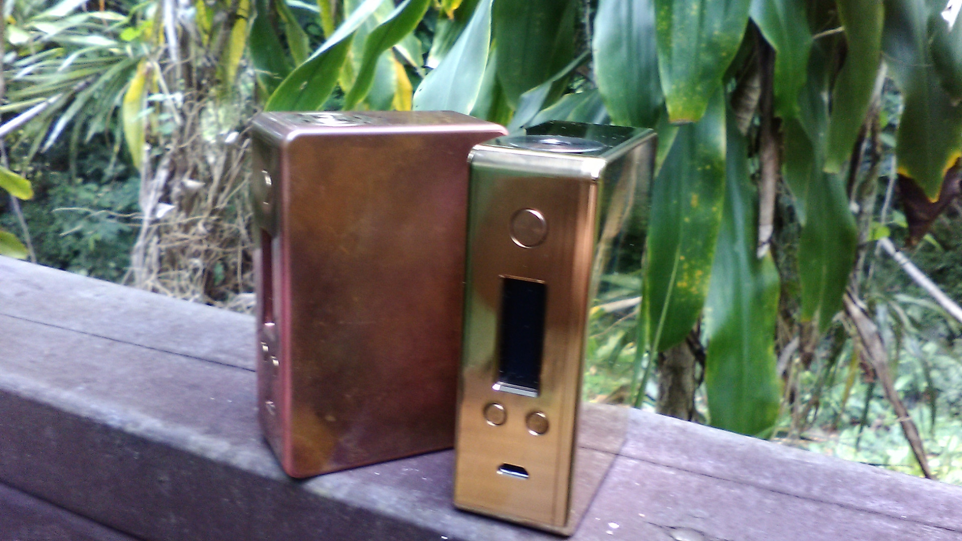

This is Betty White, Betty is solid copper 1590g from Dripp3d with brass bezel. Gold-steel 3d buttons from mamu, FDV v4 shorty low-pro copper, also brass standoffs and brass screws with brass nuts(wink), and a turnigy "1250(long)" Battery is changeable.
