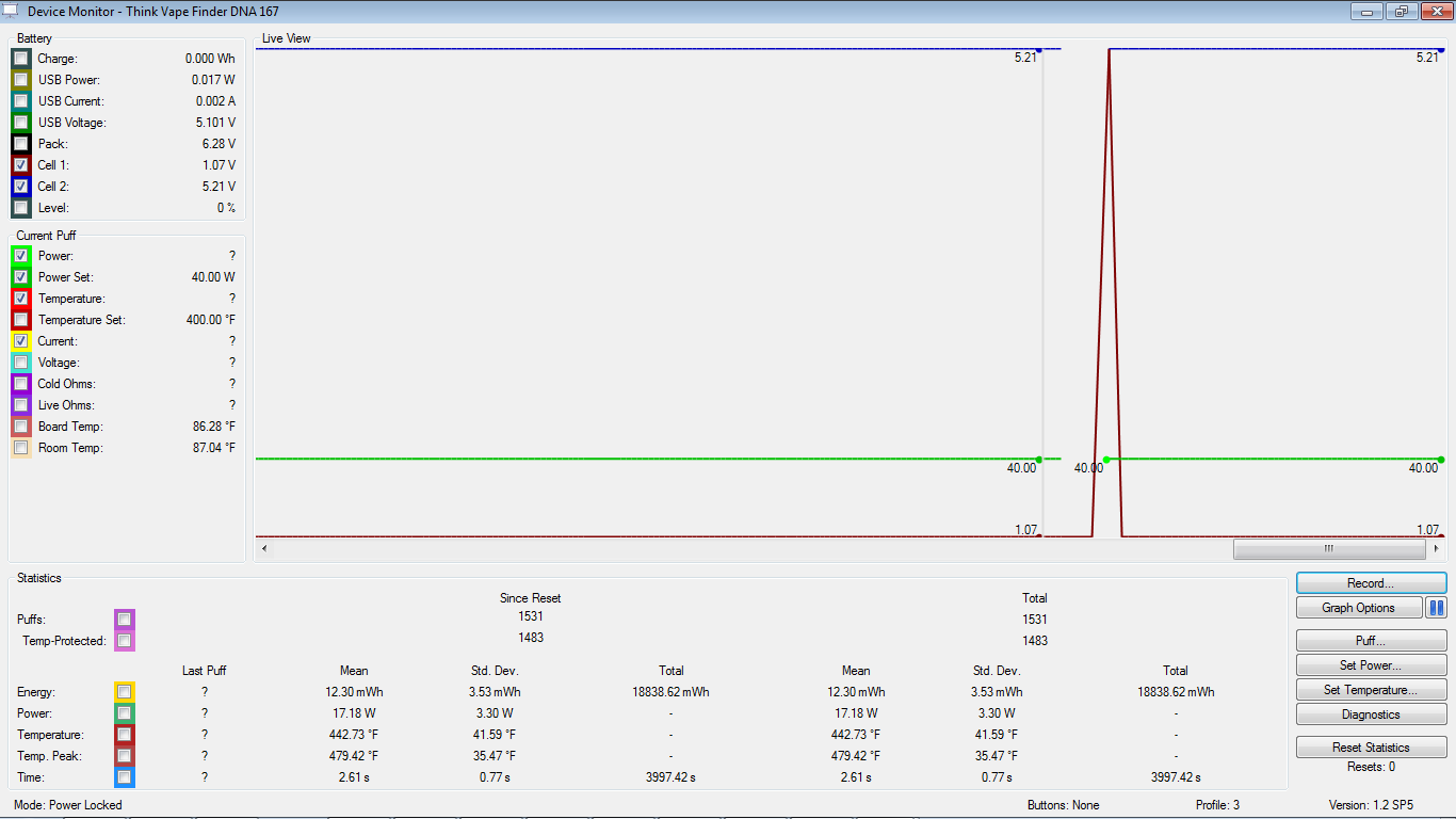

  8. Hi, I have a problem with my Think Vape Finder 167 bought a few weeks ago. All of a sudden the battery icon does not show any charge and when I press the fire button I get a "check battery" message. The two 18650 are Sony VTC6 freshly bought and fully charged. I tried another two but with no avail. I tried also hard and soft reboot and I uploaded the original ecig file. All with no success. I performed USB recovery charging, and from device monitor I can see that the voltage of first cell is read 1,07V and the second 5,20V. Here is a screenshot of dev monitor. Any help would be appreciated
