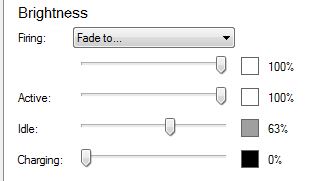

  1. Sorry for the delayed reply... I guess mine is also still failing to go into standby. The screen goes off due to the settings as attached pic, but 7 times out of 10 when I come back to the mod after an hour or two it still come up with the fire screen, not the return from standby. Interesting because I have three other DNA75's here, two of which I built myself with bare 75 boards and I have not observed this behaviour with them. It seems only the Vapedroid C1D2 does this, or I have not noticed it so far on the others.
  2. Hi all Just got the Vapedroid C1D2 DNA75 last week. I downloaded the Vapedroid config from their Facebook page and applied it. My C1D2 then started to behave erratically, with the screen turning itself off and on at random and at other times never going off. So yesterday I downloaded and installed the current recommended Escribe 2016-05-02, and then hard reset the C1D2 and saved the Escribe default config back to it, wiping all of the customisations. I then reset all of my materials profiles etc manually and did not go anywhere near the Vapedroid configs. I did manually set the mod/thermal/case properties as per the Vapedroid settings though. The C1D2 immediately started to behave as a proper DNA75 (I have a couple of others so know what to expect) and it no longer behaves erratically. I can only conclude at this moment that there is something out of place in the Vapedroid config that causes the strange behaviour. Hope that helps,
