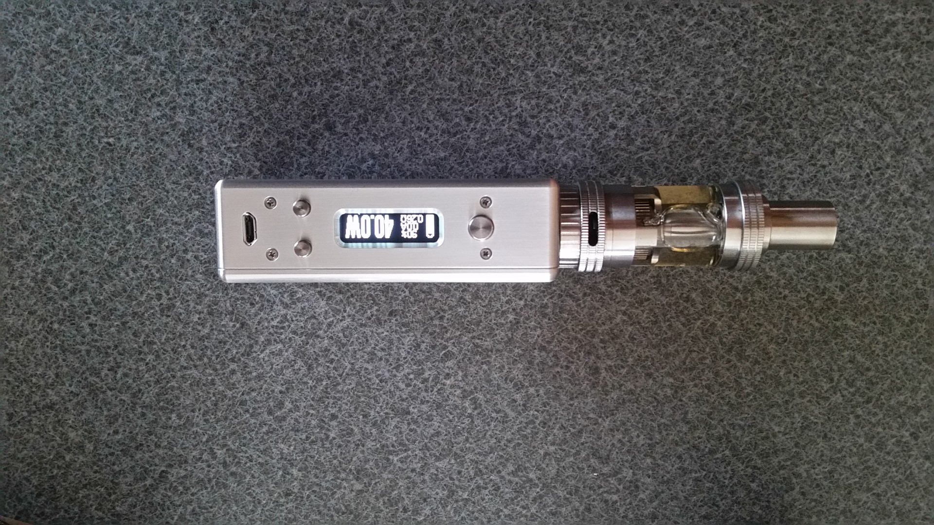

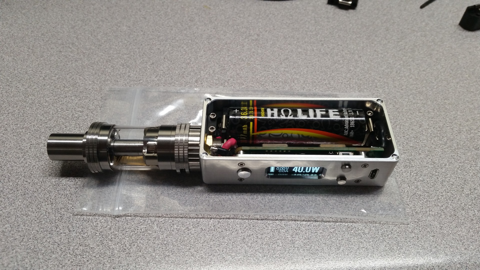

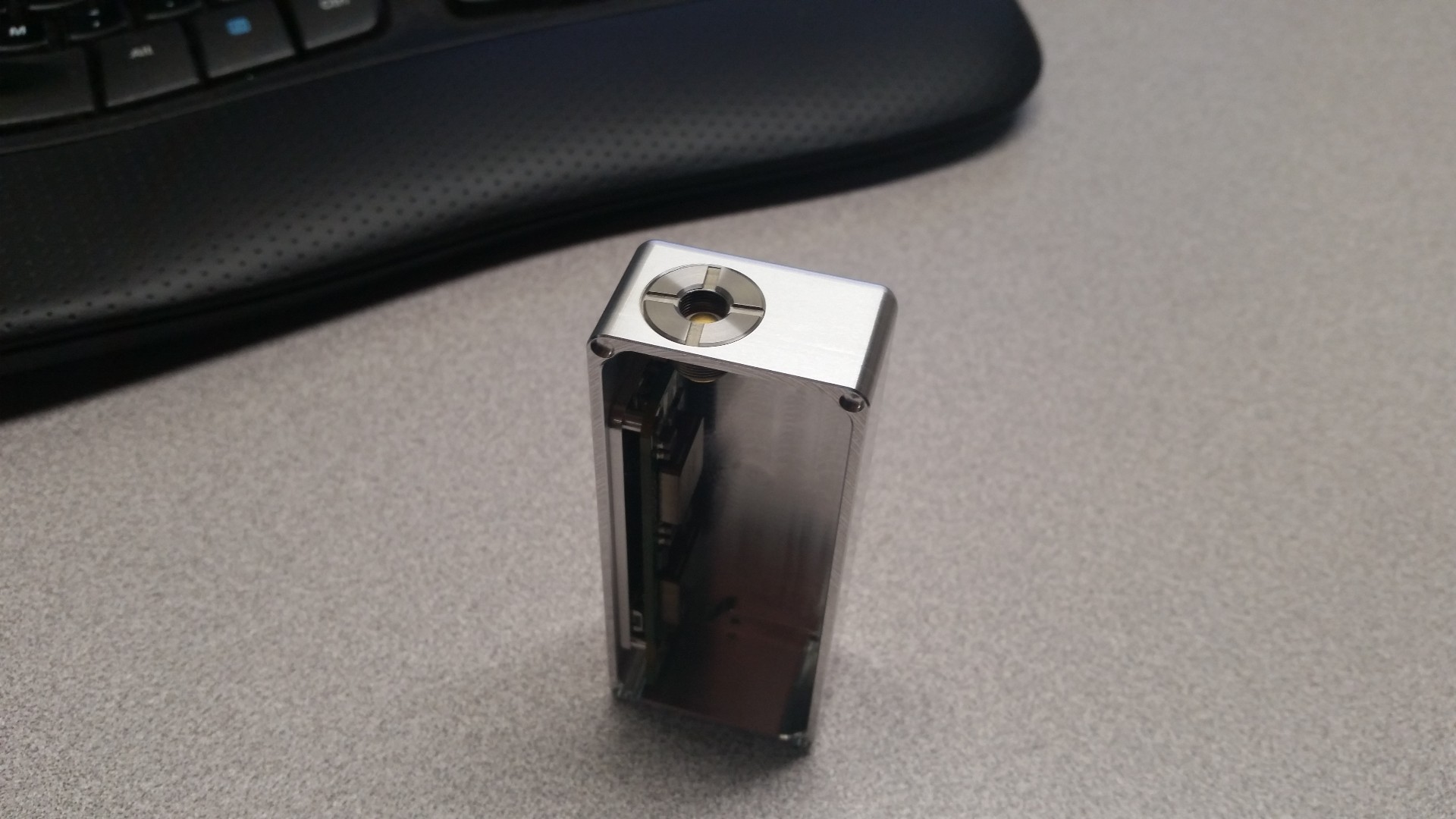

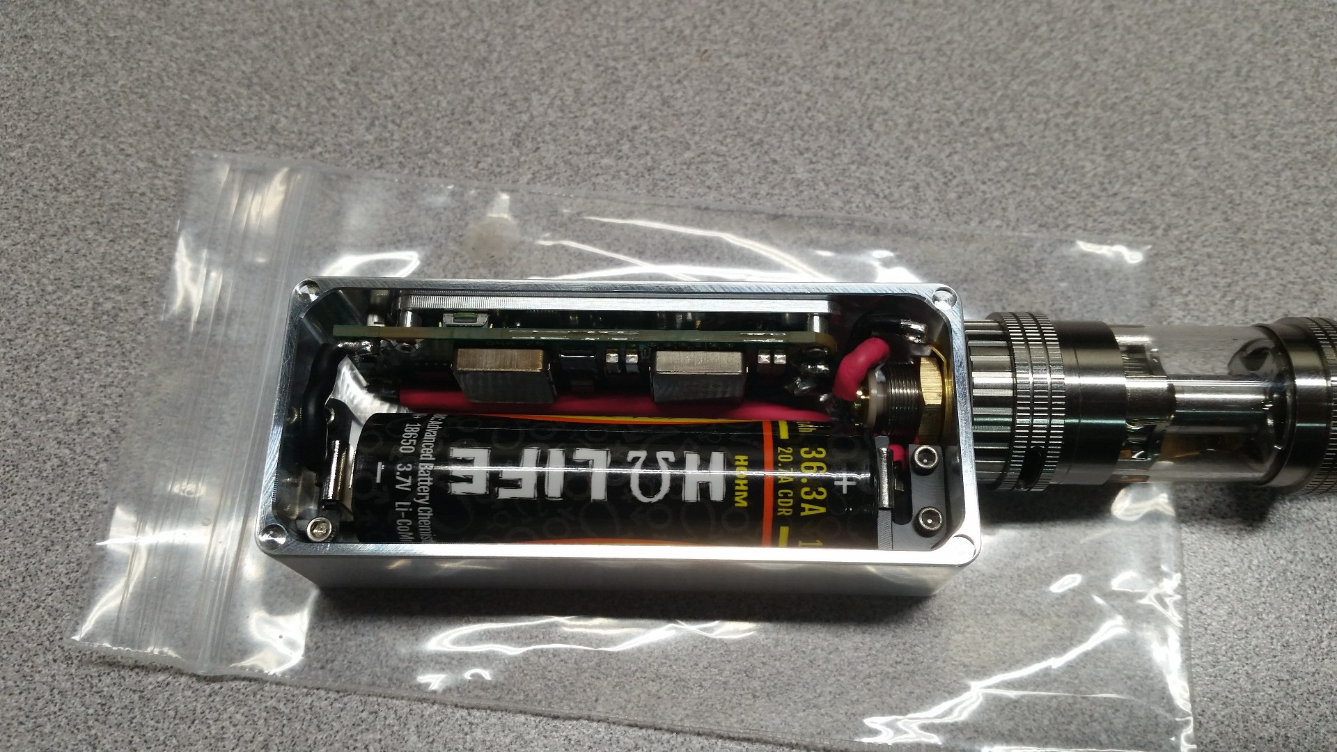

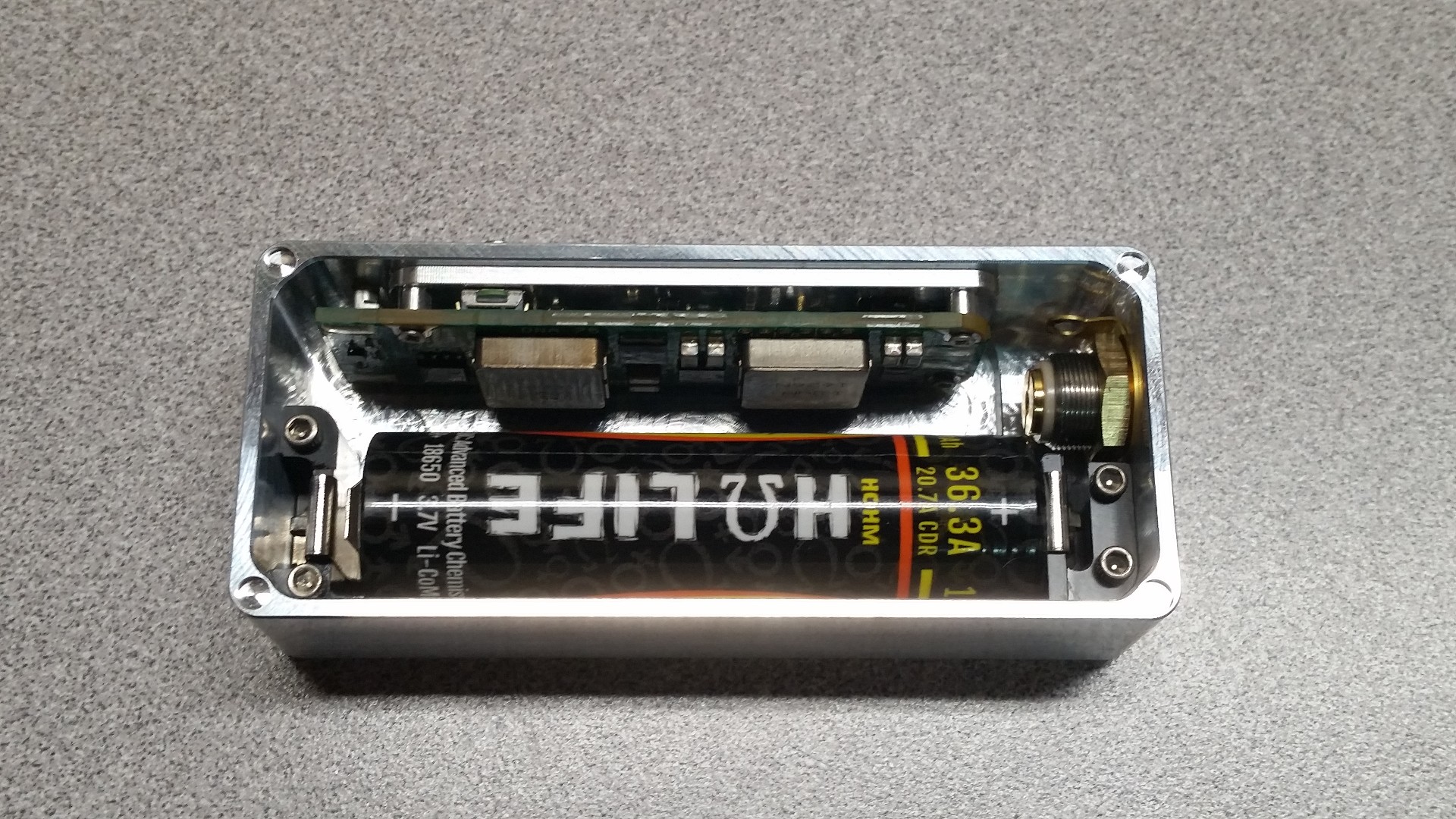

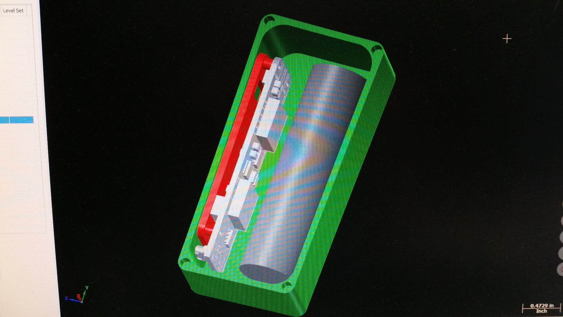

  1. Very cool John la! I love that color!
