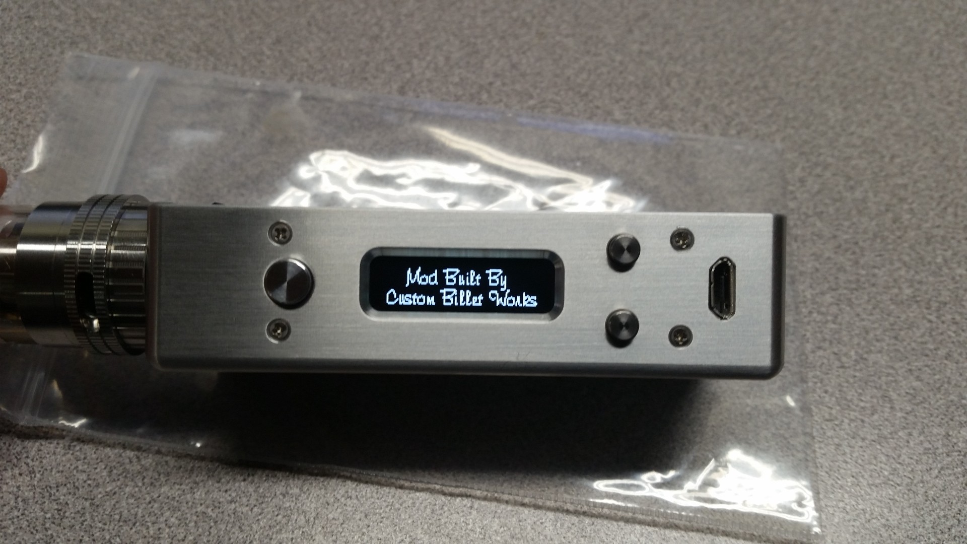

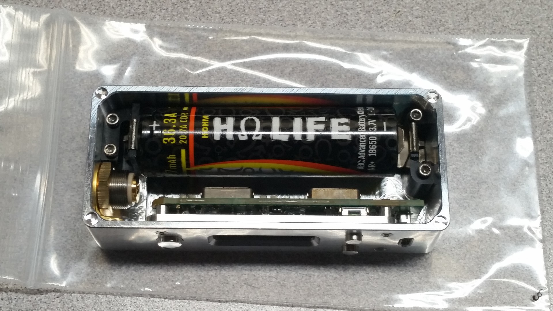

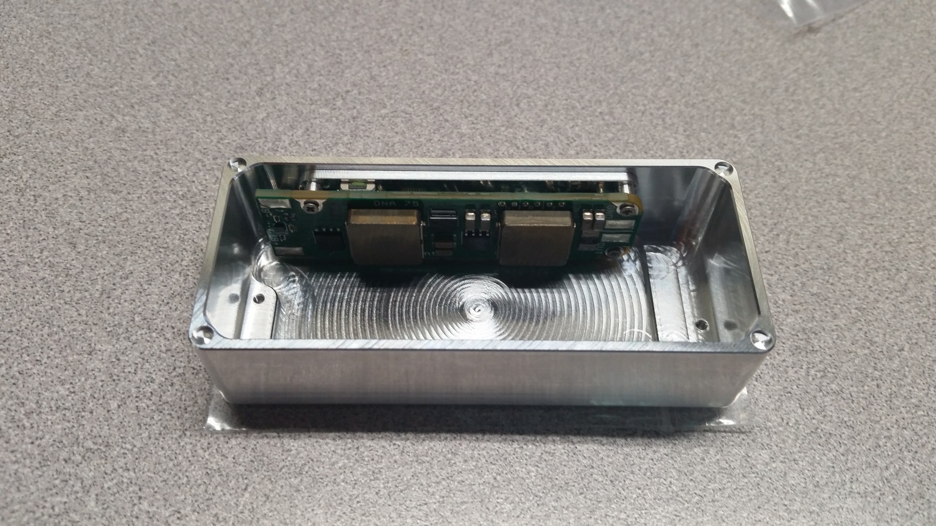

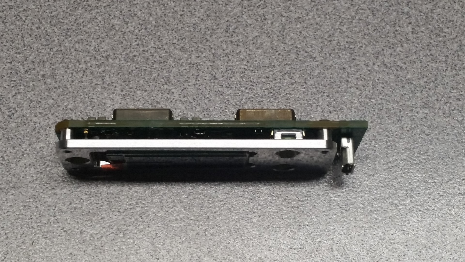

  4. Long time lurker, first post! Here is what happens when a machinist decides to build a mod! This is my first build. First, I didn't like the 3D printed board/screen holder. It was very warped and there was no way to properly mount it. So I made a billet one. Then I went to work designing the box as small as I could. Here is the first mock up. Then machined for the 510. I turned down a Varitube V2. I didn't like any of the battery sleds that I found. None of them had a proper way to mount other than glue. I was set on everything being bolted together. I machined Delrin battery insulators that would work with standard battery clips that are readily available. Got it all wired up! Magnetic battery cover. The box in machine out of 6061 billet aluminum with a light brushed finish. Then I machined the buttons out of 7075. I left them with a machined finish to they would stand out more.
