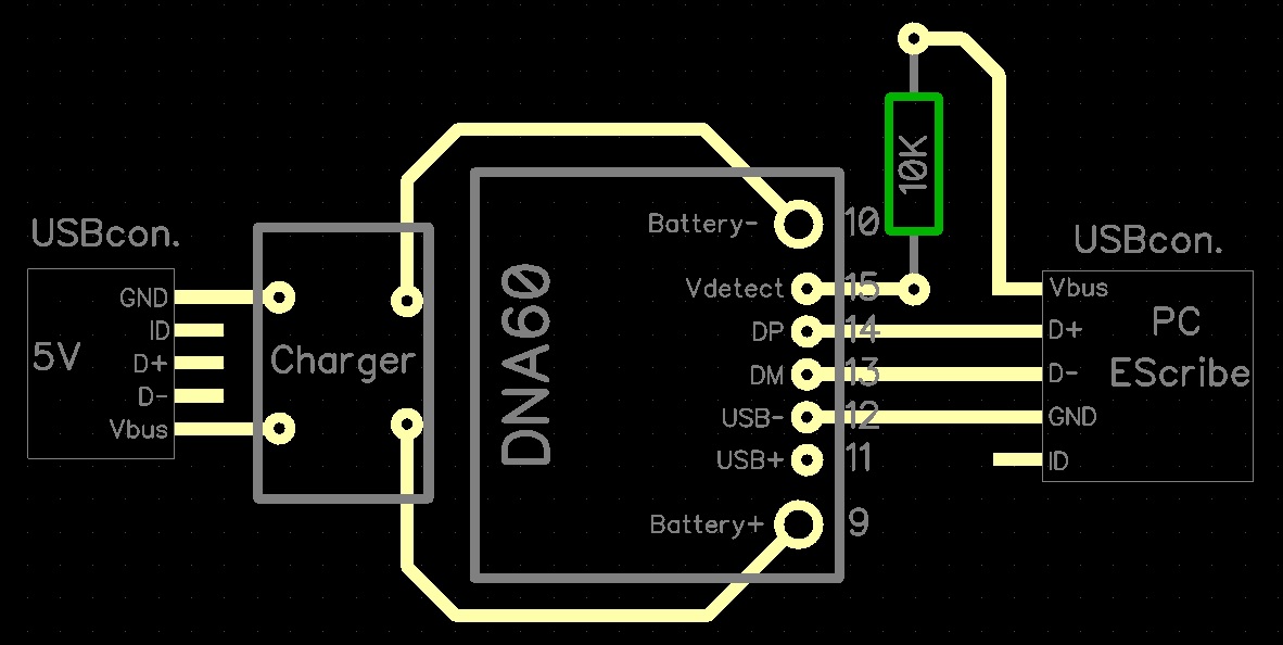

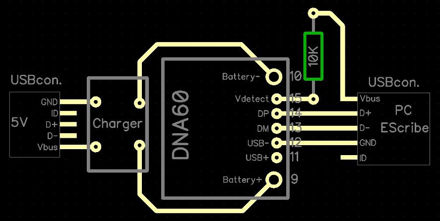

    @ChunkyButt200 Nice job! The resistor is from Vcc (+5V) of the USB connector?
  3. The 8 weeks I was waiting for the small screen have passed. Every morning I start my day at the post office. I decided to plug 2 microUSB connectors, for not charging the battery every time I use EScribe. I read the manual and after a lot of thinking, I came out with this: Can anyone confirm?
