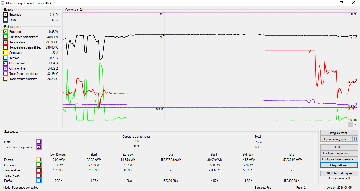

Ok It seem that it was the screws on the build deck that wasn't tight enough. It doesn't show the message 'OFF' anymore but I still have the message saying 'Temperature protected' when it is cleary not heating at all. Here is a screenshot of the monitoring. EDIT: Now it work (but still show ~100°C when it is clearly at 200°C) and sometime it doesn't work (the message 'Temperature protected'). I really don't understand what happened, could it be my atty?

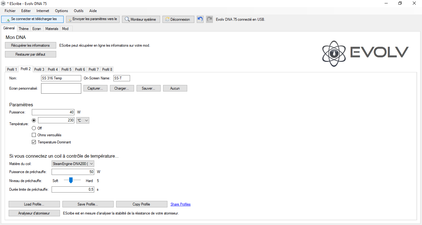

Hey, I tried what you ask (removing my atty, let it cool down, then select 'New coil' but it still show 'OFF' when I fire. Here is a screenshot of my profile

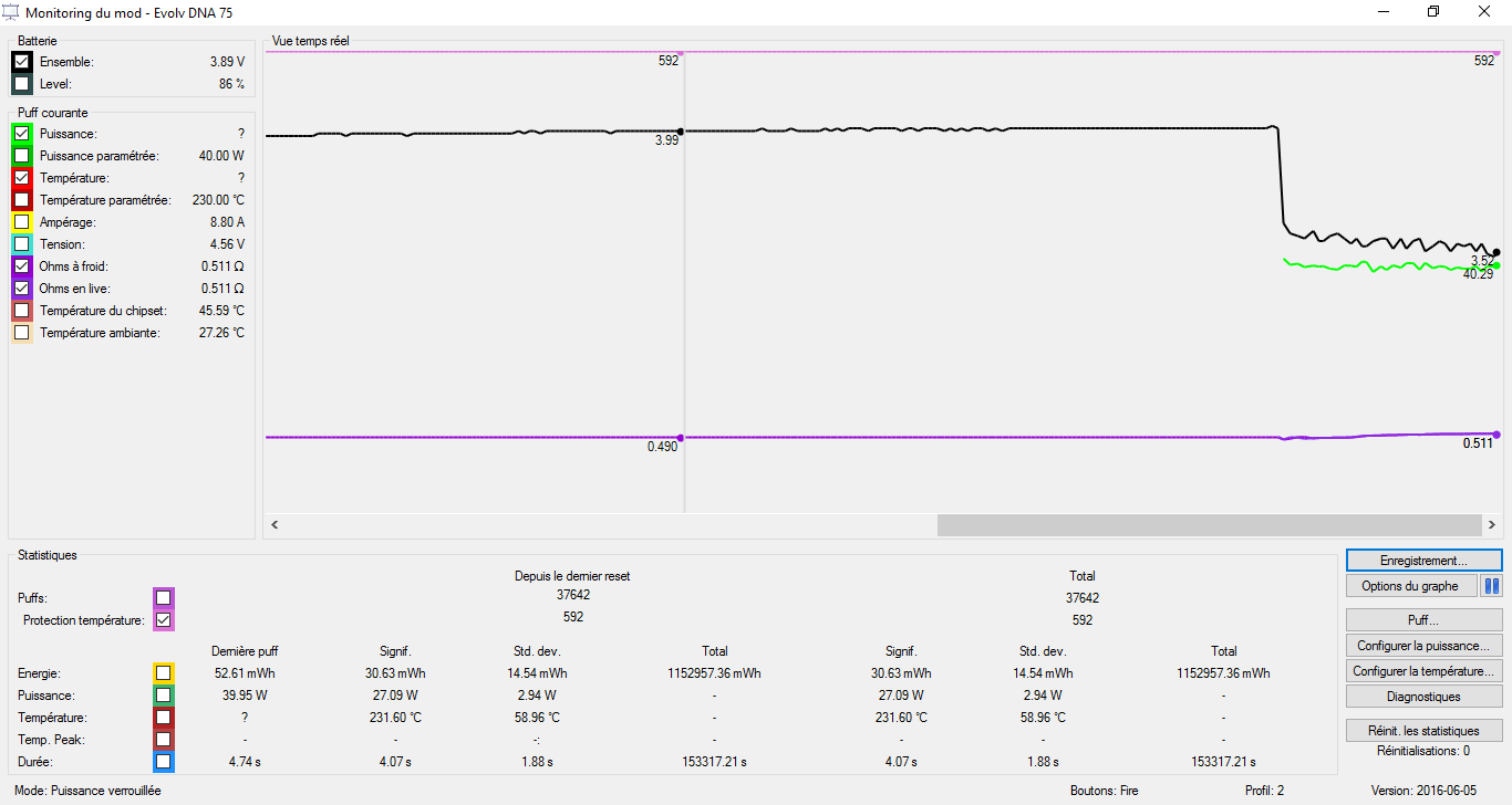

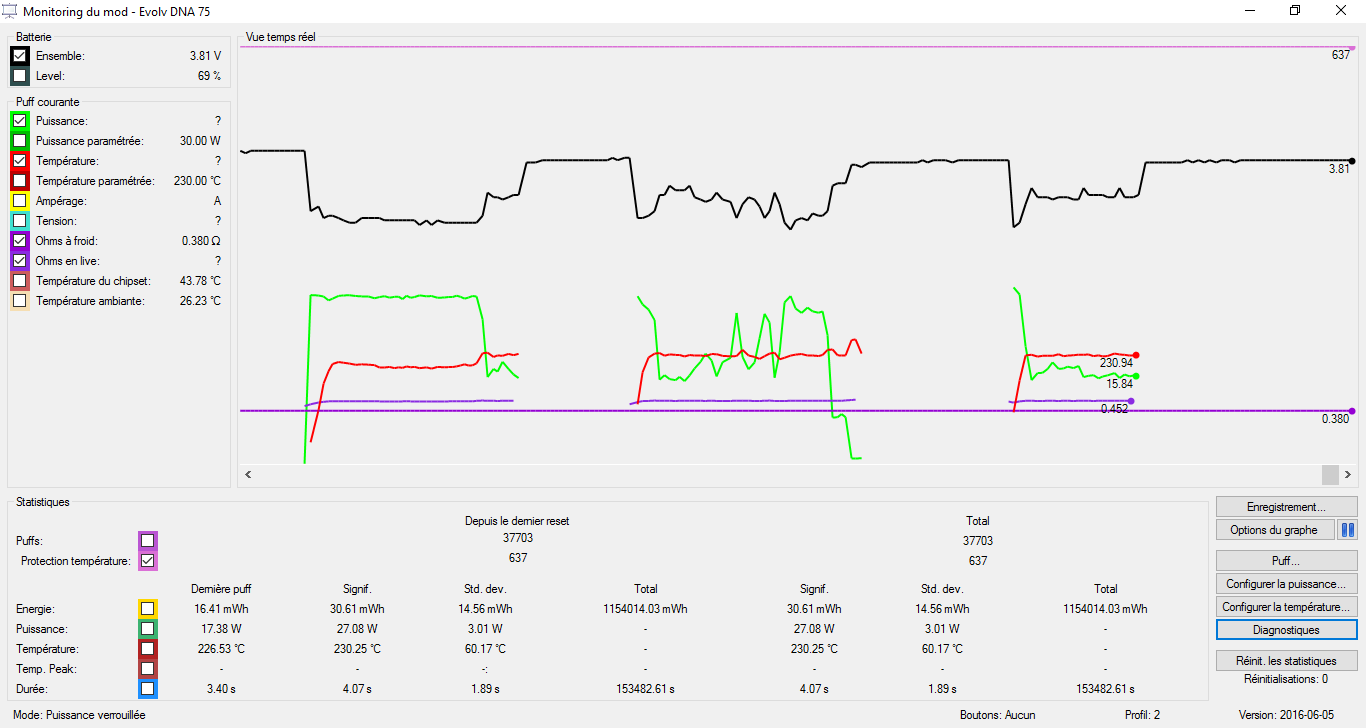

Thanks for the quick replys, I tried to change to 40w and 50w for preheat but now it seem that it disable the TC, I got a message saying "OFF" on the screen of my lavabox. My resistance is now at 0.62, I don't understand why it jumped from 0.46 to 0.51 to 0.62

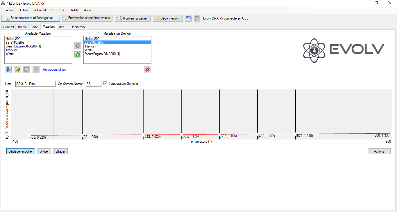

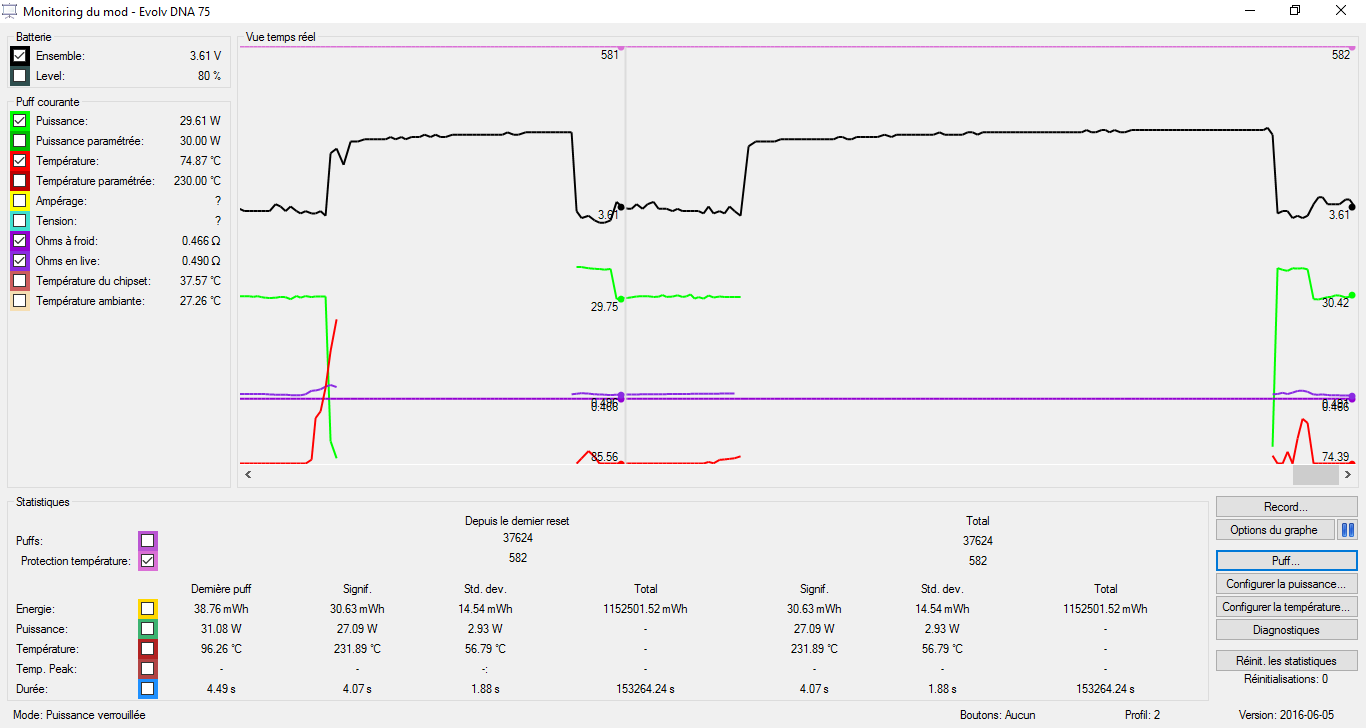

Hello, I got some issues with my LAVABOX 75. My temperature never hit 230°C. It is stuck at ~100°C. It seems that my resistance is never stable too. My atomizer is a Mage with a dual coil SS316L. Sometime I got a message saying "Temperature protected" but the coil is not even heating so I got no smoke at all. Can someone help me please? Here's some screenshot of the profile and materials I use. I tried the 2 SS316L profils and I got the issue with both of them. Thanks in advance! (sorry for my English, this is not my native language)
