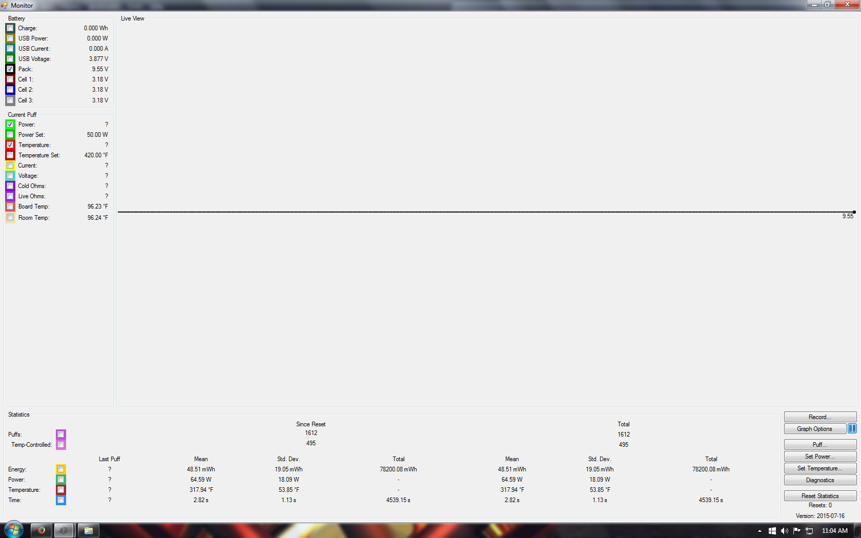

I've had my 200 working great for a few weeks now and the other day had a strange thing happen. I went to hit it Ni200 @ 50watts and it went super hot then shut down. When I say hot I mean couldn't hold the cap on my royal hunter.
Well the screen wouldn't turn on after that and it didn't show up in the software. After removing the board I found the fuse had blown so I followed another post and used a 25amp automotive fuse. It now turns on!!! I thought "great it works!!" Well I noticed the battery shows empty???? I checked the battery with my meter and it shows 11.4. Ok grabbed another battery and plugged it in....empty?!? Well I decided to see if it charged. No go. Something strange is going on here? Is it RMA time?
Also this board was ordered on the release day so it's an early one.
