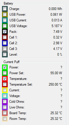

  2. Hello, I pushed battery against positive nobs, contact there seems to be weak point of design, however doesn't help. I checked voltage by multi-meter and voltage is there (tight probes on sides of battery nob). What I noticed is that it smells like burned piece of PCB, didn't wanted opened it and check for burned spots on PCB (it is still in warranty). Anyhow already contacted seller and he is trying to solve this, so will see, if they provide fault description will add it here. Anyway thanks that you tried :), Peter
  3. Hello Gents, I bought Lost Vape Triade 250, I'm not able to switch it on. Till hold down fire button I'm getting Lost Vape logo and then battery check (batteries Samsung 25R), brand new & fully charged (checked also via multi-meter all of them ~4.2V). When connected via USB, shows that batteries are completely flat, via EScribe I'm getting weird cell measurement on all 3 cells (pic below). Do you know what can be problem? Thanks a lot
