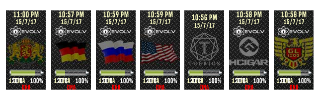

The theme of VapingBad is the basis theme - here are changed icons and there are extra features ..
Copy from VapingBad
In the photos the 1st is when preheat is on, 2nd is preheat off, 3rd is dropped out of temp protection. 4th is TP-enabled=false, 5th is TS-Material=false.

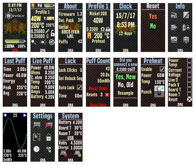

This is how the conditions are set:
The TP icon:
default shows on image,
atty\temp-protect-enabled=false as the condition for showing the off image.
atty\temp-sensing-material=false also for showing the off image.
Text status:
default shows "PH" for preheat
atty\preheat-enabled=false shows "---"
atty\temp-protect-enabled=false shows "PWR" in yellow
atty\temp-sensing-material=false shows "PWR"in yellow
atty\temp-sensing-dectect=false shows "???" in orange (tested with an ss coil using a NI profile)
Temp Field:
atty\temp as default
atty\temp-protect-enabled=false shows diag\atty\voltage
atty\temp-sensing-material=false shows diag\atty\voltage
Extras:
In Lock Screen down: Current in charge or root temperature in non charging mode.
In Main Screen two resistans: locked ohms and life ohms.
In Main Screen right to Power:  temperature of board or output voltage in VW mode.
In Main Screen right to Temperature: Temperature ot last puff
