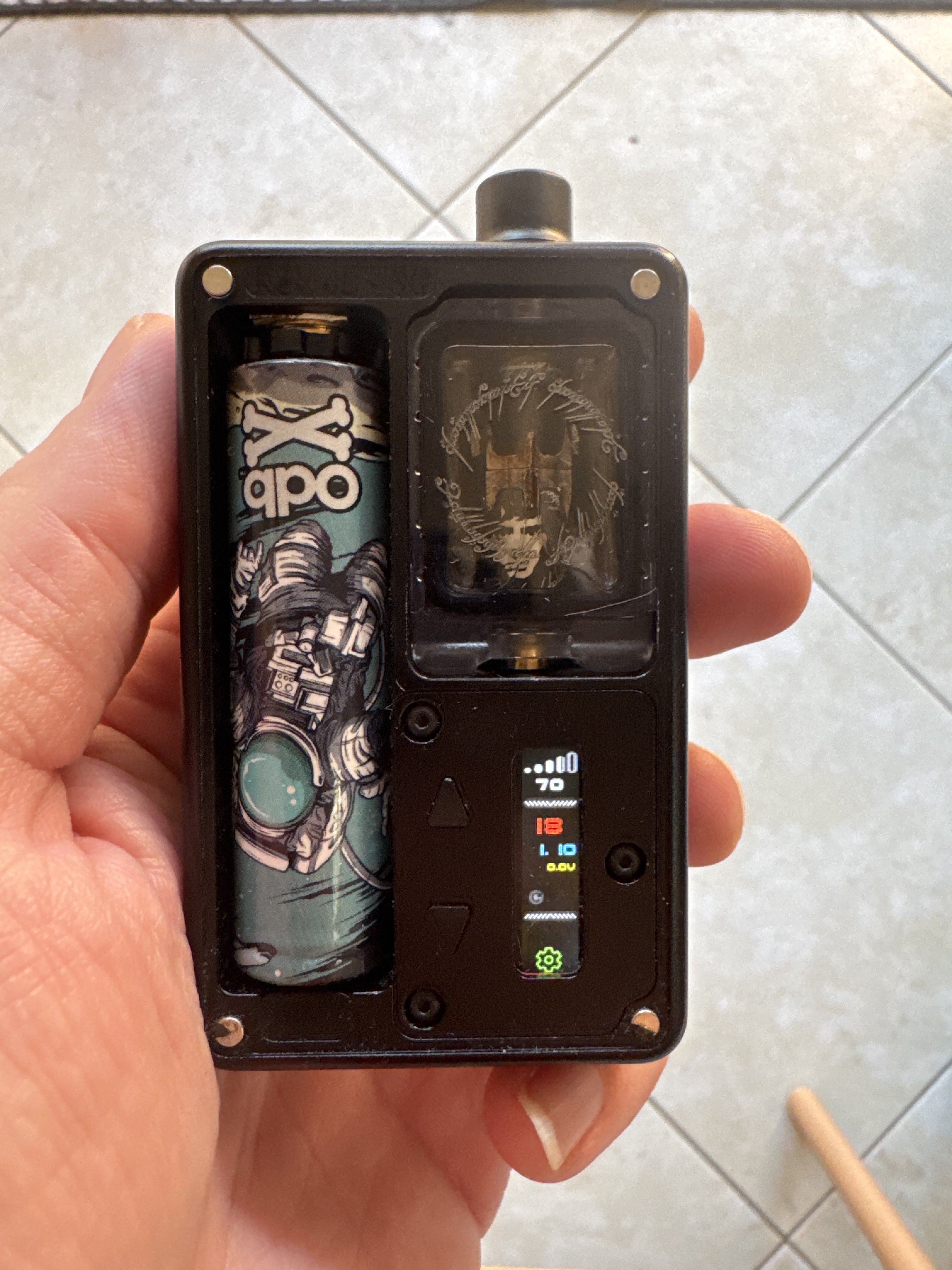

Dcvlt Posted May 11, 2025 Report Posted May 11, 2025 This is a straight fit as far as I experienced, only thing to watch out for is the screen “display area” is just a bit narrower than the dna60, so you have to make sure it’s lined up properly not to look wonky here’s my retrofitted BB - been running it as a daily for month now 4 1

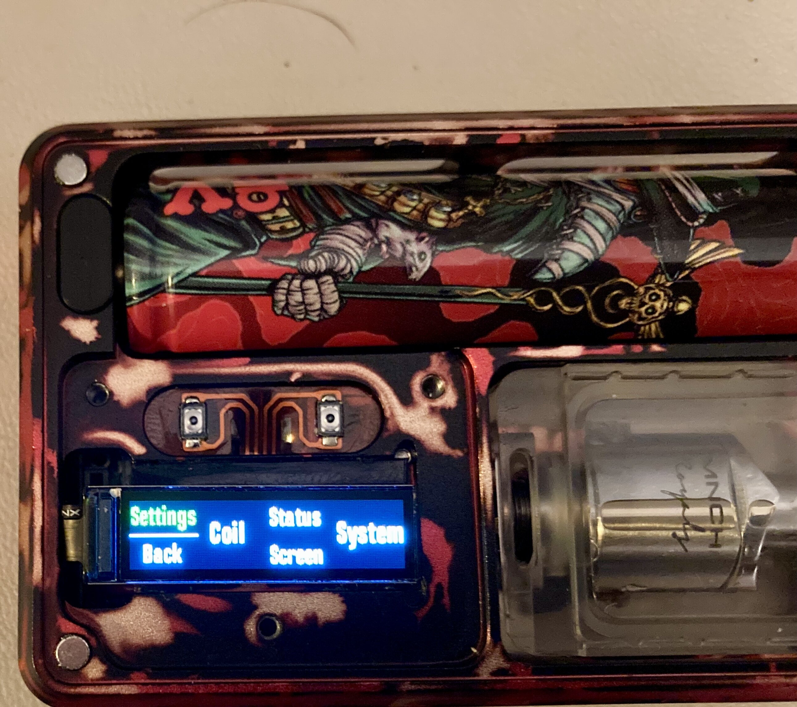

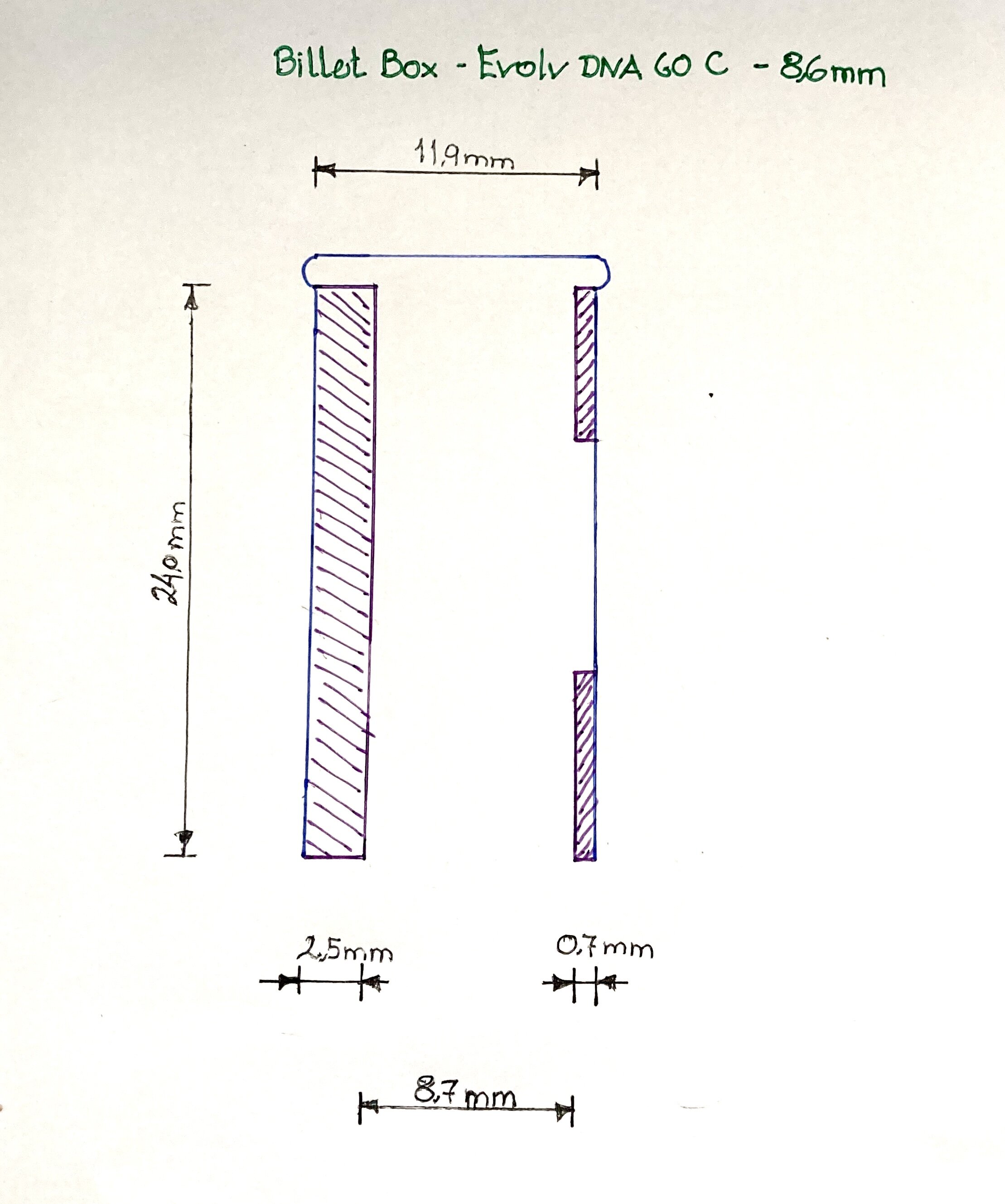

TorR Posted October 24, 2025 Report Posted October 24, 2025 The only difference is the screen, it is narrower on the DNA60C. Easily solved by making some thin plastic strips, equal in width to the screen difference. I used two different strips so that I also centered the screen.
