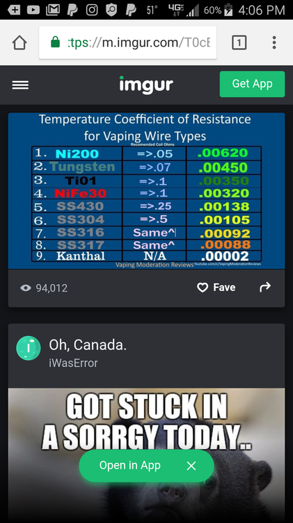

The_Vape_Weasel Posted June 17, 2017 Report Posted June 17, 2017 Hmm that's odd...as long as you got your material set to SS316 that shouldn't happen. I was worried as I got 26g UD SS316L wire that it wouldn't vape right since mod don't have 316L just 316 but I haven't been having any problems. Found this chart with coefficient but don't list SS316L so not sure what difference between them is but it's been giving me best TC experience I've had with any mod and didn't have to adjust any TCR settings like I have with my old Smok H-Priv for example. You running newest service pack? I'm thinking it's 6/5, I'd have to look and not by my laptop at moment
