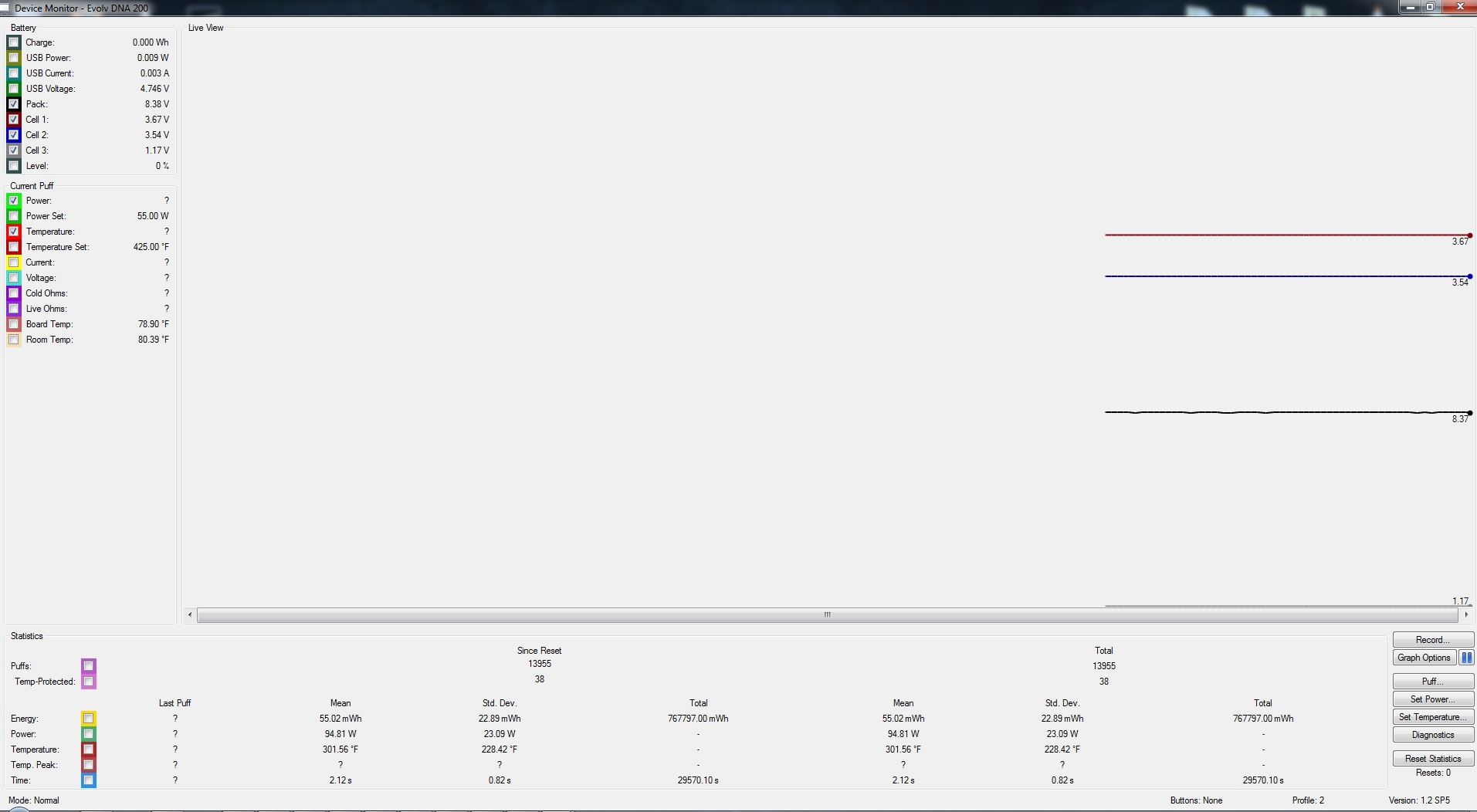

So I've been through multiple threads on various boards regarding this issue and they have all asked for screengrabs of my device onitor (hence a new thread).
I've already got a horrible feeling that it may be a hardware failure i.e Juice or something. Cell 3 is completely out of whack with the others. The odd thing is when I plug it into a usb 3 port on my pc the screen wasn't displaying my "charging" options. I've since done a factory reset.
I did run a usb recovery but I have zero idea how long you're supposed to leave it. After an hour and a half nothing had changed.
This is the most up to date screenshot.
Thanks in advance
