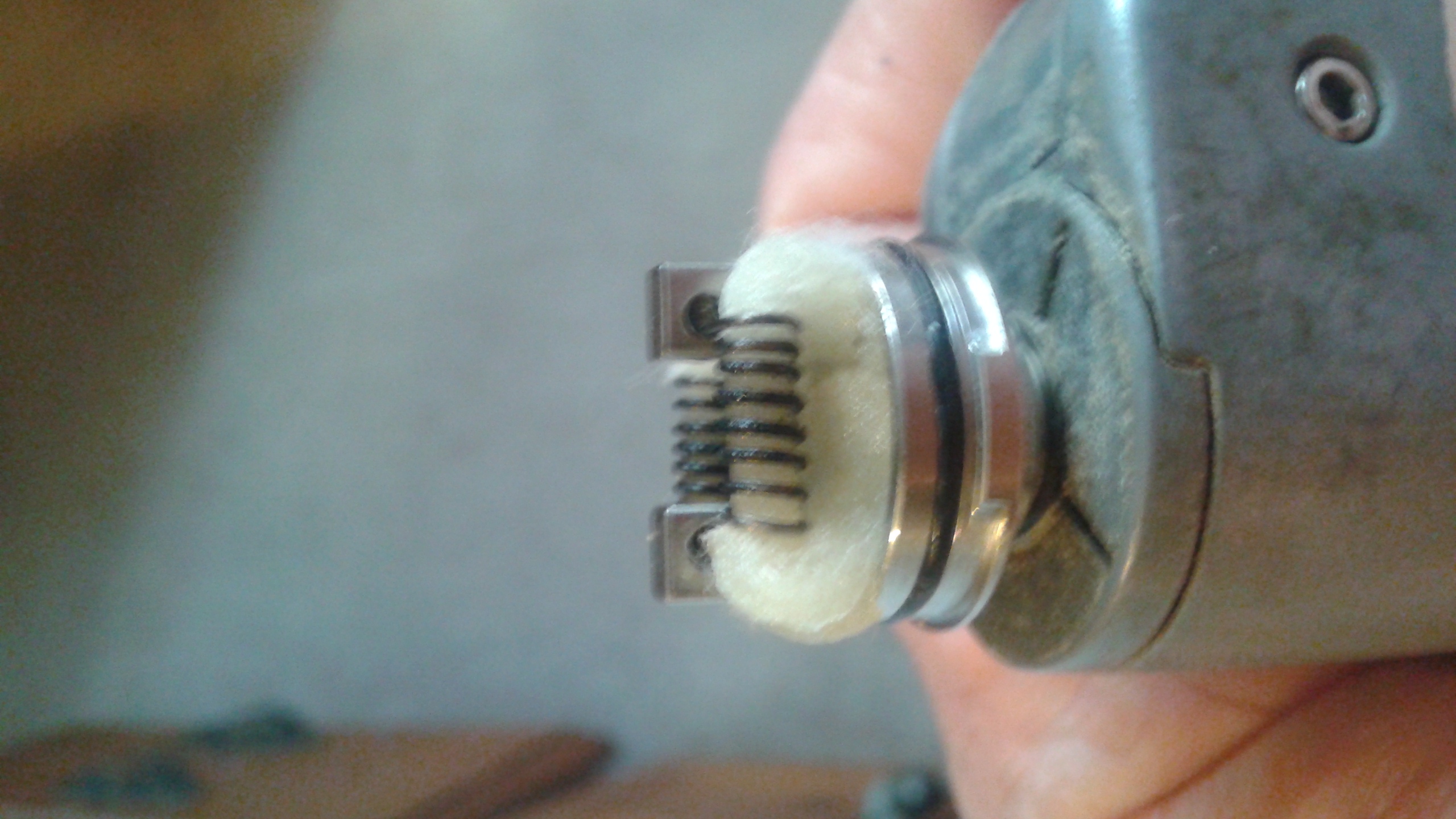

Hi guys (and gals ) i thought id share a problem iv been having give you all a laugh or maybe some help
Iv been building 8-10 rap Ti A1 duel coils to run in temp mode ..mixed results allow it seemed to work well it didn't seem right so i kept doing things like running with safety off to get higher temps and burning the coils which is a unpresentable taste at best
So i popped in here and was reading about Ti profiles ..i was using the Ti profile that came with the device , so wondering if this was "off " a bit i headed over to steam to get custom files to run in Ti mode
same results
The in a moment of clarity the mistake came to me ...i had been using the default file and indeed custom files for single wire ..but duel coil is in fact a parallel build. Id been thinking of parallel coils as 2 wires in one coil which indeed it is but its also 2 single wire coils in the same deck
Re worked the new profile for Ti in parallel and bingo the DNA 200 temp control came to life :D
loving it
Iv built it in a Smok V8 of which i have 2 the other one running clapton duels and i have to say the temp controlled V8 knocks the spots on the clapton version no spitting or hot draws flavor is better vape is denser and cooler witch suits me .........only problem now is i want more DNA 200 mods :D
biuld was ..
Ti A1
8-9 raps
3.5mm dia
legs about .5-1m long
came out at 0.24 ohms for both
i had played with 3mm die raps but i wanted more wire and more cotton in this one :)
Thanks for reading i know it was a long one but  i was so exited i had to tell some one lmao
