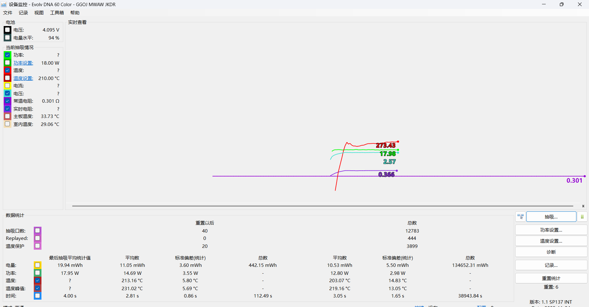

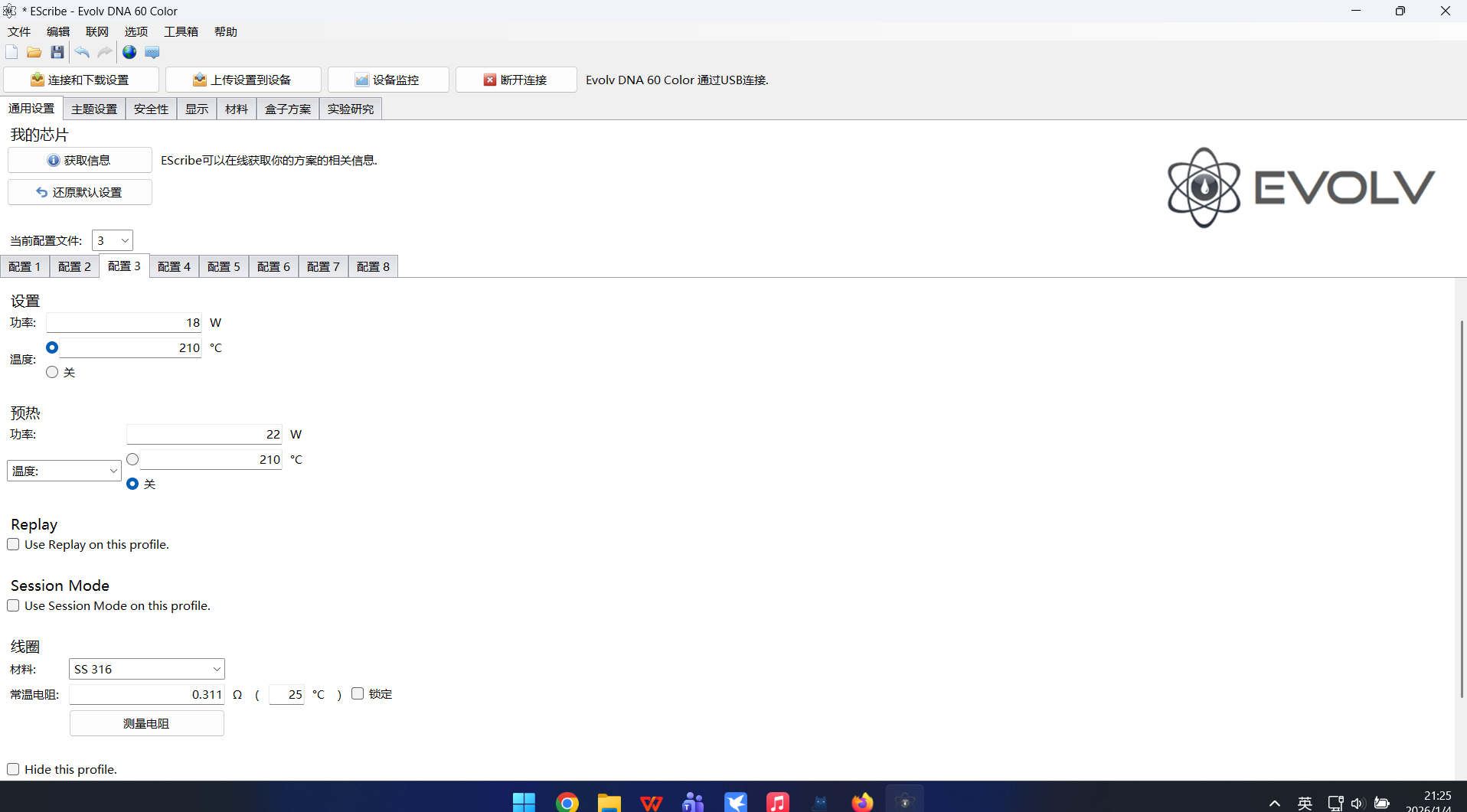

  3. This is the data from my default configuration file, with a cold resistance of 0.296. According to TCR reverse calculation, the resistance when heated to 210 degrees is 0.346, which is perfect. However, just like the video I posted, it hardly produces smoke. So what's going on here? It's confusing
  4. Do you think it's a chip malfunction, but all its other functions are still intact 你认为是芯片故障,但它的其他功能仍然完好

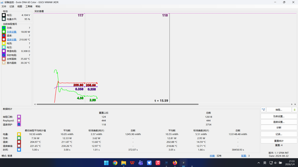

  5. This is the data when I use the default configuration file

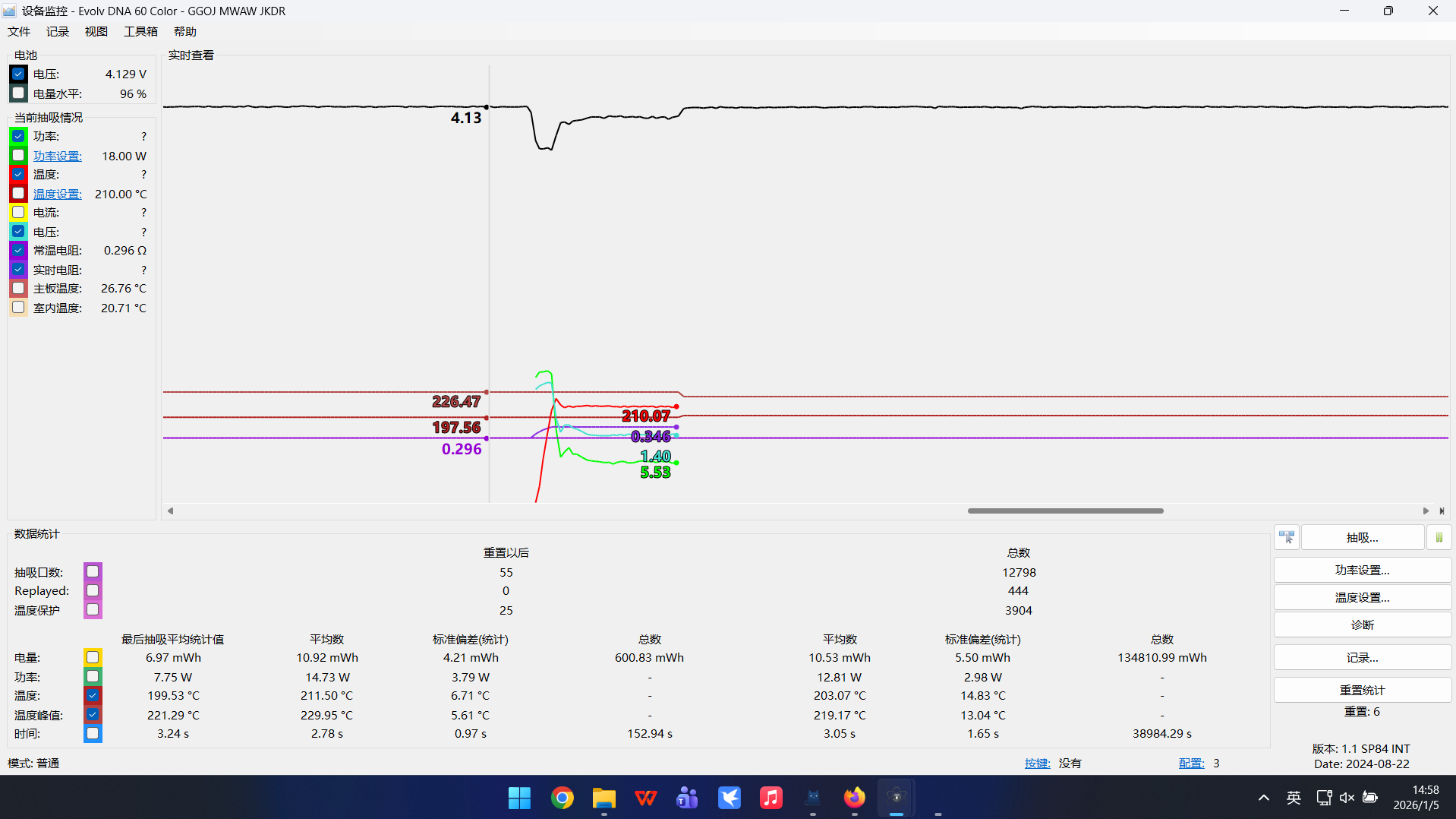

  6. Sorry I didn't take it seriously. The temperature I set was 210, but it actually reached 270

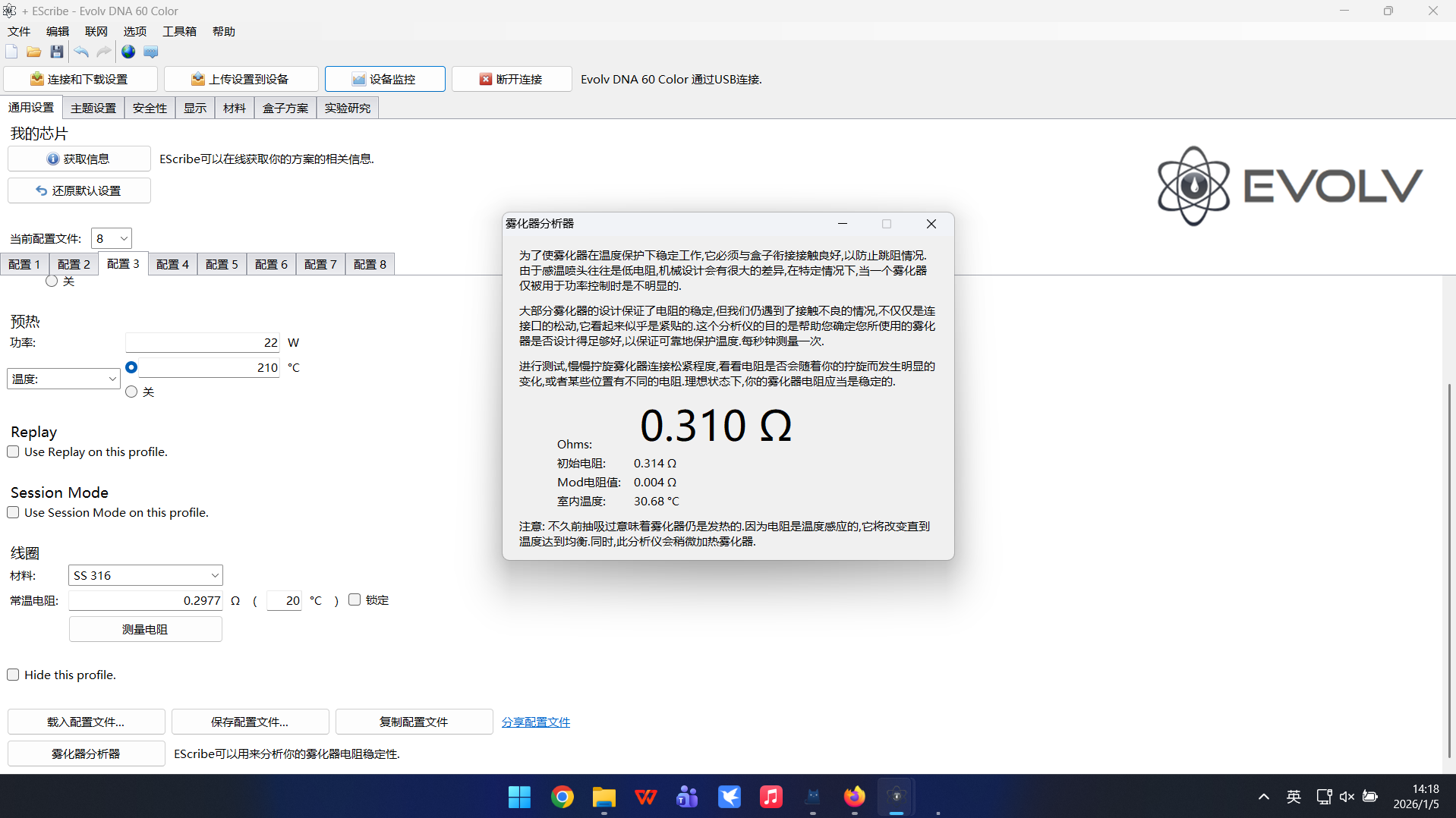

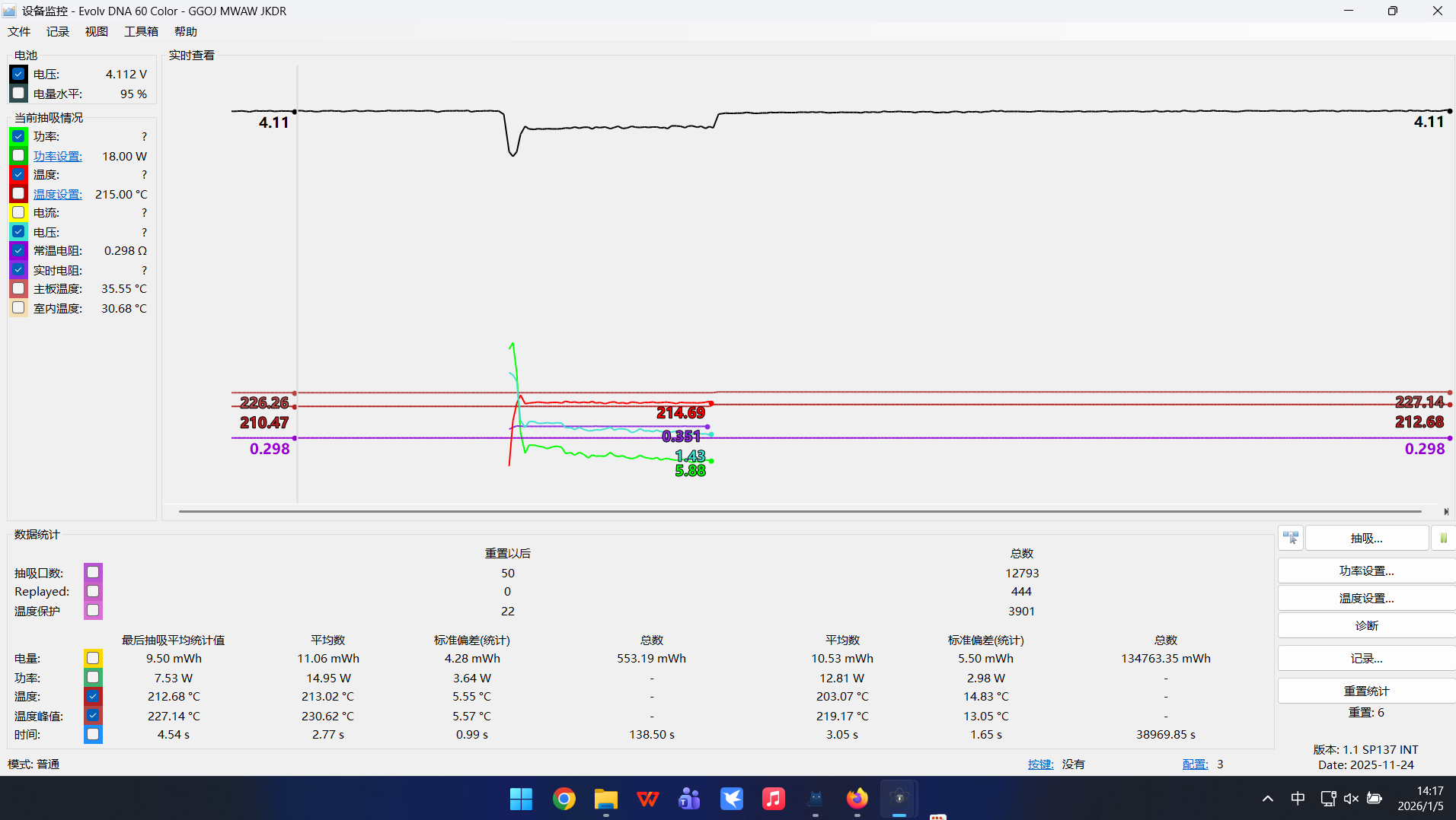

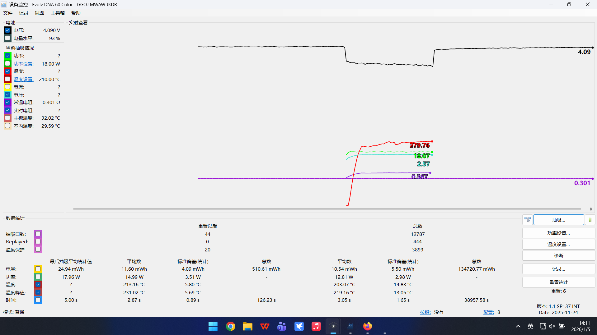

  7. First of all, I would like to thank you for your patient answer, but things seem to have improved. I have been using the default SS316 configuration file, but I am using SS316L coil. I downloaded a CSV configuration file of SS316L from the forum and used it, and the smoke generated seems to be normal. In theory, there shouldn't be such a big difference, after all, the TCR of these two materials is similar. This is my latest device monitor screenshot, and I am not sure if it is normal, but the smoke generated is indeed much higher. Also, it seems like I can't manually adjust the room temperature as it always shows a higher temperature

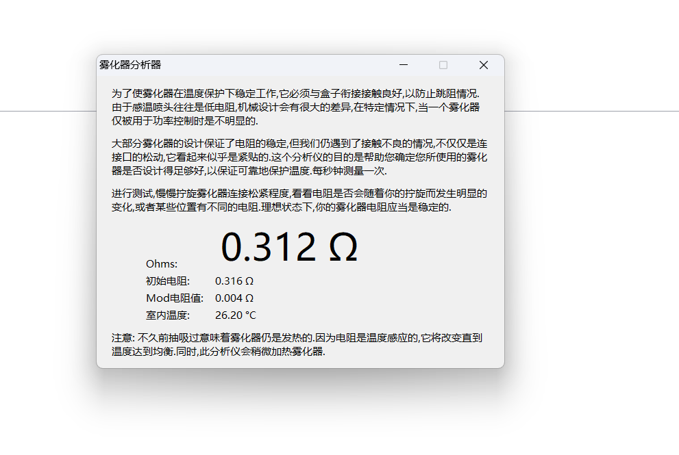

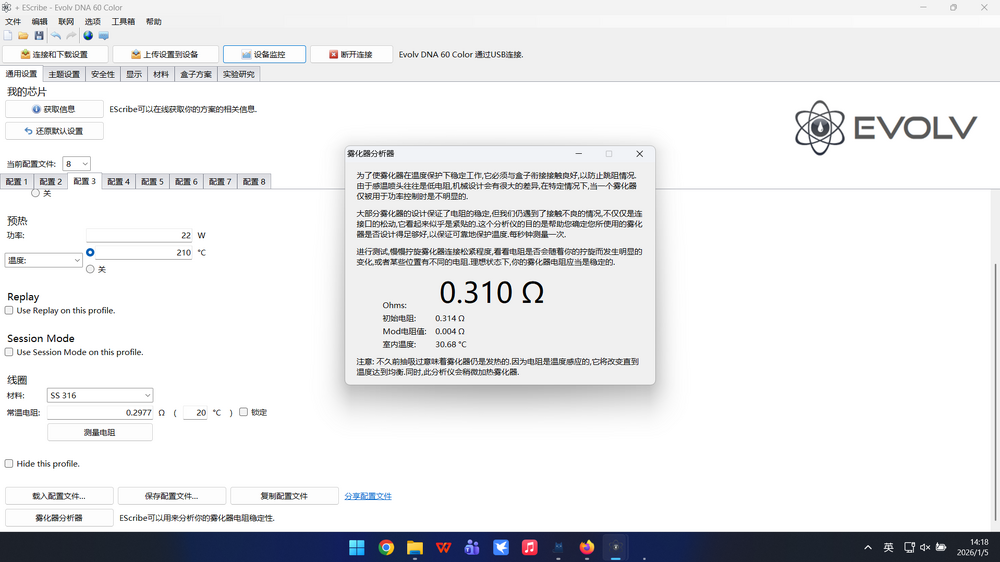

  10. It seems that there has been a serious mistake again. Just now, my coil cold pack was 0.3100. After taking a few puffs and showering, I re identified it as 0.2961, and there is no smoke again

  12. My cold ohm readings are almost the same on different devices, which means it's impossible for me to identify resistance abnormalities. Just now, I remade a coil, but after making this coil, I used the temperature control mode of 220 ° C dry burning to remove impurities (without cotton and juice), then reinstalled the cotton and juice and read the cold ohm. Miraculously, everything returned to normal, perhaps because WIREOPTIM's coil had impurities? I'm not sure if it's because of this, as I didn't perform dry burning operations before and occasionally everything worked fine, but most of the time there was no smoke. There is a fatal issue that when I do not perform dry burning operation, the DNA60c chip cannot perform temperature control normally (with a small amount of smoke or misjudgment of temperature), but it can still maintain normal temperature control on the YIHI SX730 chip. I cannot determine the real reason. Could you please advise me? Thank you, I come from China and use a translator. I hope you can understand,
