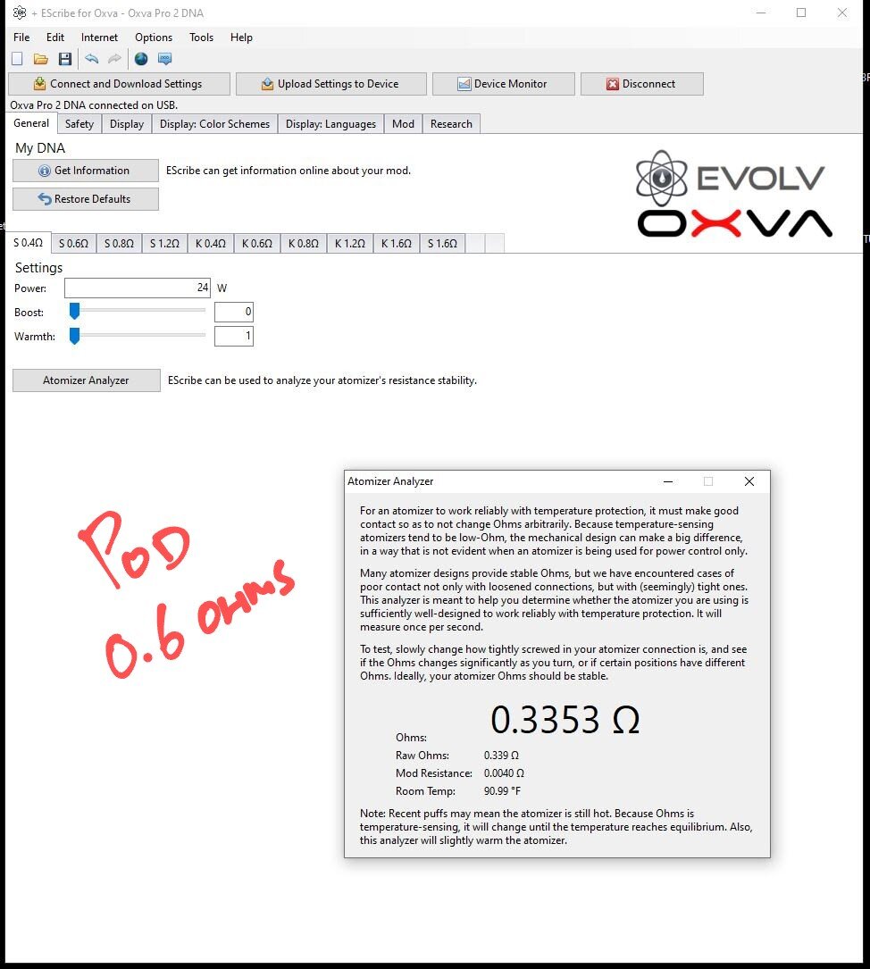

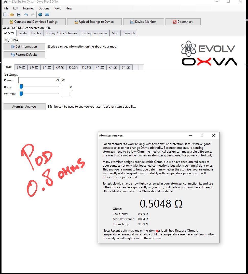

You mean the Live Ohm in the device monitor? My 0.8 pod goes from 0.5 to 0.62 when I vape. That also does not seem right -

Also, just curious. What resistance readings you get on the software for your pods? In my case, all my pods are supposed to be 0.6Ω and 0.8Ω, but they consistently read as 0.33Ω and 0.50Ω on the official software. -

Hi everyone, I'm a new owner of the XLIM Pro 2 DNA and I'm a bit confused about some of the behavior I'm seeing. I've done a lot of troubleshooting and I'm hoping someone can help me understand if my pods are faulty or if my device is. My main issue is that the anti-burn feature is not working correctly. I got a few dry hits on a pod that was nearly empty. After contacting my dealer, I got a replacement kit, but I'm still seeing some confusing behavior. Here are my findings from the Escribe Atomizer Analyzer: Original 0.6Ω pod: Reads 0.3396Ω Original 0.8Ω pod: Reads 0.5098Ω Replacement 0.6Ω pod: Reads 0.3364Ω Replacement 0.8Ω pod: Reads 0.5098Ω I have a few questions for the community: Are these resistance readings normal for the XLIM Pro 2 DNA pods? The numbers are far from the advertised values, but I saw in a different thread that this might be a designed characteristic. What is the correct behavior of the anti-burn feature? I'm getting dry hits, but the "Fill Pod" message only seems to appear after I remove and re-insert the pod. Should it be active and prevent a dry hit in real time? What does the "Anti-Burn" message with the orange flame icon on the display mean when you insert the pod, Its active or not? Any help would be greatly appreciated. I love the technology, but I'm struggling to get it to work correctly.
