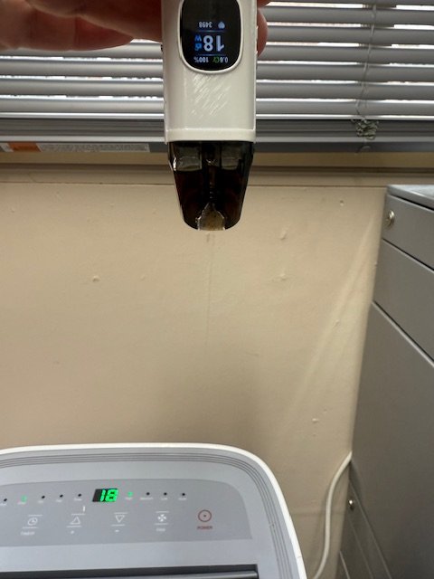

  1. Hi @James Bellinger Please find attached log files from eScribe Device Monitor. I have two mods, and two pods. One pod is 1 week old, and is the one that is struggling. Please note, there is no degradation in flavour on this pod, and other than the fill pod message, it is still going strong. On the other pod, this one is one day old and seems to be fine, although I do get the odd fill pod message. There also two photos. The one on the brown mod is the 1 day old coil and on the white mod is the 1 week old coil All files are named accordingly. I hope this helps. Many thanks in advance. Worst Mod - 1 Week Old Coil.csv Best Mod - 1 Day Old Coil.csv Best Mod - 1 Week Old Coil.csv Worst Mod - 1 Day Old Coil.csv
