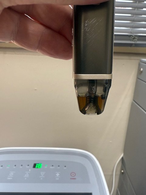

  1. Hi @James Bellinger Please find attached log files from eScribe Device Monitor. I have two mods, and two pods. One pod is 1 week old, and is the one that is struggling. Please note, there is no degradation in flavour on this pod, and other than the fill pod message, it is still going strong. On the other pod, this one is one day old and seems to be fine, although I do get the odd fill pod message. There also two photos. The one on the brown mod is the 1 day old coil and on the white mod is the 1 week old coil All files are named accordingly. I hope this helps. Many thanks in advance. Worst Mod - 1 Week Old Coil.csv Best Mod - 1 Day Old Coil.csv Best Mod - 1 Week Old Coil.csv Worst Mod - 1 Day Old Coil.csv

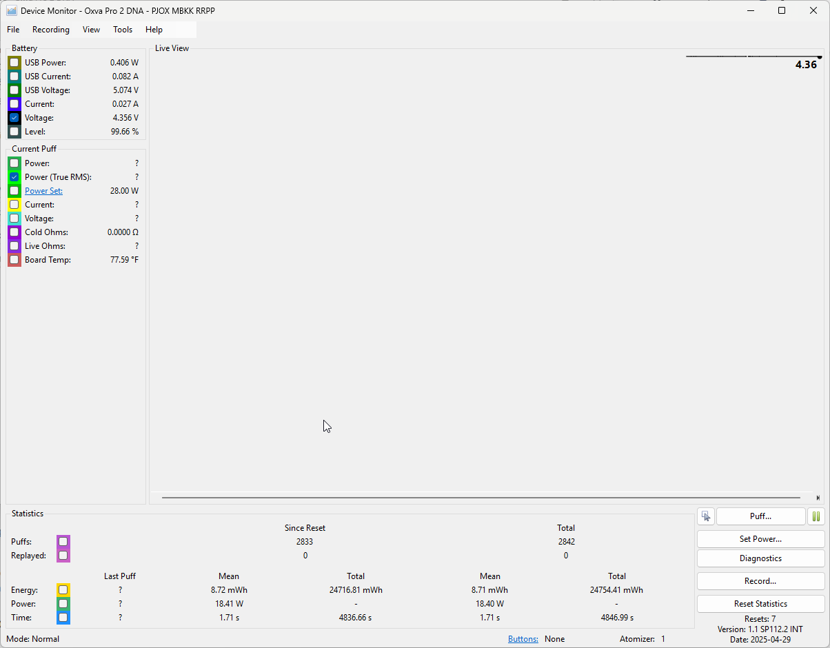

  2. @James Bellinger Thank you very much for the reply and apologies for my delayed reply. I have been up to my neck in DIY all weekend, under duress from my wife 🙂 Anyway, I will get on that today, thank you. Having done a bit more checking over the weekend, I am starting to agree with @franticseven in that it might be coil related rather than board. I check the resistance under Escribe late on Friday and for the current 8 ohm coil I am using, the resistance is showing as 0.5 ohms. It is still relatively new and not showing signs of degradation in terms of performance and flavour (when I can get it to fire) but just seems to have given up the ghost early. I maybe wrong, but once I have finished work today, I will report back later as requested. Thank you.

  4. Thanks for the prompt reply @Wayneo This is what I have at the moment
