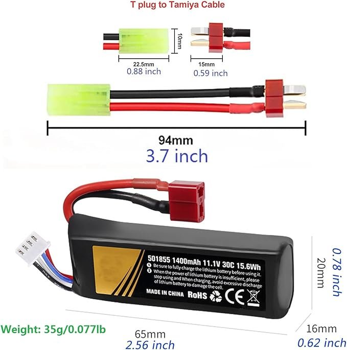

  3. Well, I didn't make it up, the 6-pin connector is what the DR200 is fitted with as standard. I could get a 900mAh battery that I found from eBay but it's not the original one and I don't know how reliable it can be, but anyway it has the original connector. I'd have to wait about a month to get it at home and I'd pay about 27€ While the 1400mAh one I could have it in 2 days because it's on sale with Prime on Amazon for 18€, but I'd have to transplant the connector removed from the old battery to that one.
  4. Well, yes. The 4 balance connectors and the 2 positive and negative connectors are all in the 6 connectors as well as the electrical circuit that I drew. I know how to use a soldering iron and tin very well, so it's no problem for me. I've heard from various sources that the 900mAh battery pack and undersized for the DNA200 I've seen other boxes with the DNA200 such as the Foggetti which has a 1300mAh battery pack. What I would like to know is if there are other battery packs with the 6-pin connector of the DR200 with more mAh. Otherwise, I would like to know whether using a battery pack with the appropriate millimetre dimensions would be better to fit a battery pack with more mAh such as 1400mAh or make do with 900mAh.

  6. Here is the DNA200 circuit we are discussing (side A photo on the left and side B photo on the right). Looking at the photo on the left we see are the 4 contacts to be soldered GND - 1 - 2 - 3 (on which in other boxes with the DNA200 is soldered a white 4-pin connector found on almost all LiPo batteries) while above are the two contacts for positive (OUT) and negative (GND) to solder for the 510 atomizer plate attachment On the side towards above left (left photo) are 6 contacts to possibly duplicate the three buttons Up Down and Fire and then there are the contact for positive (B+) and negative (B- ) coming from the battery (red and black cable also duplicated) which are below and on either side of the 4 balance contacts (left photo). What do you recommend I do: 1) Buy the pseudo battery pack with connector that looks like original 900mAh (see photo)? 2) Buy the 1400mAh battery pack that is appropriately sized but to which I need to replace the connector taken from the old battery pack (see photo)? 3) Buy 3 LiPo 602560 1000mAh cells and rebuild the old battery pack (see photo)? 4) Buy the original 900mAh FulliMax battery pack even without original connector and replace the connector taken from the old battery pack (see photo)? I apologize for the bad English. Thank you
  7. Hi I have a DR200 HotGig that I used for about 4 months until the battery died. Subsequently having other boxes it stayed in the drawer almost new. I would like to buy the original FulliMax 900mAh battery that I found on the net, but not with the sui unique 6 pin connector. I found one on eBay with the original (but not original) connector, also 900mAh that would come home to me for about 27€. I noticed that other BoxMods that mount the DNA200 are powered by larger batteries, for example the Foggatti DNA200 Box which has a 1300mAh LiPo battery. I found a 1400mAh LiPo battery with the right size for which I would have to replace the connector with the one taken from the old battery. I would get it from Amazon for about 17€ I could replace the 3-cell LiPo (622566) with the 1000MmAh 602560 by restoring the original battery. I would get them shipped for €19 from AliExpress. I would like some advice from you experts on what path to take to bring back this BoxMod that I bought some time ago with much joy but was disappointed with the battery life that made it unusable. I apologize for the bad English. Thank you
