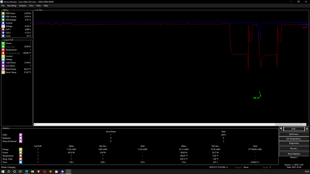

  2. So after charging the batterys both are charged. When plugged it shows 93% after a reboot. While disconnected from the PC it shows 52%. The screenshot is made while taking a puff, While not pressing the power button the the cells are not jumping anymore. Any ideas why the battery % is going to 52% while disconnected? And if i don't fix it can it be dangerous?

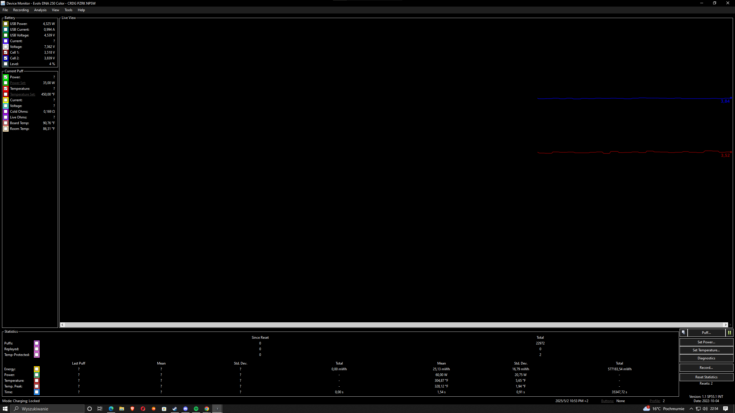

  4. Here you are, the second battery isn't as charged but it should show more than 4% right?
  5. So after changing the battery it doesn't jump buuut the 4% still is showing not 60%

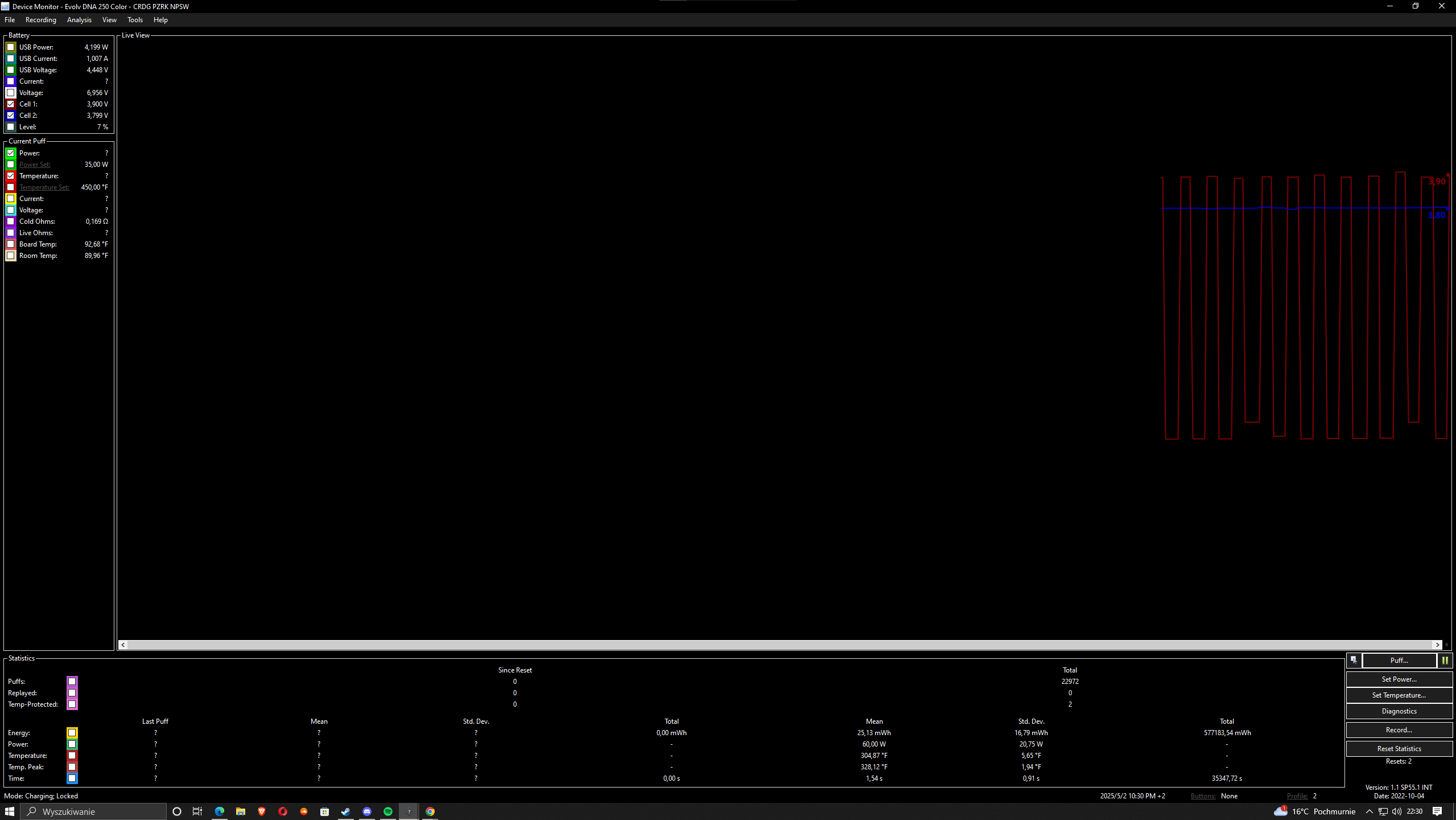

  6. Also cell 1 keeps jumping while cell 2 is still
