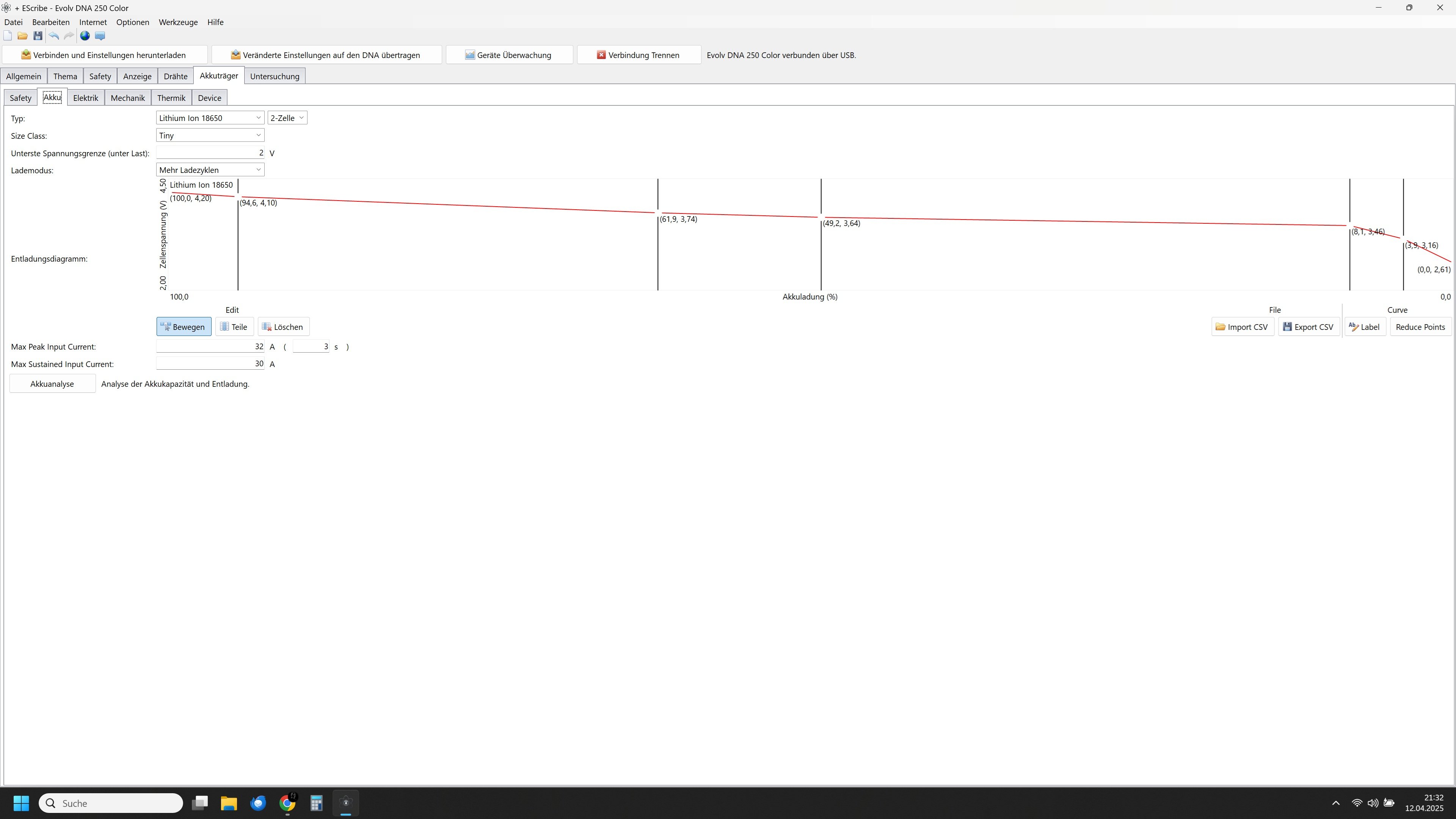

  5. I am not shure but i think i found the "bug"! There is a little red cable wich have no contact to the board. I think it should go the first pin at the same side. I solved the cable. But the board show the same wrong mesurement as before. I dont know what to do. Now i think the board is broken.
  6. The Cells are fine. I use an external charger.(xtar VC45L) with complete battery-health-check. So i disassemble my Riva tommorow again. Then i do some pictures and test all wires by multimeter again. I hope i can rescue my vape. Thx a lot for your help. I give tommorow some updates here.
  7. Thanks. Yes. It is not the battery. If swap them, always Cell2 shows smaller voltage. So we know the Battery is Ok and there is a Problem by wiring or bord. I check all cables. There is nothing wrong. Is it possible that the bord have defects? What can i do to find out?
  8. Ok. Here some Screenshots.
