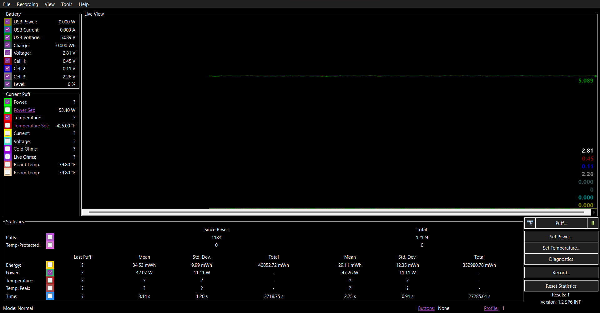

  2. Thanks, that worked now the mod is back in action after years I can see the screen starting to get lighter so I assume its almost EOL soon so I'm gonna try make the best of it now.
  3. Hi all. I have a LV Triade DNA250C which I barely used. The last time I used it was probably a year ago and it worked fine. Since then, I packed it away in its box and left it. Today when I tried to use the mod, the screen stayed off and the mod also won't fire. I connected it to escribe and escribe detects the mod and shows all the settings which I had. If i fiddle with the wattage buttons I can see it changing in describe What can I try to get this mod to boot up? Or is this mod useless now?
