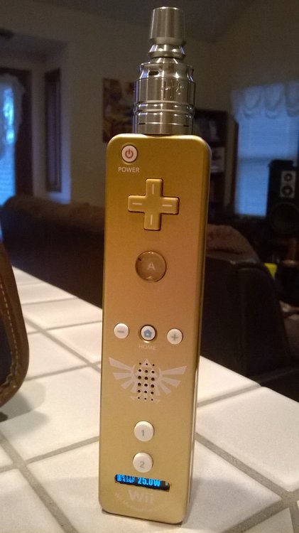

  1. So I didn't connect pin 15 because I thought it was only required for non Evolv boards. After connecting it works now! Silly me.
  2. It's the official evolv 1A micro USB board.
  3. No it's inserted fully. It's a custom built mod made from a Wiimote. This is an older picture with a DNA40 chip, I recently upgraded to a DNA60 but there's no button combo to flip the screen like I had it here.
  4. I've tried multiple cords, USB ports, battery in and out, multiple versions of escribe, with and without the driver. The battery charges when plugged in but I can't seem to get it to connect. What else can I do here? I would love to flip my screen in the software as it is upside down! The charging port is the micro USB version, data and power wires connected.
