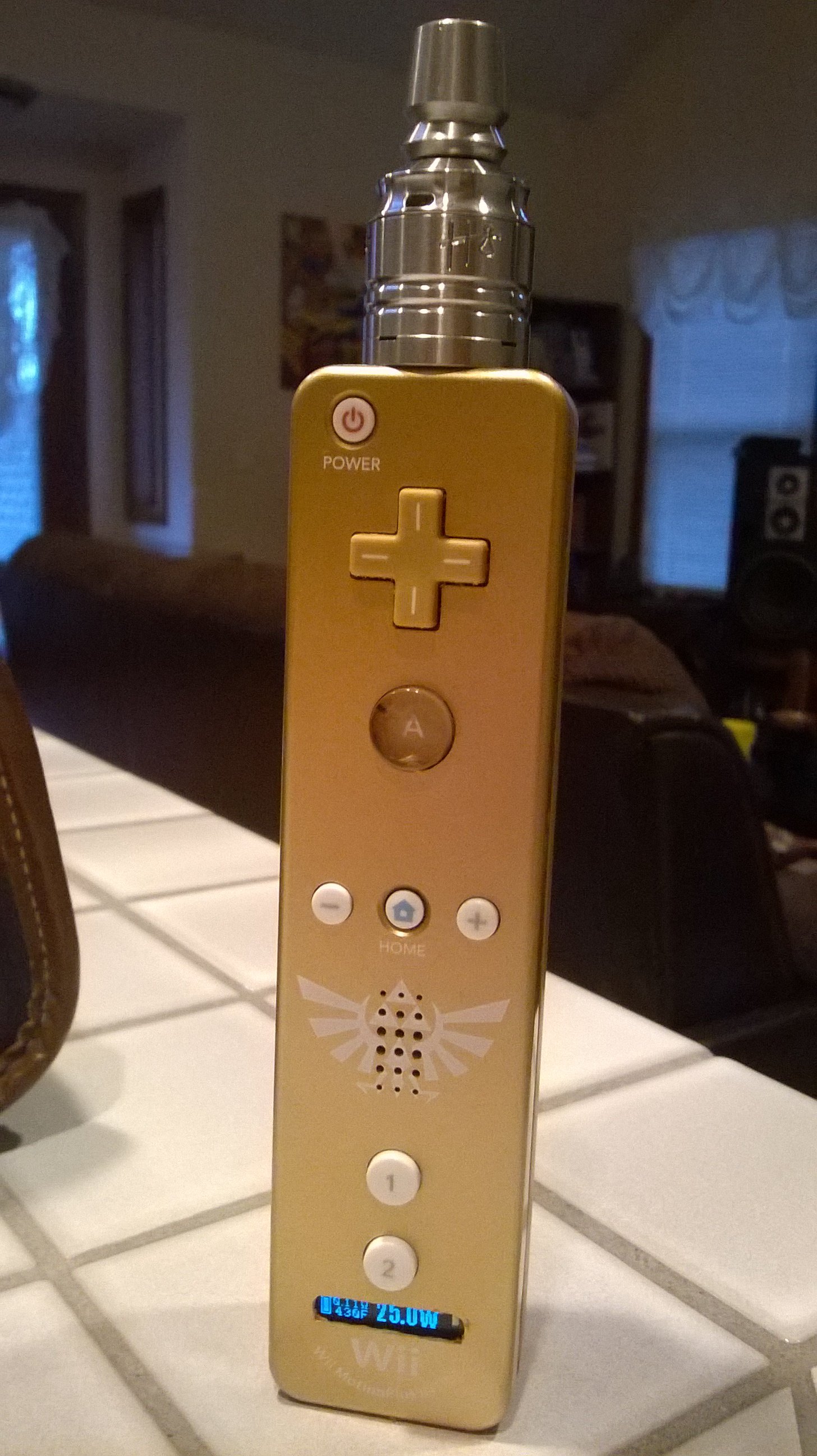

  3. No it's inserted fully. It's a custom built mod made from a Wiimote. This is an older picture with a DNA40 chip, I recently upgraded to a DNA60 but there's no button combo to flip the screen like I had it here.
