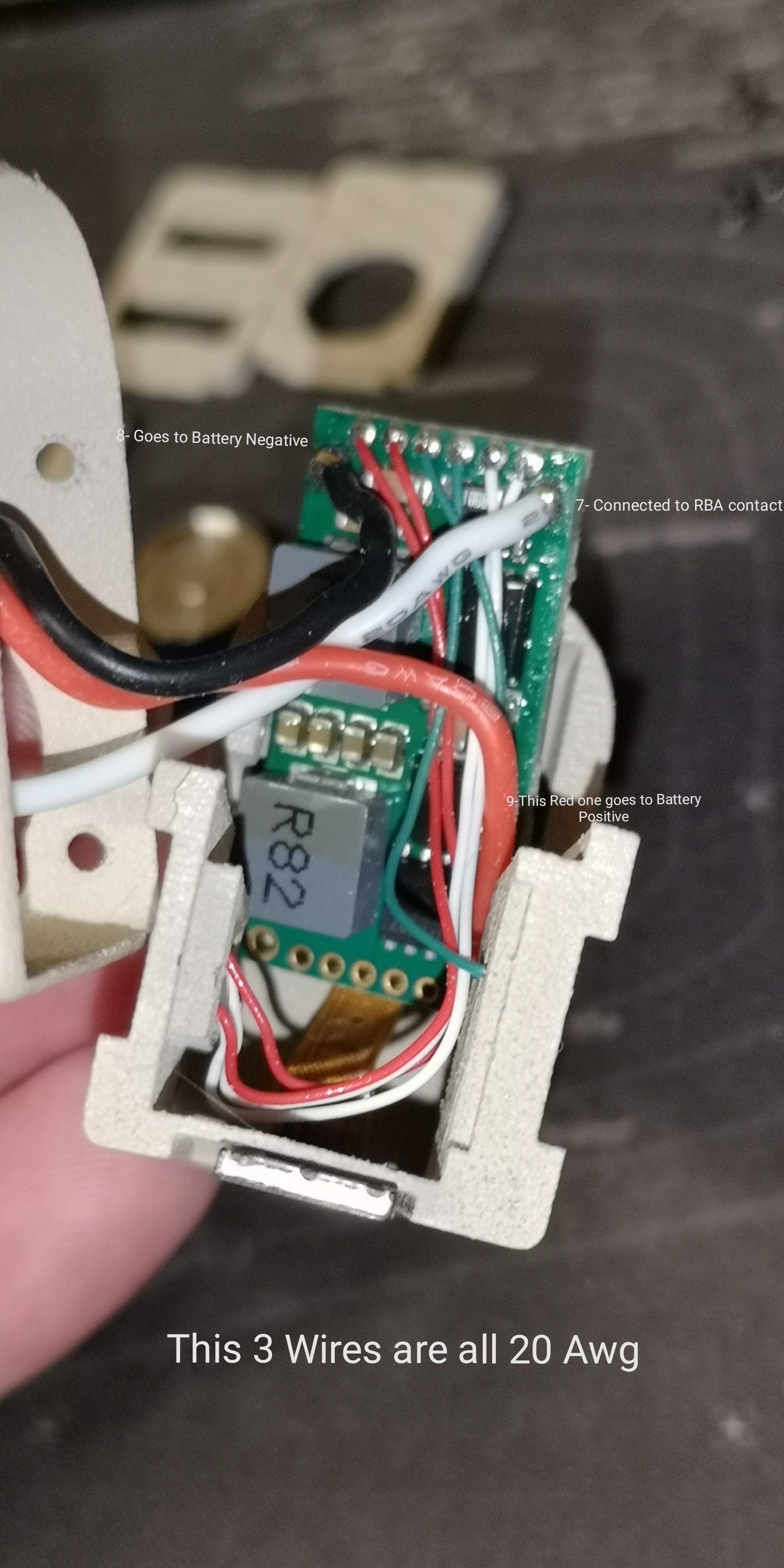

  6. Conclusion- i grabbed a Multimeter and did what @dwcraig1 said, the multimeter gets no reading too. Messaged me Privately and confirmed the Chip is broken, we are affraid, it happened while the Fire Button and the other 2 Buttons getting soldered out. I thank you @dwcraig1 for your great time, for the great support with tips and tricks. It made fun to find out. Thank you Evolv too. Your DNA chips are still the best ❤️

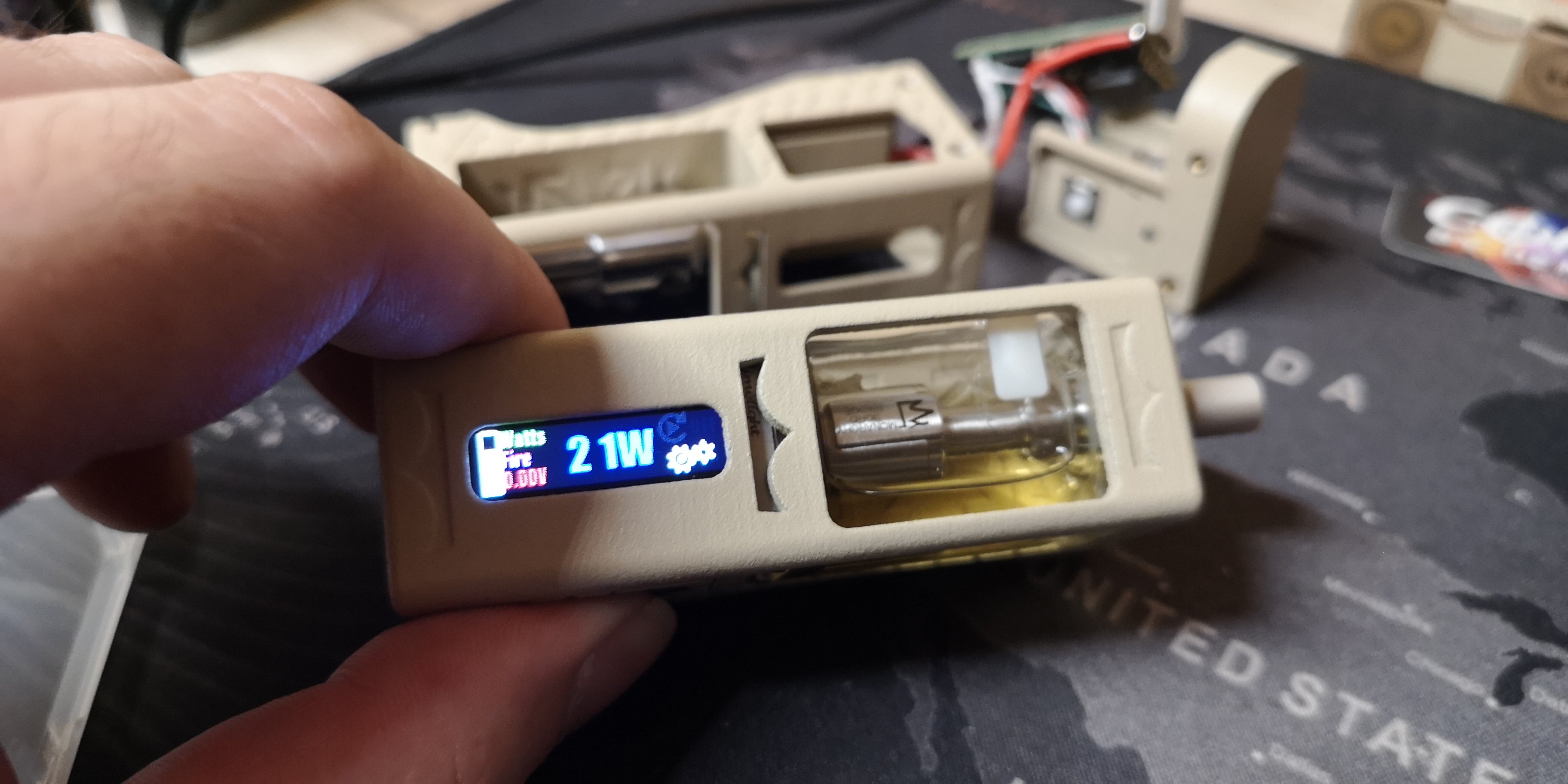

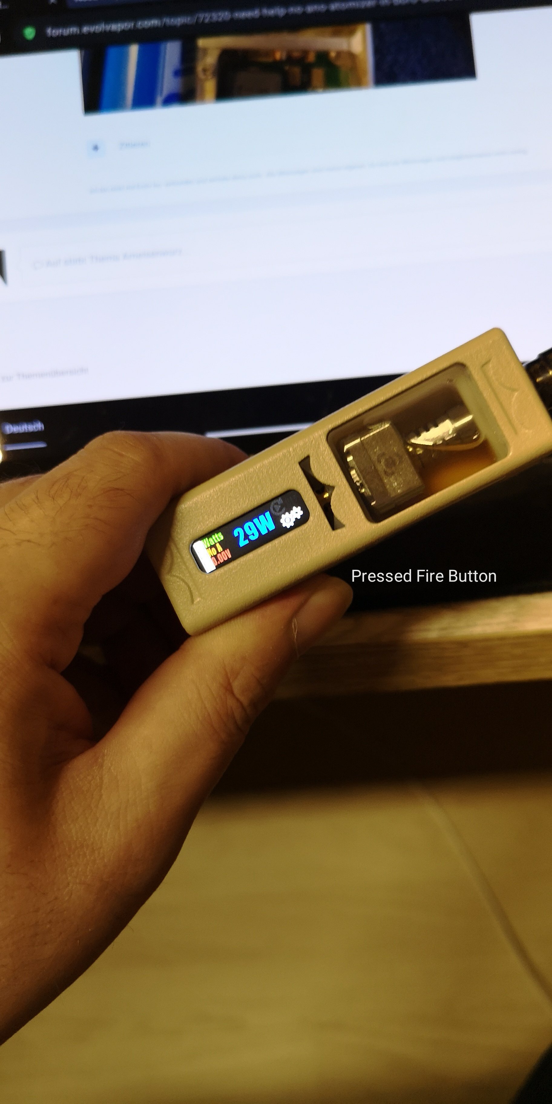

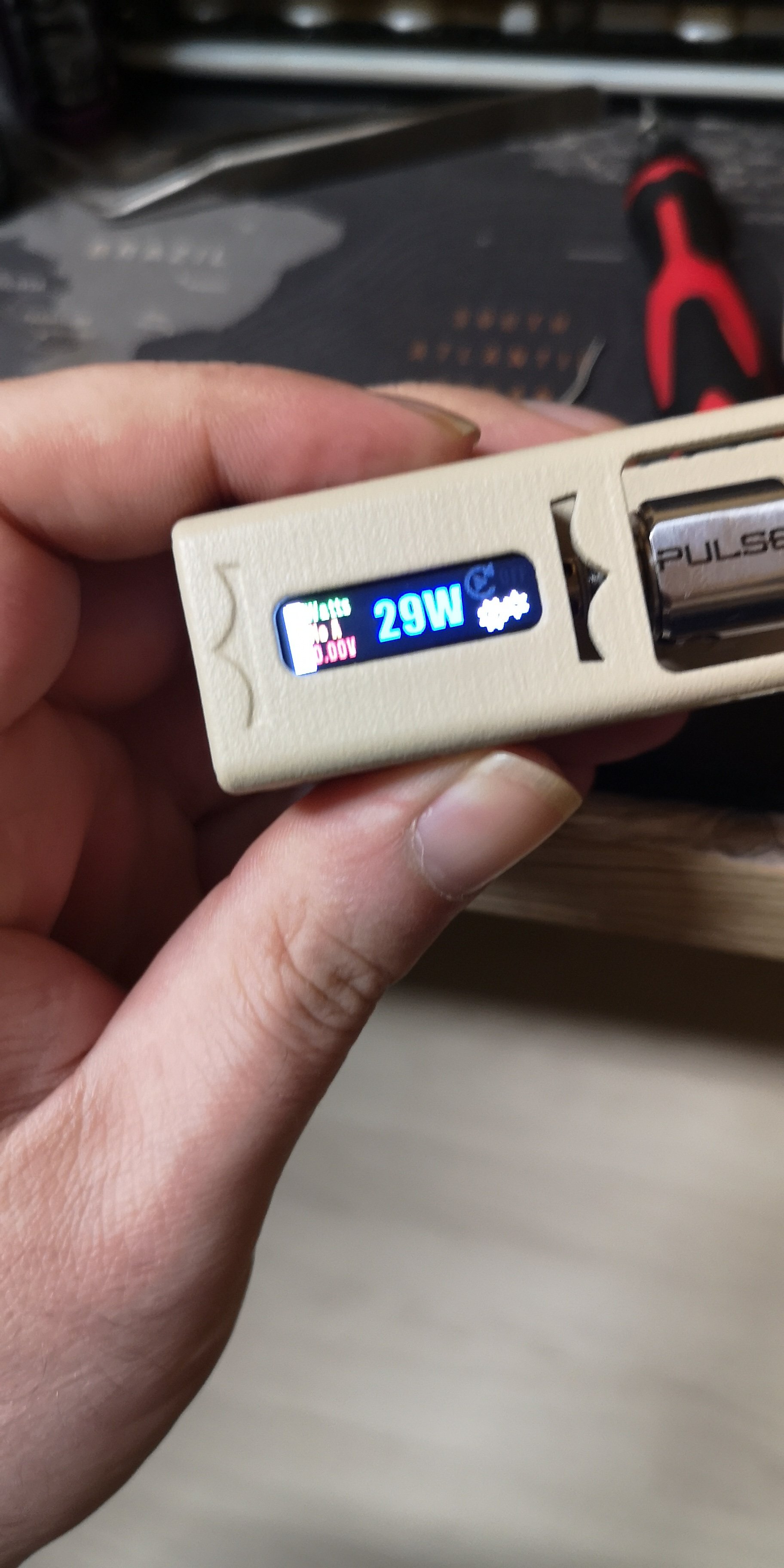

  8. It shows No A while firing, after firing still zero ohm, it is not showing ohms while firing Sir, i go with 1 Watt next time 😁. I catch a Multimeter soon and will continue what @dwcraig1 said and try. Update: From Support. he said, he send the new Mod already yesterday and a new PIN (?) together, if it arrives, he said i can replace the PIN and take a look if it is still working or not with the new PIN, i do not know wich part this Pin is. i come back here later if i test it, with new Mod and the not working one. i keep you up to date

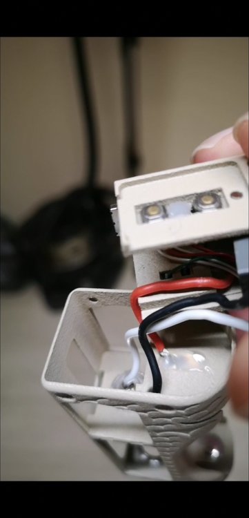

  11. Ok, if this size of the wires all correct, what else could it be? Chip is Broken maybe? (i wish, i could check with multimeter, but none here)

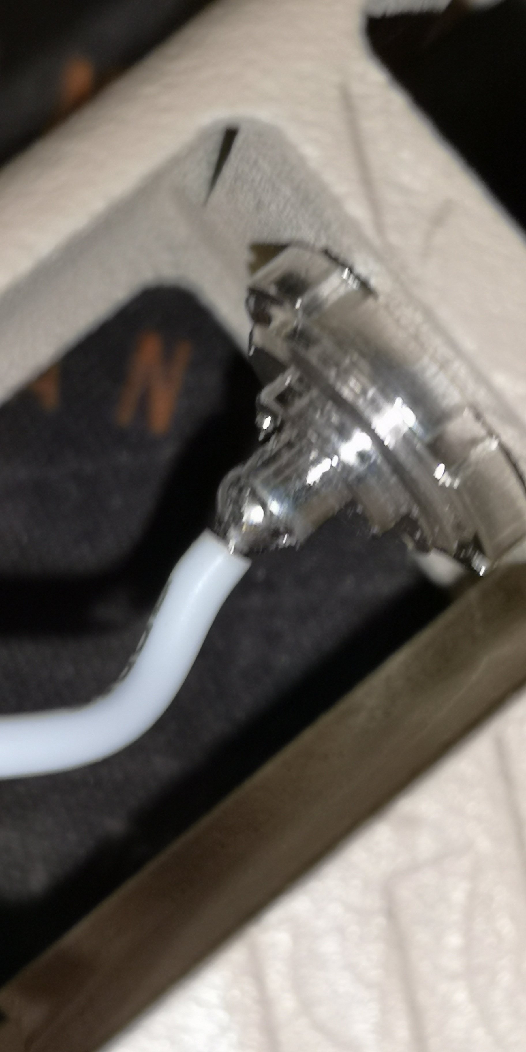

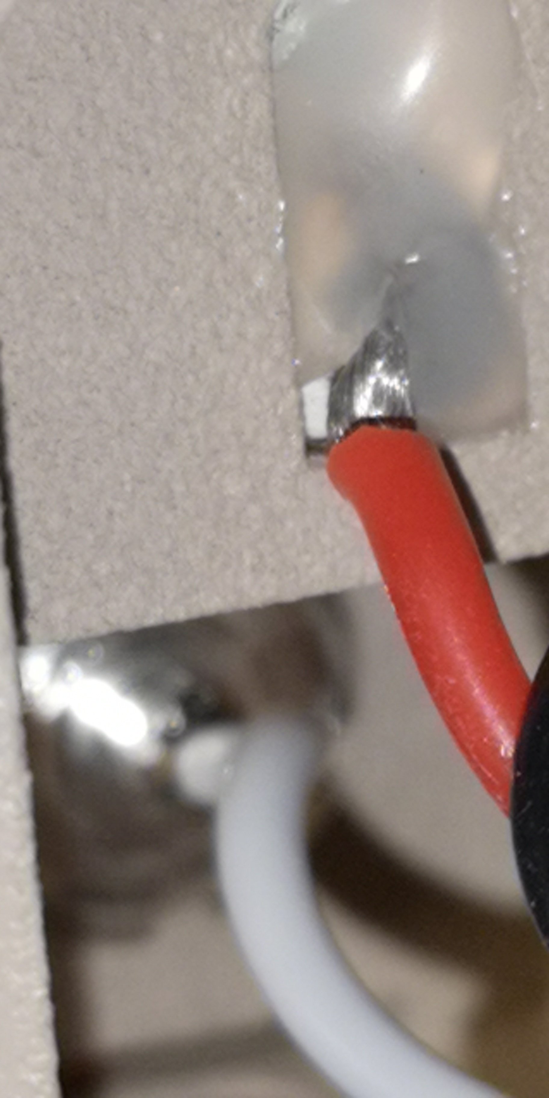

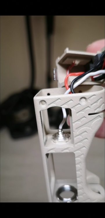

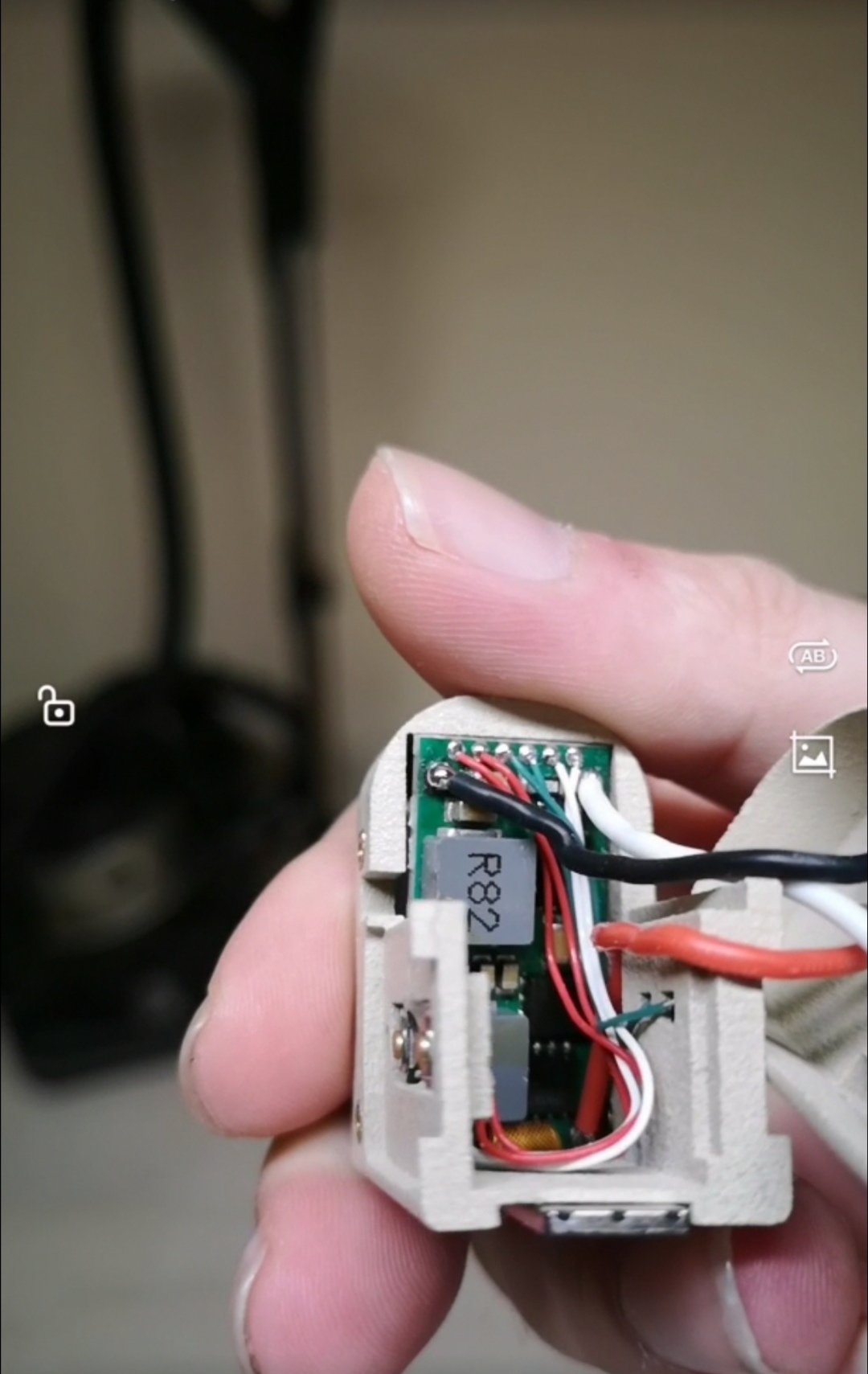

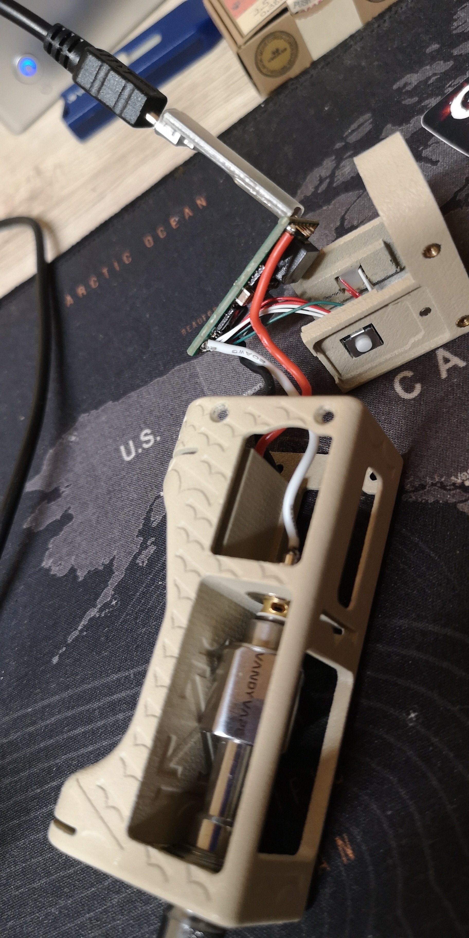

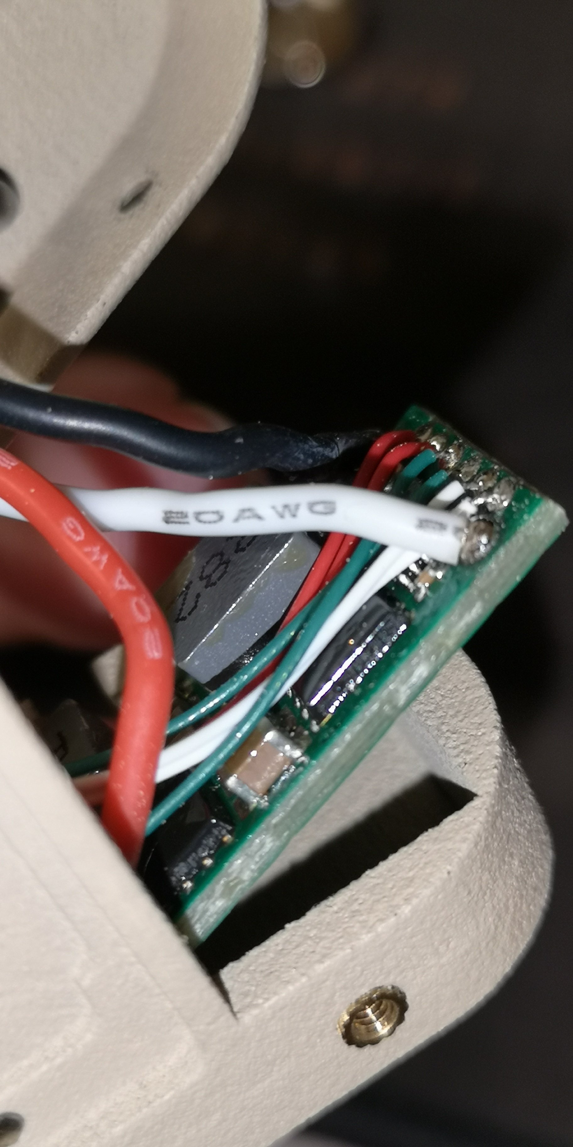

  12. Yes, i already did it too now Sir, nothing happens 😕 same issue
  13. Nope, not any multimeter here sir, i think i send it back, if the Manufacture could answer how to send it back of course. Are the wires at correct size? If you know?

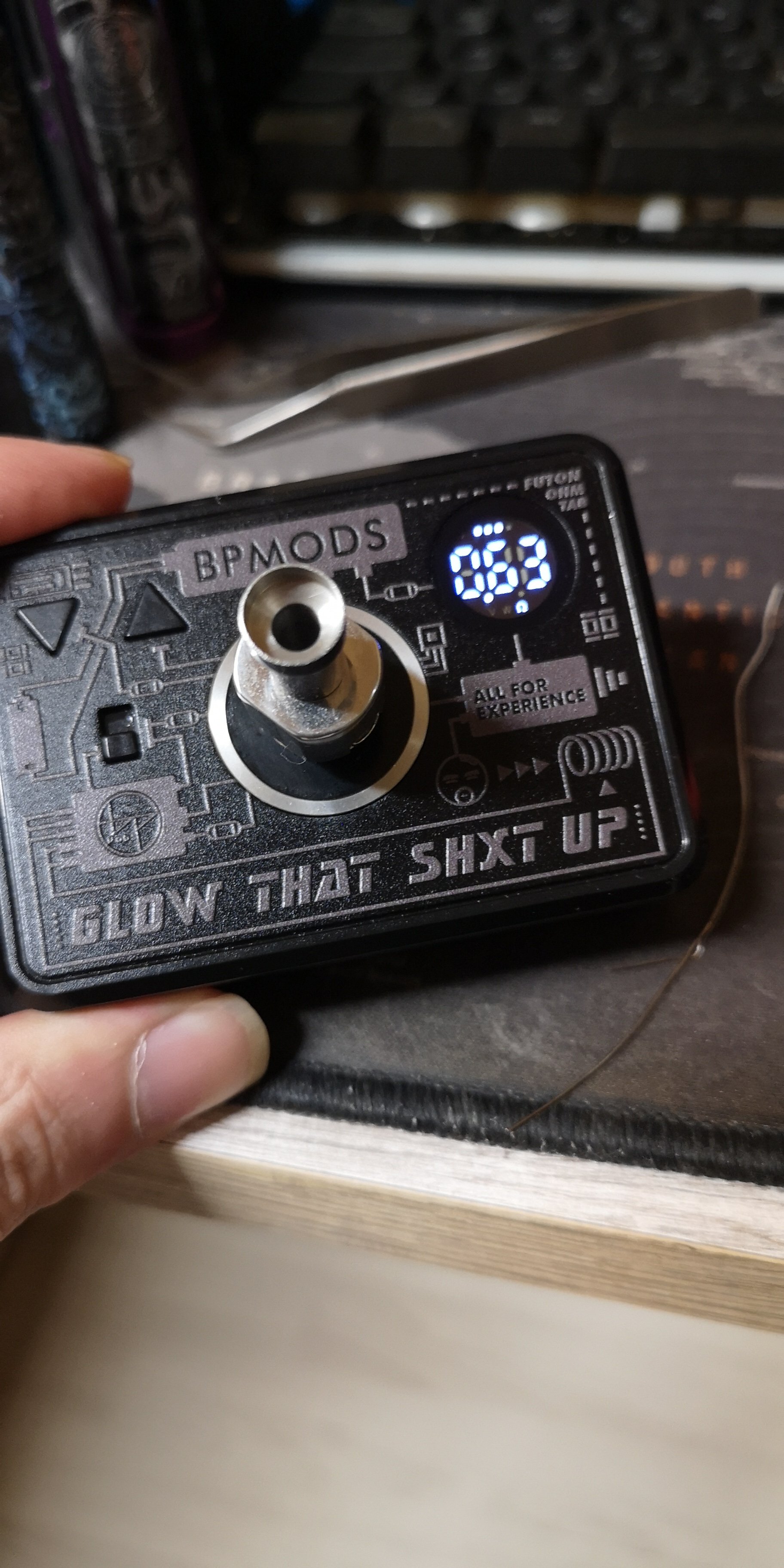

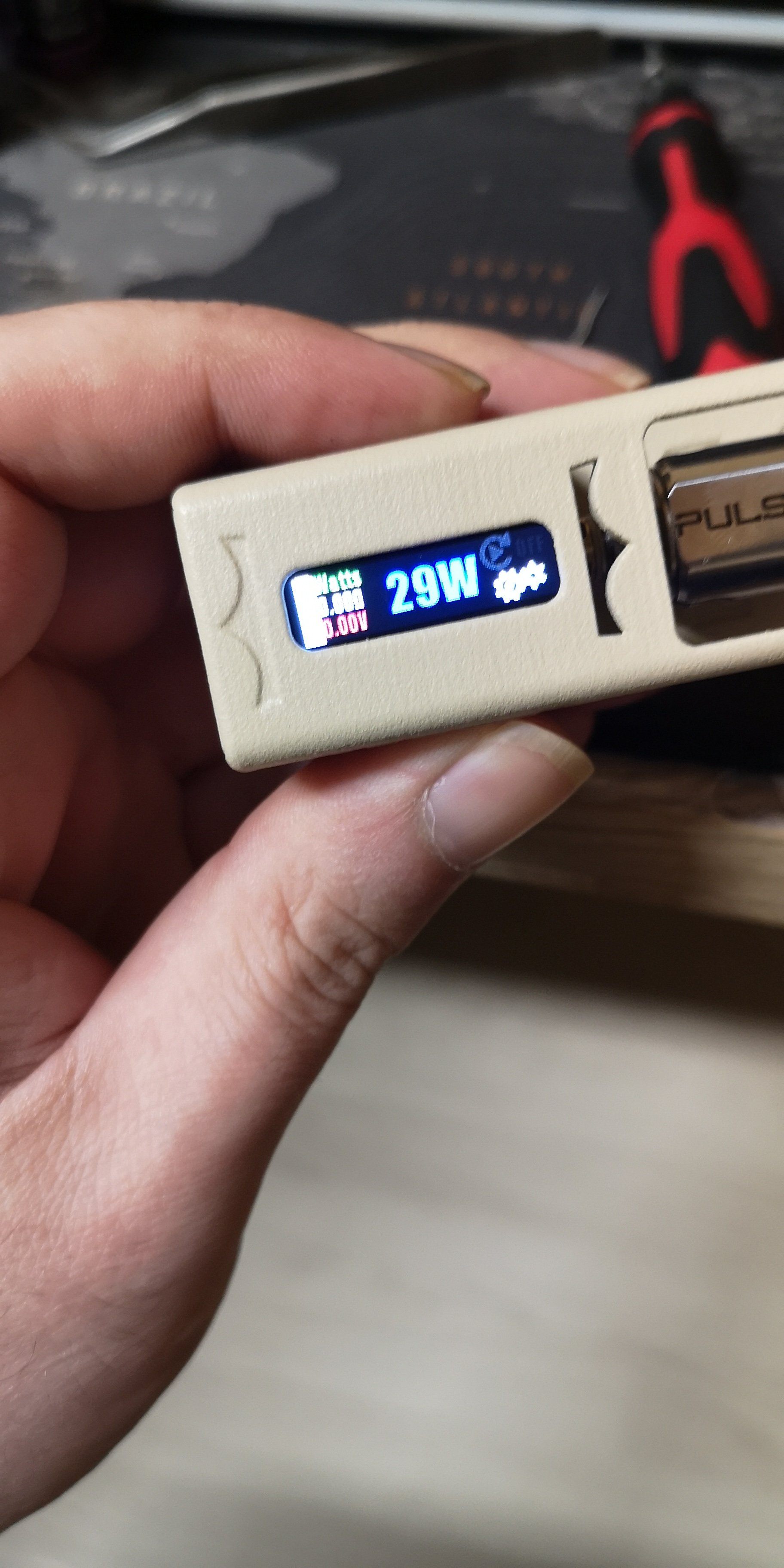

  14. Same issue, not pressed, 0,00 Ohm, if Pressed, it shows No A

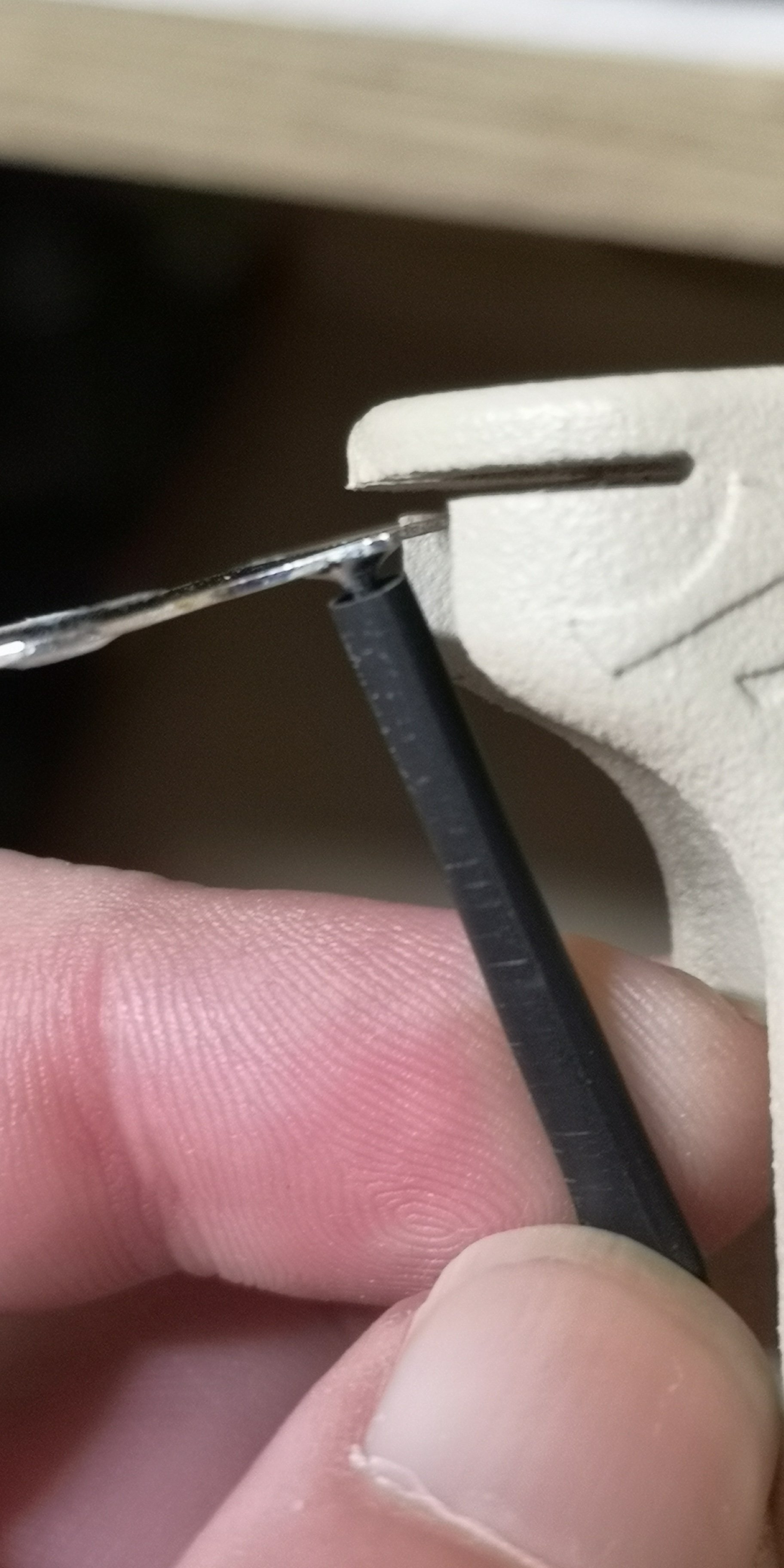

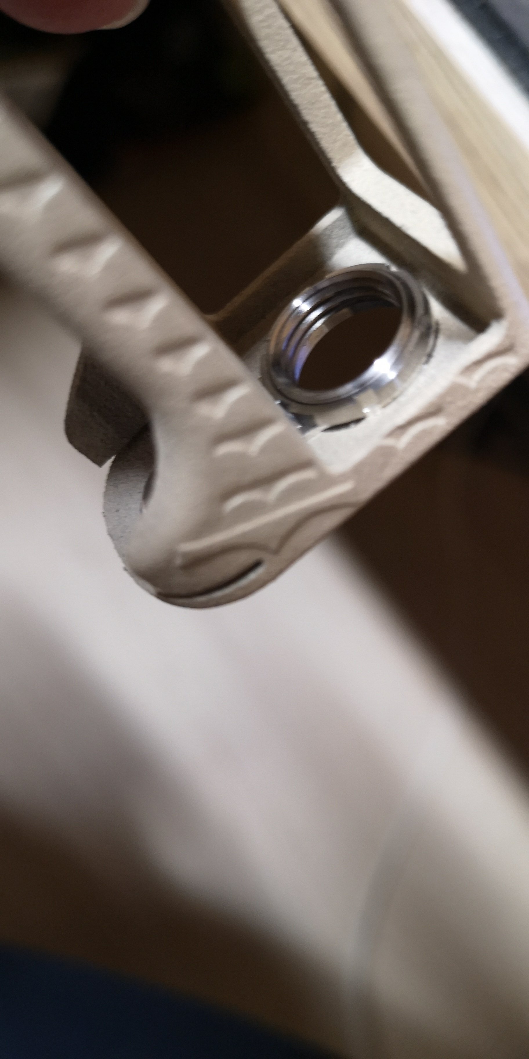

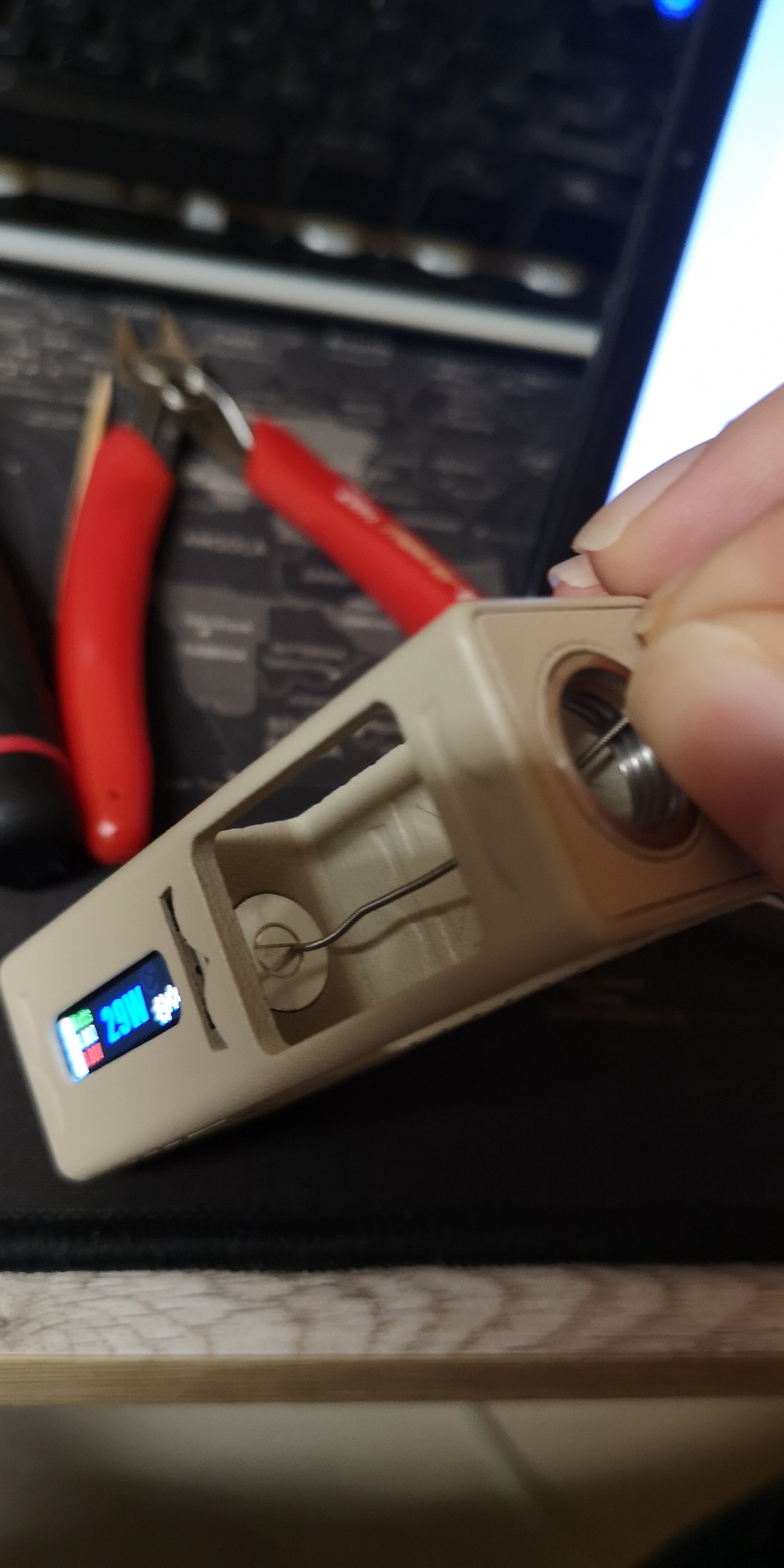

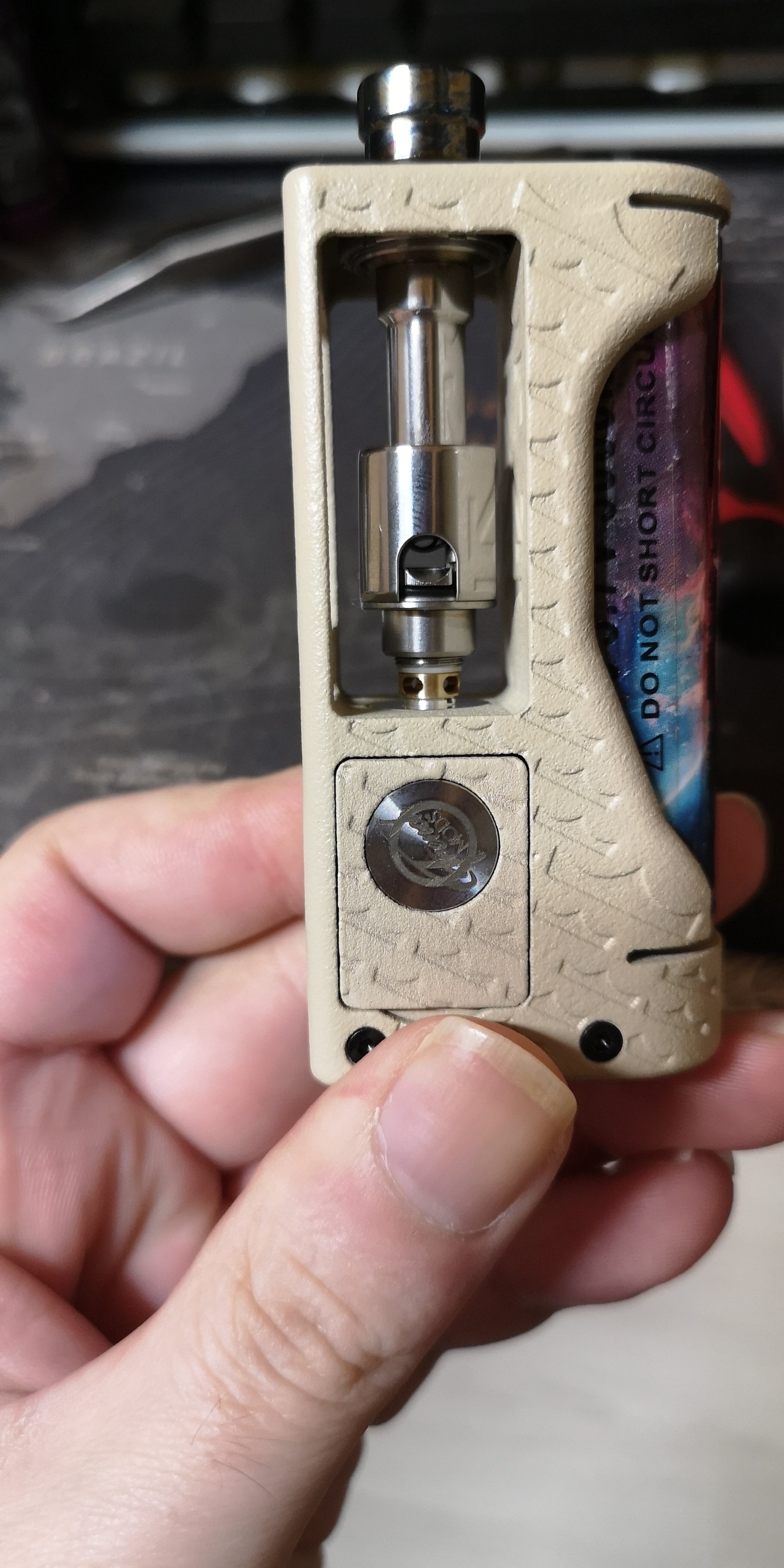

  15. Hello Sir, i tightened the nuts more as it was, Positive side (buttom side) and the negative side (upper side), after that i tryed again, and still the same. See the Pictures pleace, to the EScribe, i have no Usb Connection in the mod, even not the USB plate for the Dna60c. I have put a Rod like you said between the connections in the tank section in the safe way, no Ohm recognized at the Display of the mod.
