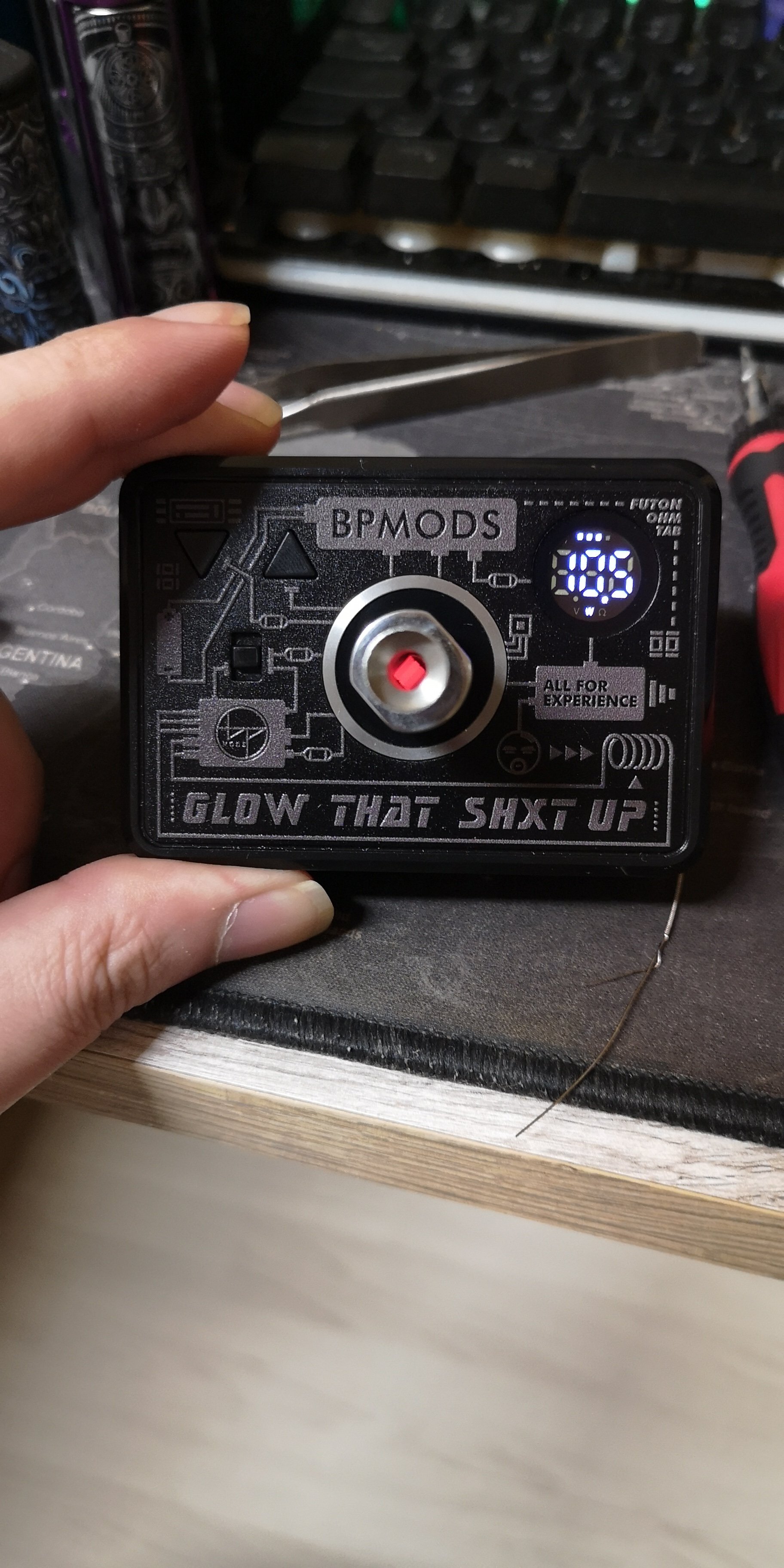

  5. Just in Case: This Chip is NOT a fail by Evolvapor, It is by Rekavape, the Buttons on the PCB (Platine), was soldered out, Rekavape send me a new one that works from Start, everything is fine. It was a Coincidence,FIRST Rekavape mod with FIRST EvolvDNA60C, hit a Men, that is a little bit crazy on trying out stuff, ME. I screw on no Company, the help i get first from Focalecig, then here at Evolvapor, Focalecig decided to Send me the same NEW mod. It was a great experience and the best friendly Support i ever get, from both. They did NOT let me alone, and i THANK YOU, if you have any Problems, they do not let you alone, like u can see here. So pleace, for all the people who reads this, don´t screw on anybody, mistakes happens, nobody is Perfect, even me. Vape on and out
  6. Conclusion- i grabbed a Multimeter and did what @dwcraig1 said, the multimeter gets no reading too. Messaged me Privately and confirmed the Chip is broken, we are affraid, it happened while the Fire Button and the other 2 Buttons getting soldered out. I thank you @dwcraig1 for your great time, for the great support with tips and tricks. It made fun to find out. Thank you Evolv too. Your DNA chips are still the best ❤️

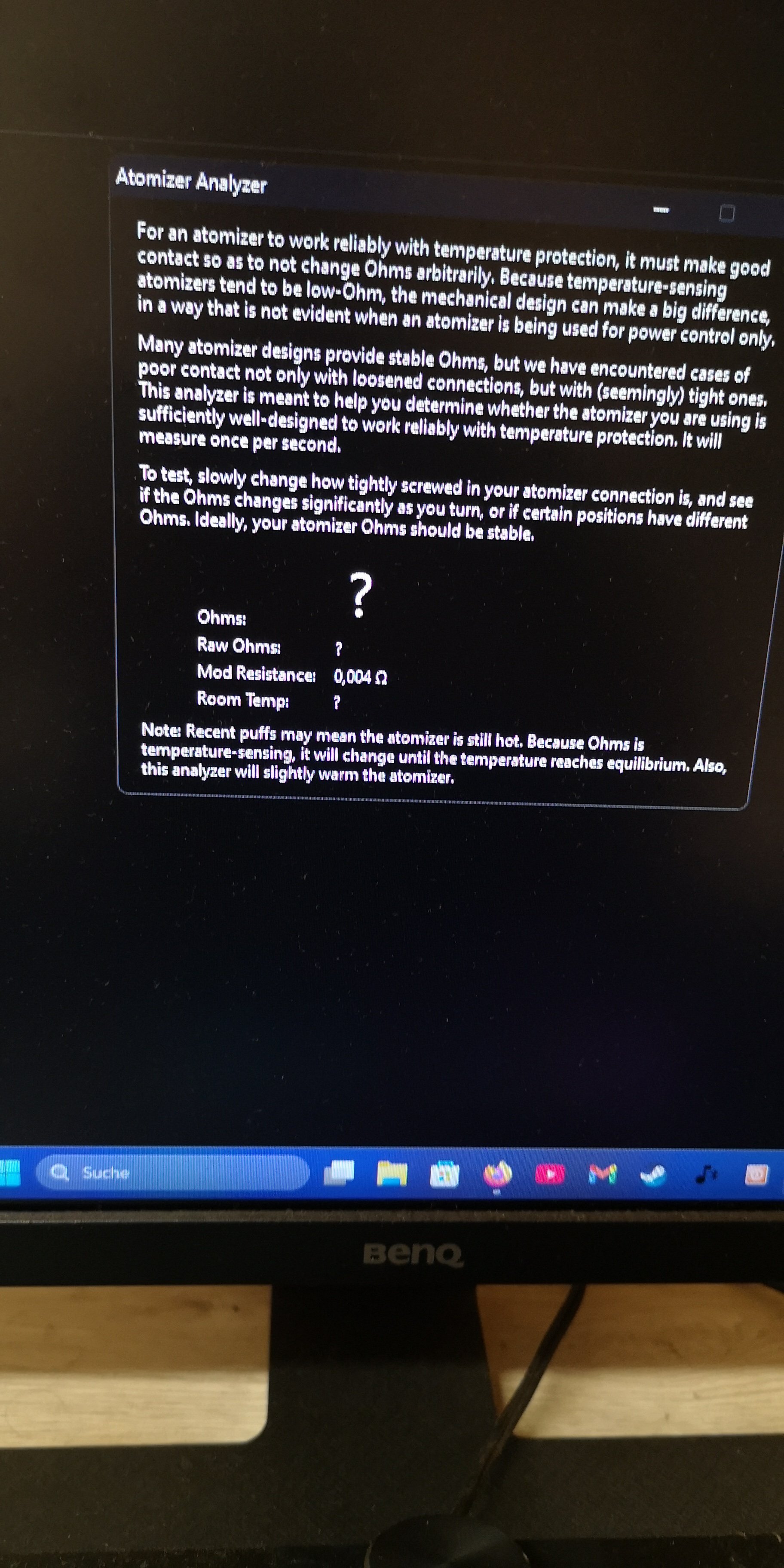

  7. Hello @dwcraig1 catched an USB dongle for more by Stealthvape. Serial Number: ******************** if needed i include by edit Firmware Version: 1.1 SP75 INT Firmware Date: 2024-03-25 Revision Code: 311107558 USB Vendor ID: 268B USB Product ID: 0436 USB Product Version: 1.1 what else do we need Sir ? Update: They send me new Device, that worked from Start, so thatswhy, i want to know what is wrong with the Broken one and find out, if possible. Atomizer Analyzer showing all the time the same, if i losen the Threat or tighten the RBA, pressed fire button even the same is showing, nothing changes (still no Multimeter yet, hopefully not needed)
  8. It shows No A while firing, after firing still zero ohm, it is not showing ohms while firing Sir, i go with 1 Watt next time 😁. I catch a Multimeter soon and will continue what @dwcraig1 said and try. Update: From Support. he said, he send the new Mod already yesterday and a new PIN (?) together, if it arrives, he said i can replace the PIN and take a look if it is still working or not with the new PIN, i do not know wich part this Pin is. i come back here later if i test it, with new Mod and the not working one. i keep you up to date

  10. Yes my First Rekavape Frenchmod clone with Dna 60c <even first. Had never a DNA chip in my mods. Have contacted the Manufacture, he know this issue, whatever we tried, even without boro tank, only Rba, did not work (he tought it is the Boro Tank, that makes trouble 😁) He will send me a new one he said, i telled them to check mods, if it works, before delivering. Asked him to how to send the broken one back, no answer, i thought, maybe i try my luck here, for the hope maybe it could work, if i ask here

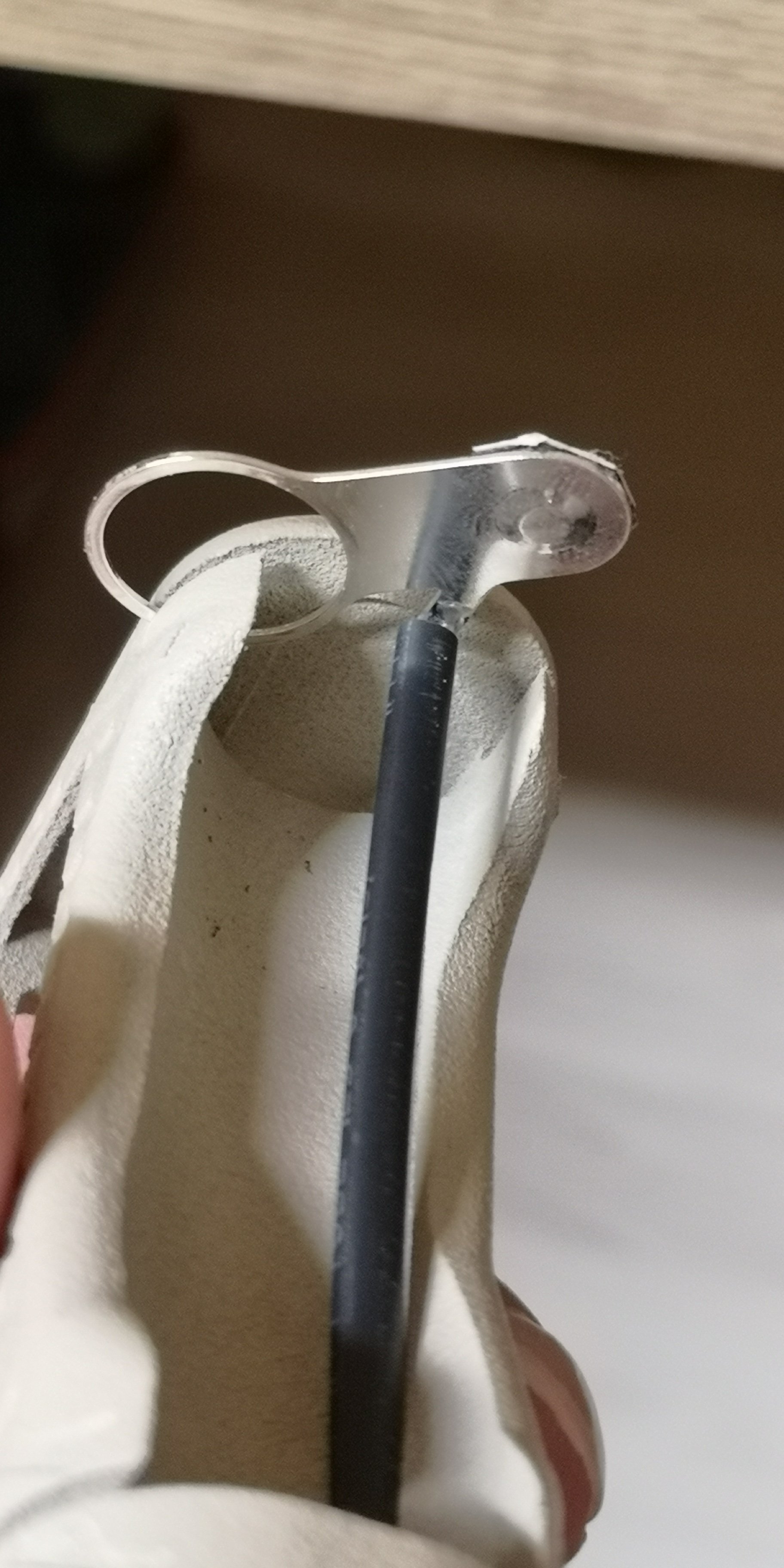

  14. Same issue, not pressed, 0,00 Ohm, if Pressed, it shows No A
