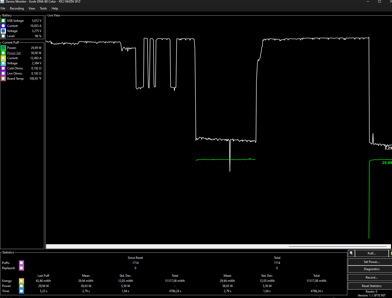

  3. In the pics i posted yesterday i was using the shift tank with a GTX coil but it also happened previously when using an RBA with an Alien coil.
  4. Battery was around 4.13 and it dropped to 3.35. That is still a big drop no?
  5. Ill try again with a full battery and see. Still the ones i used was around 70% full. nothing was lose, i just snugged everything.

  8. So I opened the mod from the panel side and was able to access and tighten all the screws; seems to have helped a bit with getting more juice out of the battery, as the puff count is now around 150. but I'm still getting these weird spikes nd voltage drops when I vape on it, what do you think ?

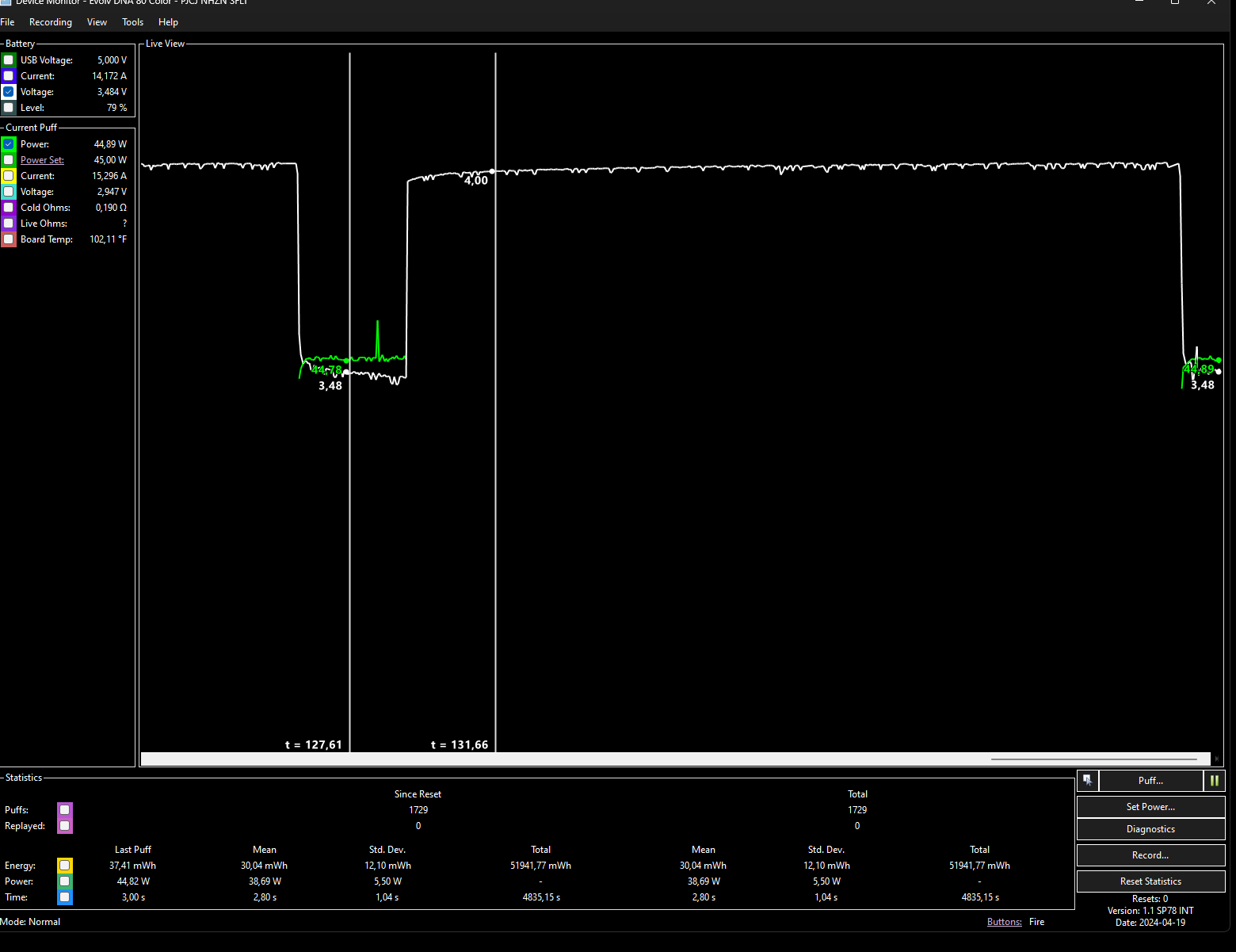

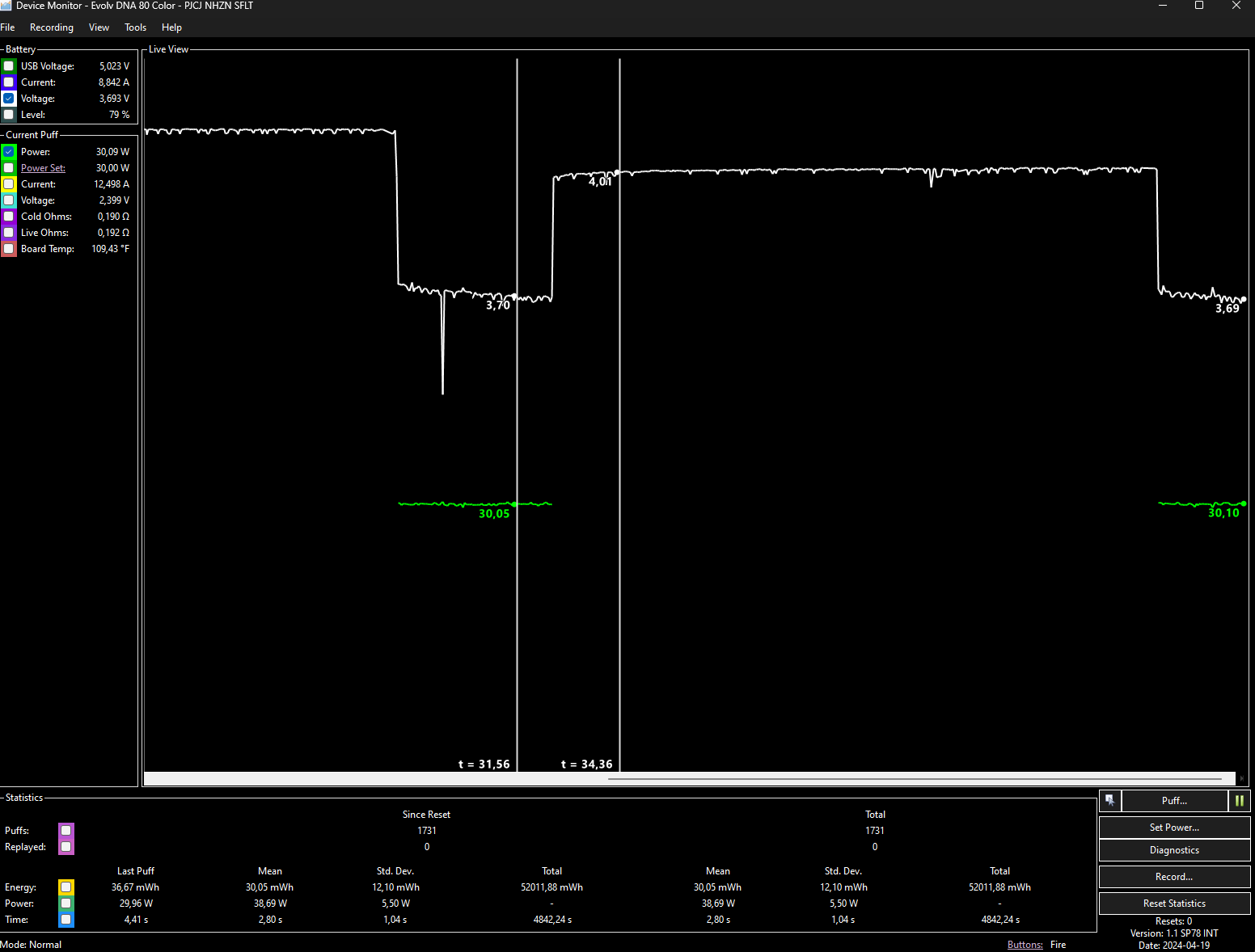

  11. Changed the wattage to 45W for better flavour, here is with 30W.
  12. Fresh battery with more vertical lines while vaping
  13. Yep, not firing. Was thinking that it looks weird too
  14. My battery was half full when i did this. As mentioned it is 3 weeks old molicel p30b bought from a reputable local shop. The wheel on the negative terminal is tight.
  15. Another while im vaping.
  16. Here is my setting file and a screenshot of the Device monitor while vaping at 30W with the hover mark. if you need any other info please let me know SETTING dna80c.ecig
