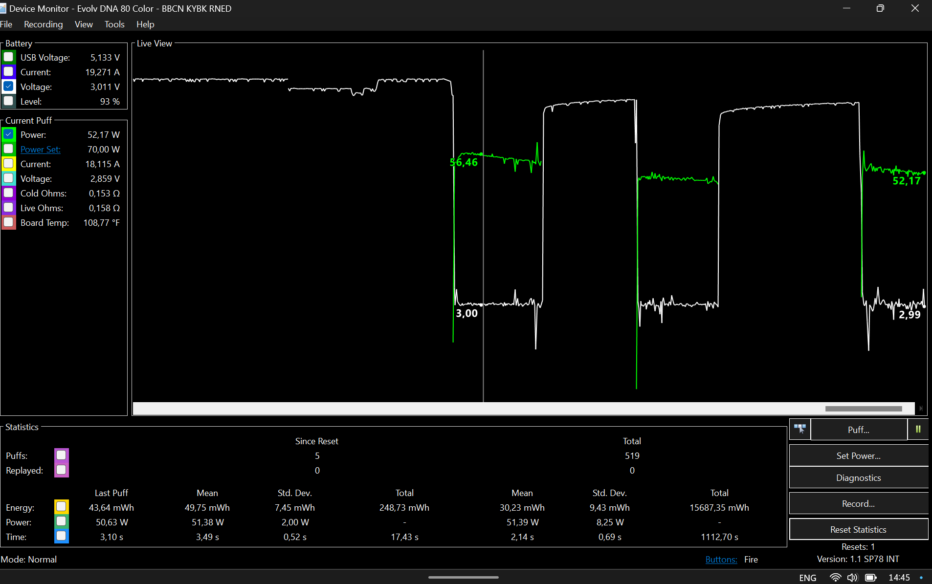

  4. I believe I hit 3 volts as well with a pretty new battery.. Lowest was 2.99 when I took a puff
  5. Here´s my data. I hope i did it correctly. It was a quite new battery. I believe i got this early July. Freshly charged. Popped it in and did a test with 6 puffs. First i did 3 puffs, screenshotted and i didnt get a volt reading because i forgot to point the mouse (around 3 volts for every puff). Thats when it showed 93% after 3 puffs... did three more, screenshotted and also screenshotted the battery level which is now down to 86%. 6 puffs apparenty takes 14% which makes sense with the 30-50 puffs me and @EagleRock have been noticing. Tell me if you need any more data.
