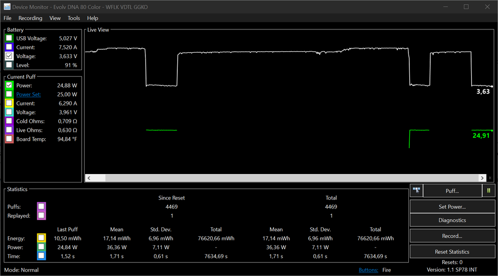

  1. Tightening every single board related screw to near stripping will help a bit. I ended up attempting soldering the board myself to eliminate the issue which resulted in me frying it. Waiting on a new non-VC device now

  5. Here is device monitor with the vape plugged into my laptop, also attached pictures of charger. I can't measure anything with the charger plugged in, would be willing to sacrifice an usb-c cable, but I am travelling and don't have a multimeter here.
  6. Sorry about not stating charger before, did not notice. It is a normal samsung quickcharge charger, genuine, came with a phone. Its 9V 1.67A and 5V 2A My screen says its charging when plugged in but the battery level never increases
  7. I have since installed a weaker 0.6ohm coil at 25w as something for 30-40w compatible with the shift tank was unavailable at my local store, it does yield me better bat life but sacrifices quite a bit of flavor, here is a screenshot. 45w might just be too much for a single 18650.
