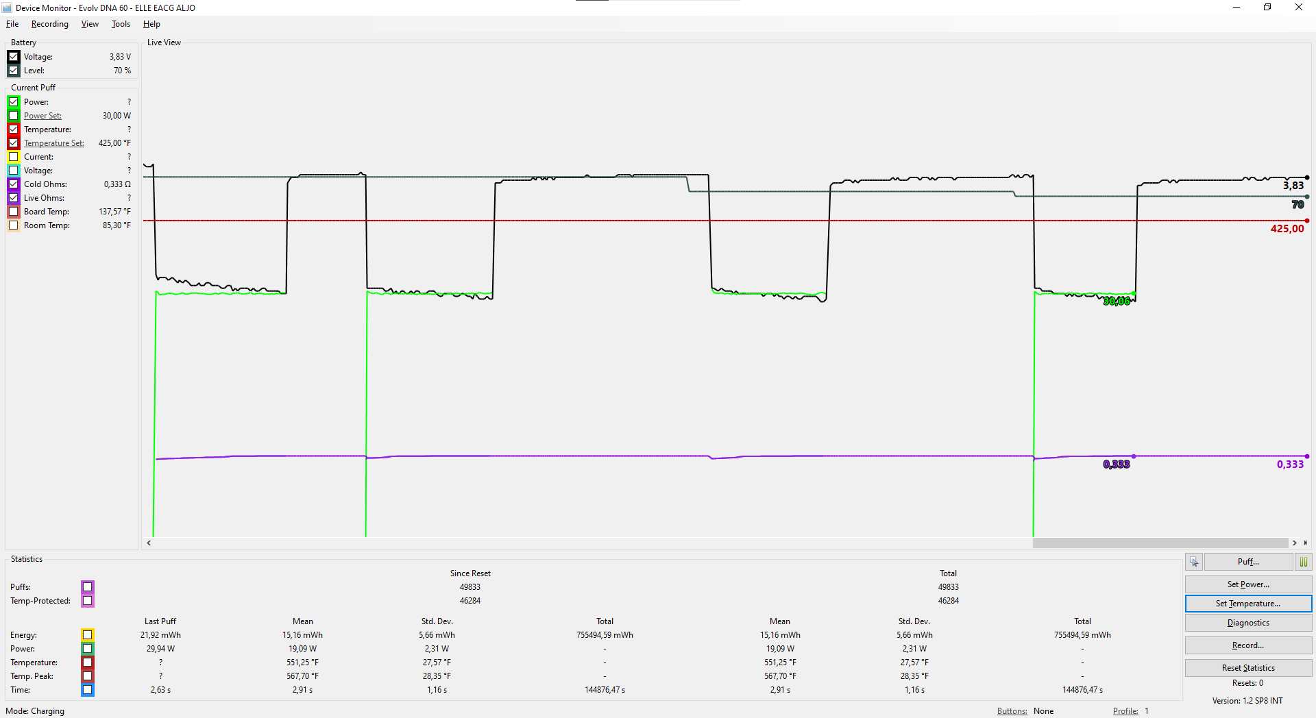

  3. I have disassembled both old coils and attached a photo. They both have those "legs" in there.. actually not that much different except for the larger holes in the mesh. I'm not very tech savvy, but it seems to me that if I just swapped the contact part on the one from the old one, it might work. I'm pretty pissed off about it. When I finish vaping this tank, I'll give it a try. I am also attaching a screenshot of the device monitor with the profile you sent me in PM.

  8. Hi everyone, I'm having an issue with my SKNKWORX - DotAIO D-01 and the new revision of Dotmod DotCoil - 0.3 ohm coils. Recently, Dotmod introduced a revised version of their DotCoil, which supposedly has better sealing or something along those lines. However, I've run into a problem: temperature control doesn't work with these new coils. According to the inscription on the coil, it's made of the same material as the previous version, but Escribe software detects it as Kanthal, which doesn't support temperature control. Has anyone else experienced this issue? Any advice on how to fix this would be greatly appreciated! Thanks in advance!
