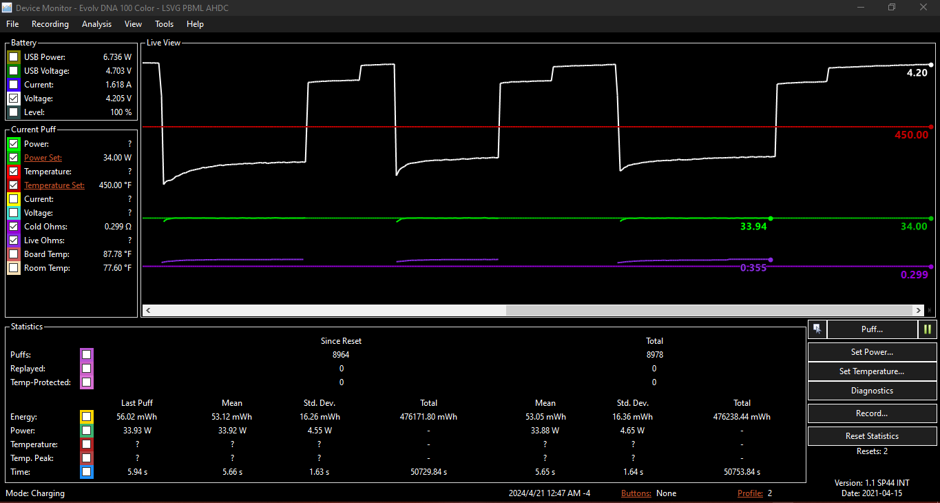

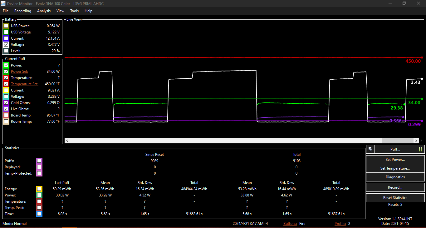

  1. Thanks for the help so far, after cleaning the contacts and re-adjusting the battery cap, it stayed until 25% battery before dropping off. Not perfect, like how I used to get it to 10% before dropping but still, good enough that I'm happy with how it is now. Here's it with the battery at full charge and here it is at 25% when it started saying batt down. I noticed it kept climbing in charge when not using it to the point of gaining almost 10% charge within minutes, then taking a couple puffs, it quickly drops back to what it should be. Not overly concerning but just something odd. It was having a lot of difficulty reading the battery charge correctly compared to before
