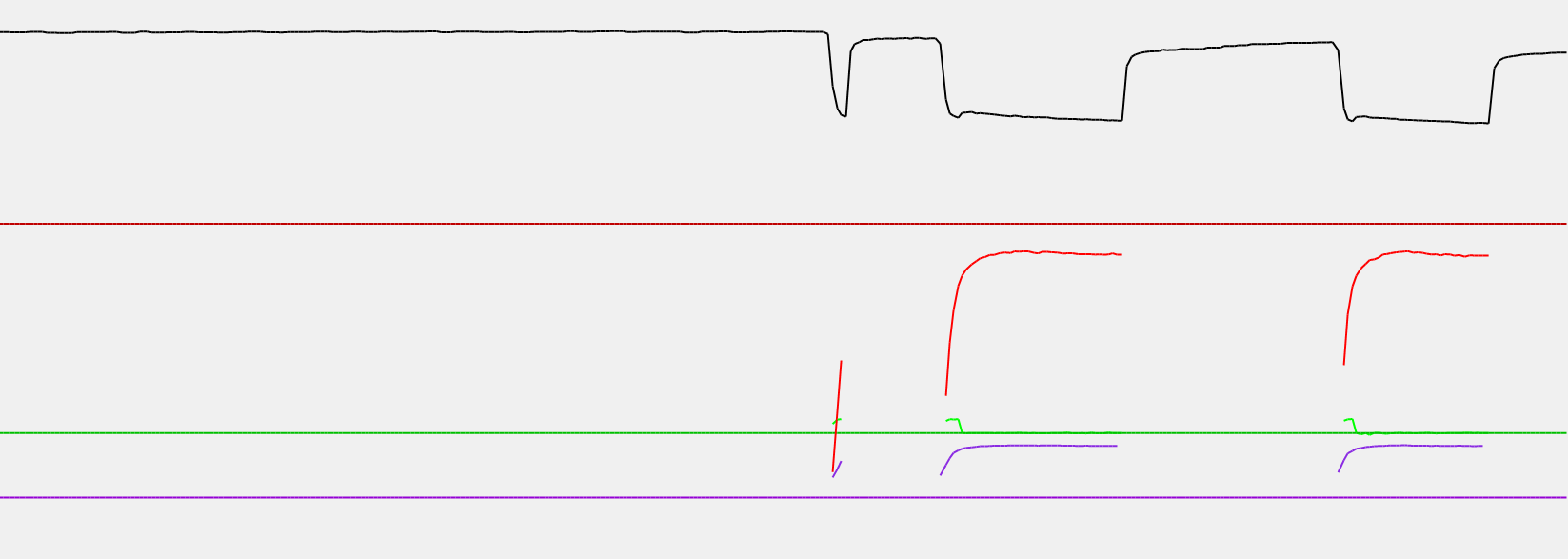

  1. Ohh im sorry I'm not use to pc anymore so that's my bad I used the screen shot function in escribe. Currently vaping really nice and flavourful. I think I may have went a little to light on the cotton because I didn't want to move the coil so I think that was also the reason.
  2. Alright i tore my mission krma rda down, gave it a full clean. Put a new build in, 24G Ti 1, 8 wrap, 2.5mm id, running at 400 f, 45 watts, preheat set to 50 watts with 8 punch. build came out to .219 and here is the device monitor. This is in titanium tc mode only with no replay.
