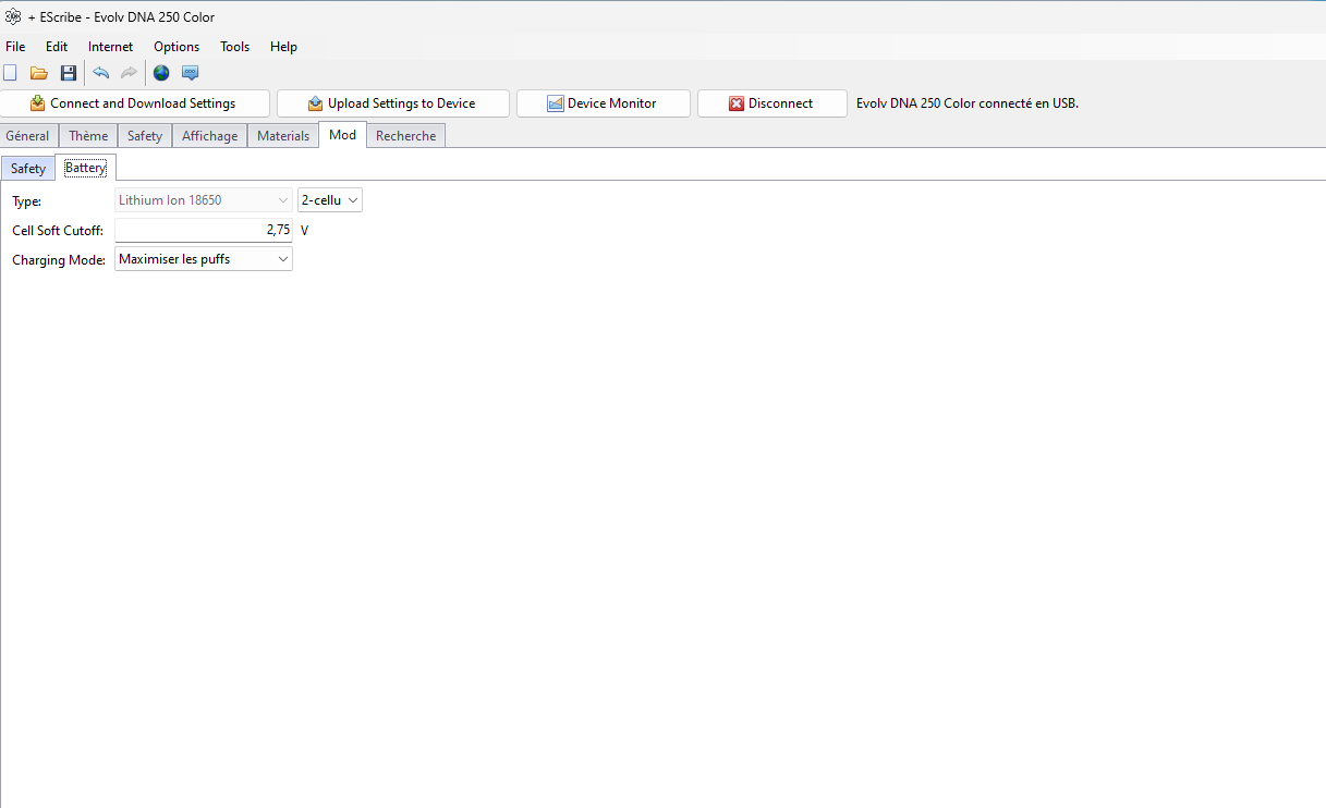

  3. Hi, it's me again ! I don't find the option where you indicate ! escribe -> mod -> battery tab. Where am I wrong ? I test in windows and Mac... There is maybe a command line with the serial terminal ?

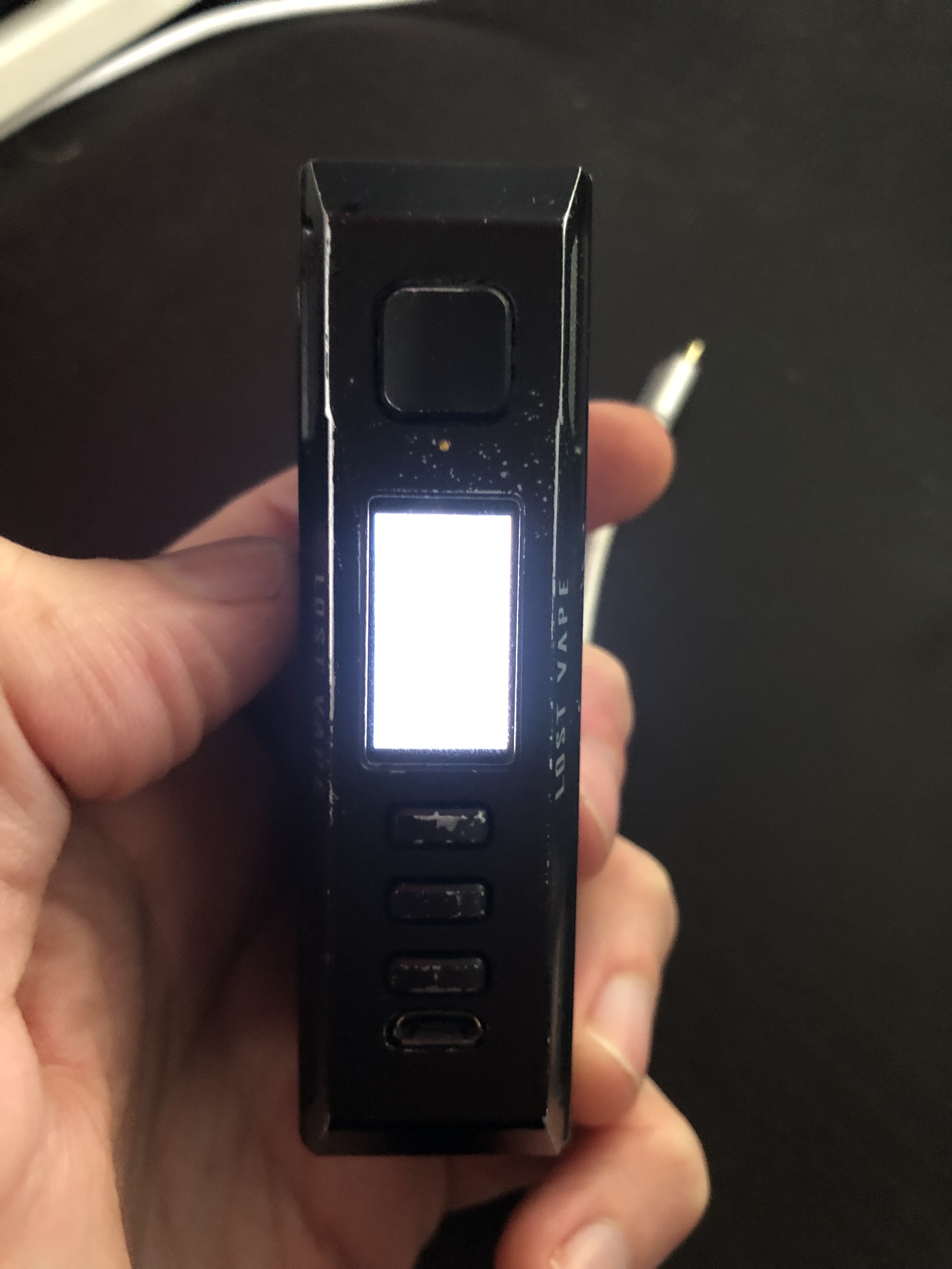

  7. Hey, thanks for the tip ! I try this and it's working. But I've got a white background after this manipulation. Can I process an hard reboot after this ?
