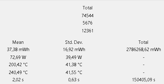

I just performed another reset, check the replayed puffs please, And in the total stats the puff counter shows 75171 and the real number is 409861, but the total energy and the total time are correct. -

Yes, that's what I'm saying.in the device I'm using the setting recordings-puff count (recorded puff count) and that one gives me the real number, the setting-statistics total puff count got stuck a long time ago, until yesterday. Yesterday I did some checks. "I did a couple of checks and it as to do with the setting I'm using. So in the first image I posted yesterday, the setting I was using, was (Recorded Puff Number), and that setting until now worked like this, I could see the total puff count on the Mod but in the device monitor was stuck at 74193. I decided to check the available settings, and I changed from (Recorded Puff Number) to (Statistics Total Puff Count) (Pic_1) and it started to update immediately on the Mod, and at the device monitor, but from 74193 puffs not from 408884. I went back and changed the setting to (Recorded Puff Number)again, and in the Mod keeps showing me the correct number that now is 409232, and the device monitor started to update, but from 74193 that is now 74545 (Pic_2)." And today come to find out that at the normal statistics, (the ones you can reset) at the device monitor the replayed puffs doesn't reset also. -

Back, ok, I did a couple of checks and it as to do with the setting I'm using. So in the first image I posted yesterday, the setting I was using, was (Recorded Puff Number), and that setting until now worked like this, I could see the total puff count on the Mod but in the device monitor was stuck at 74193. I decided to check the available settings, and I changed from (Recorded Puff Number) to (Statistics Total Puff Count) (Pic_1) and it started to update immediately on the Mod, and at the device monitor, but from 74193 puffs not from 408884. I went back and changed the setting to (Recorded Puff Number)again, and in the Mod keeps showing me the correct number that now is 409232, and the device monitor started to update, but from 74193 that is now 74545 (Pic_2). Does anyone know how can I keep both updating and with the real count? -

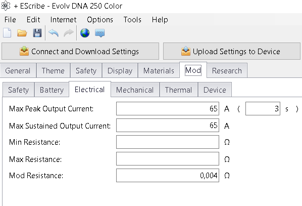

I have one more question Dragan, where do we set this config? And yet if you have time, I would like to discuss with you, the output values, because I vape at so low wattage that the default values look to me way too high

Thank you Dragan, I will adopt your settings, well I will decrease them even more to 25, 15 because I only vape at 42W, and the tendency is to decrease the power even more once I finally get my hands on a fused Clapton 2x32 + 38 ss316.
Hello Dragan I'm sorry to resurrect your answer 1 year later, but the: Max Peak Input Current: 28A (1 s) Max Sustained Input Current: 18A caught my attention I wonder why did you decrease them from the default values, please have in mind that my electronic knowledge is low. Are Those meant to protect the board or the battery? Thank you in advance, hope to listen from you soon.

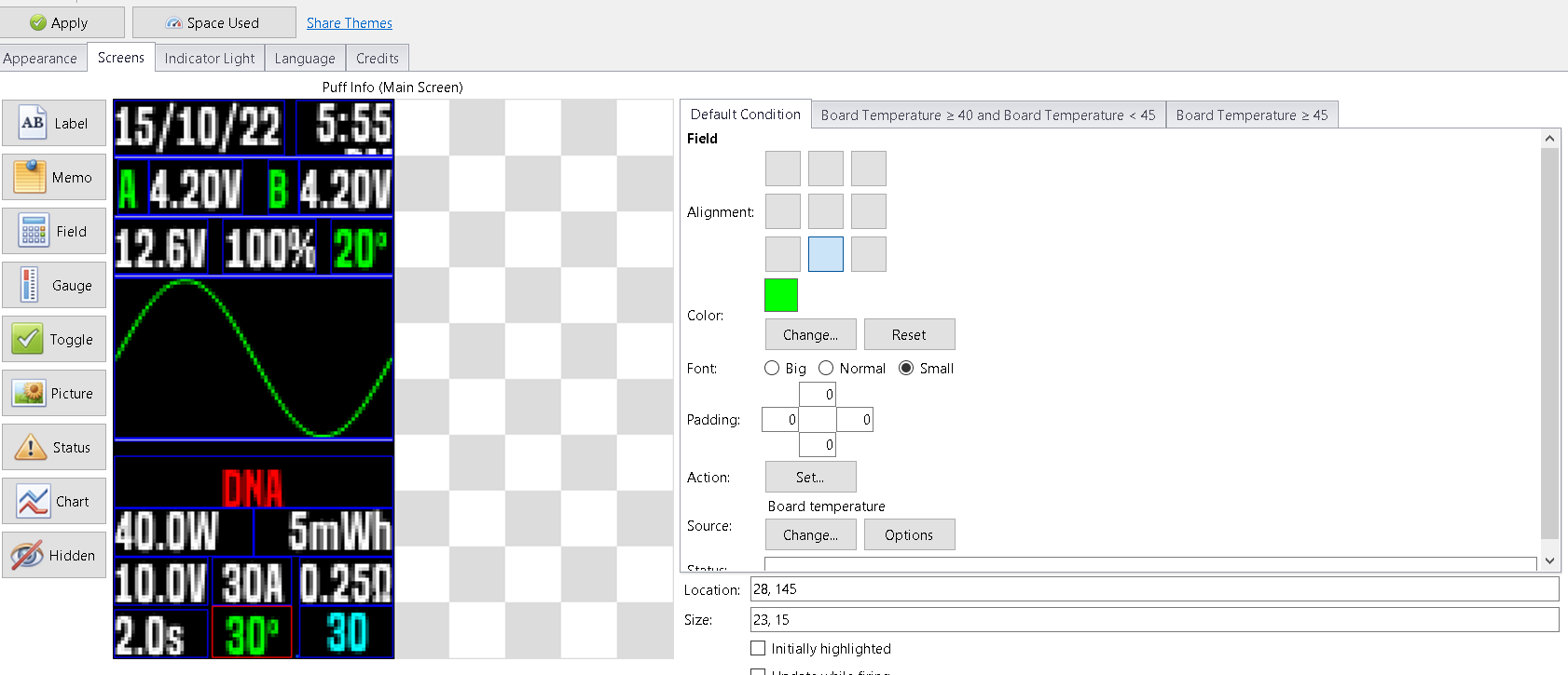

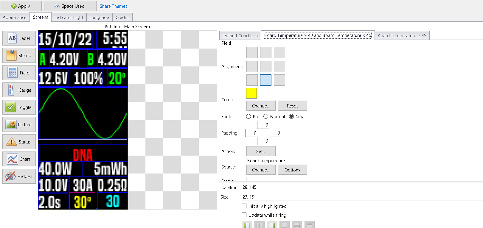

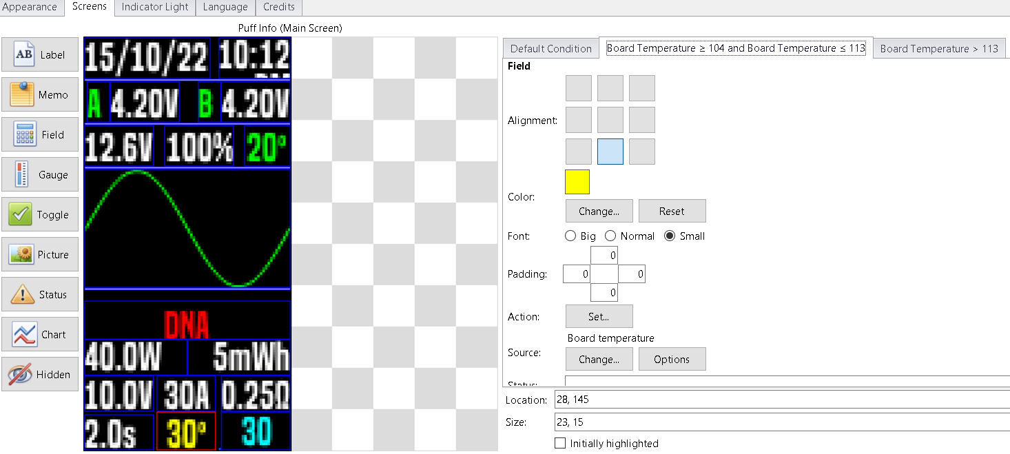

Yes, I did it an hour ago, and now it's working, I tested before posting a reply. you have to do it in Fahrenheit, and then the interface will convert them to Celsius, mystery solved , thank you very much, I believe I finally have my theme finished, not a fancy theme, but it has everything in hand, unfortunately I can't do the fading active time config on the mod, but well, maybe in future. thank you CMK for your help

hello im having a difficult time creating conditions on my main screen, for the board temp and room temp, ive done in the past several time and never had a problem, but this time im having a bad time with this. what i want to do is so so simple that im even achamed of asking for help. so I want the board temp to show below 40 celcius GREEN above 40 and below 45 YELLow and finaly above 45 RED I know this is very simple to do but is not working for me, i dont know why, and ive tried several aproxes but im unable to find where Im failing, can any one one give me an hand on this ? thank you
