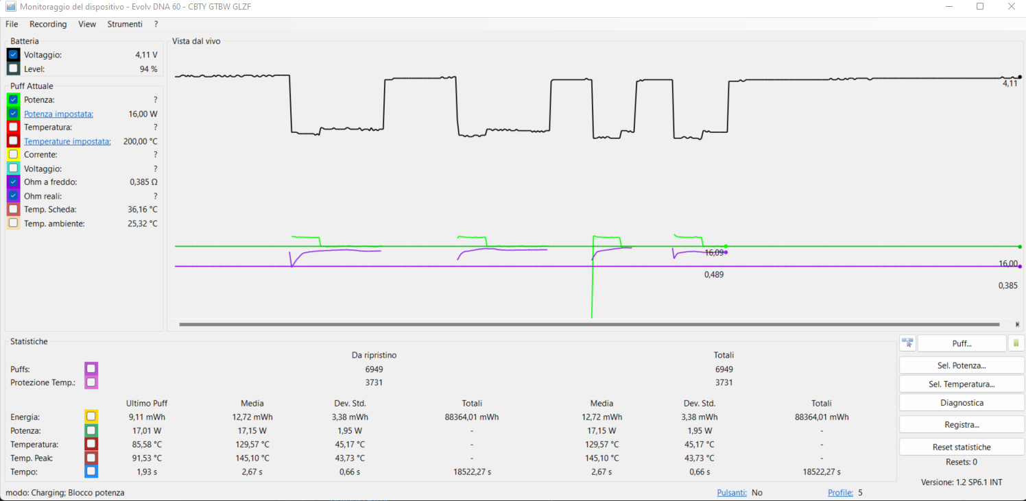

  2. @BillW50 I don't really have an answer for that. I vape in MTL and tried at 16 watts. I am doing microcoil with 27gauge. Now I tried to put to 20w and it arrives to 220°C. @Wayneo Yes, now it seems it's working. So this is it? Do you think the screws were the problem?
  3. I tried to change the screws on the deck and this is the result:
  4. Oh no, sorry! I didn't understand. The first screenshot is from the AIO, the second is from a regular DNA 75c box.
  5. Yes, it's a Dovpo Abyss
  6. This is the same test done with a different box. So, is it the box that doesn't work?
  7. Hi @Wayneo! So, I did the test and the Ohm's values show small rises of 0,001 but the value doesn't stabilize. And then I will attach the screenshot of the Device Monitor.
  8. Thank you @Wayneo. Unfortunately I can't test the box until Monday. Will update you on Monday morning and test the box.
  9. Yes, I will try. Thanks to you and @Wayneo
  10. So I'm gonna enjoy it in variwatt mode. A little sad and angry, this RBA costs 120 euros 😅
  11. Doesn't work either. Can it be the RBA?
