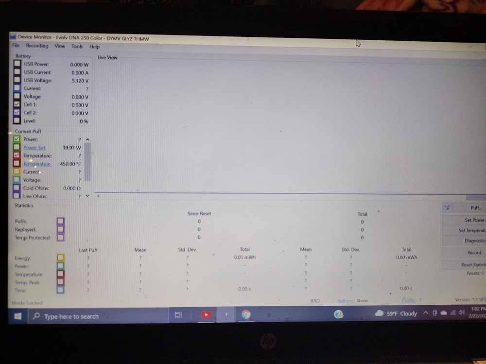

  7. Yea the batteries go in parallel and I opened a ticket and got a reply earlier asking for the screenshot of it in device monitor just waiting to hear back from them
  8. I can't even get escribe to recognize it not I'm just pissed off now I love DNA boards that's all I use but only 75c and 75 and 60s but this has me mad there should be no reason it's doing this with less than 400 puffs on it
  9. It was fine i bought it from someone used it for a couple hours changed the theme went to bed woke up and it started doing all this. let me know if you cant see the picture
  10. This is a pic of it in device monitor
  11. Yea I'll do it when I get home in a little while and I restored defaults already and then applied both of those service packs and it didn't do anything
