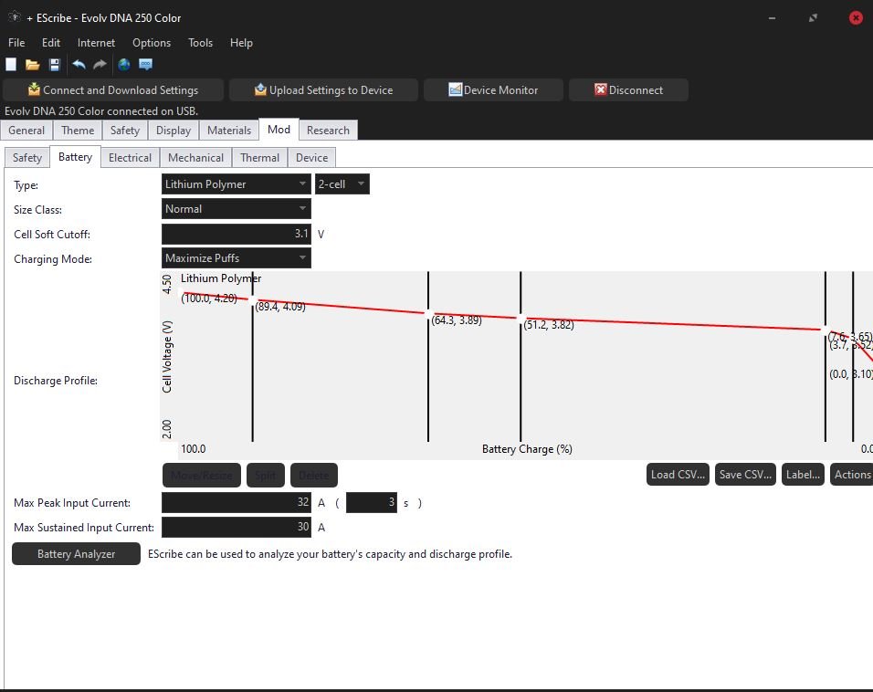

  1. I'll check the battery settings out tomorrow mate thanks. In not sure what steam crave do to the dna boards so can't comment on it.

  4. I didn't click on the power set option? How do I turn on those values? They aren't there on my escribe. I didn't change the battery curve as it's not a lipo mod, it's dual 21700. Should I still be changing it?
