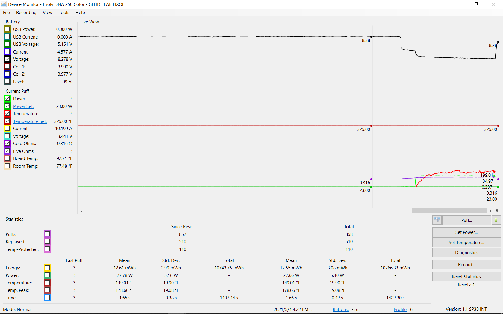

  12. I set it to watts and uploaded. Took a puff and it’s not as strong as when I had it set to 316 and of course the temp says n/a now on the atomizer menu on the mod.

  15. I wasn't sure if you meant to fire it or not but here is the settings cold. And here it is firing. I can't do it long since I'm at work and can't let the boss see me.
