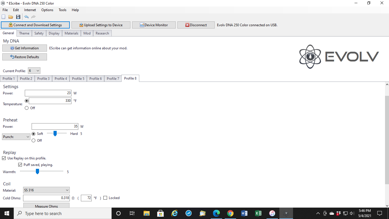

  3. I was ready to give up and was checking emails and saw that I got a response from Jacob on the Evolv help desk that I somehow missed yesterday. He suggested the following and it actually worked. I was ready to send the unit back as defective. I just wanted to let you know so if you run into this again. Once again, thank you so much for all of your effort trying to help me. This is what Jacob had me do. "Connect the Device to Escribe and go to Options>User Interface> ManufacturerThen go to the mod tab, then safety.Under the option Replay, switch this from Restrict to viable coils to Allow dubious coils."

  10. Just on the mod?
  11. No, still doesn't say save puff.

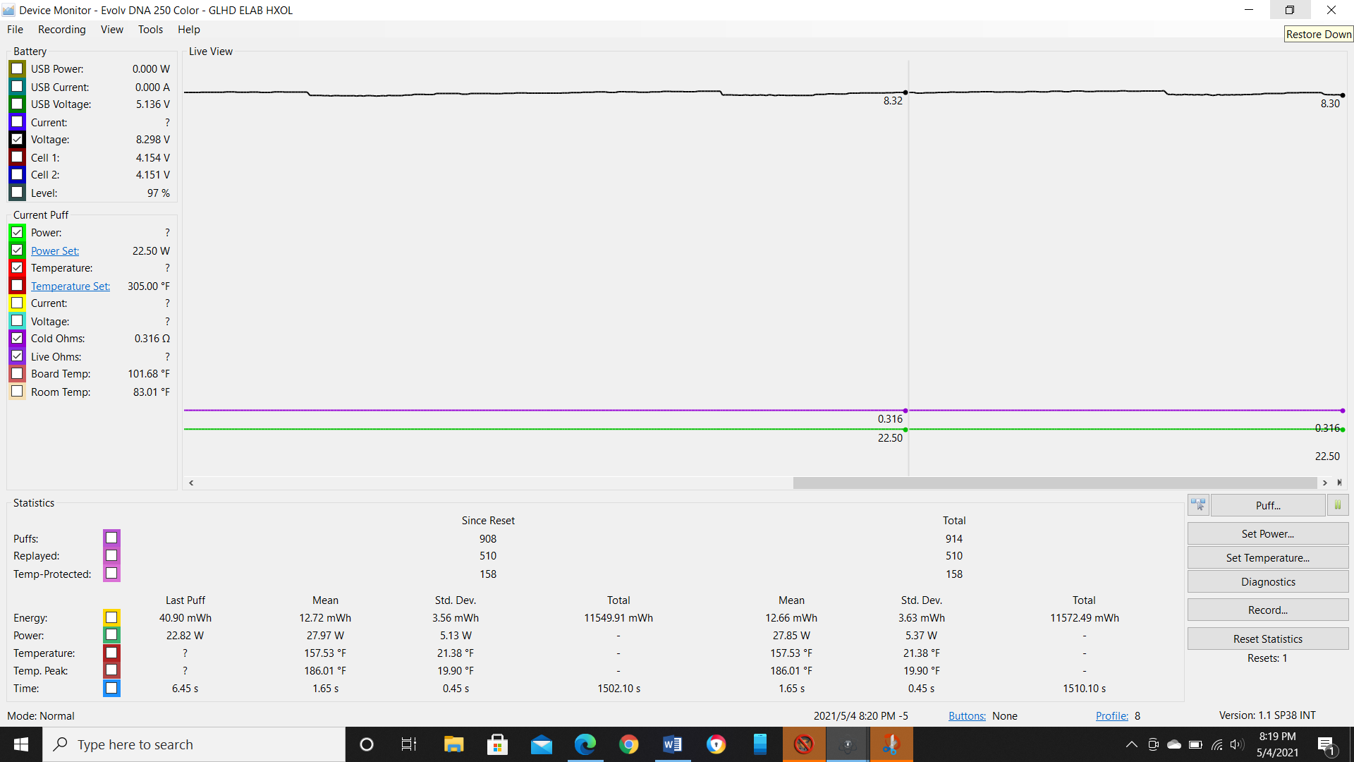

  12. I set it to watts and uploaded. Took a puff and it’s not as strong as when I had it set to 316 and of course the temp says n/a now on the atomizer menu on the mod.
  13. Ok, I did the hard reboot but didn’t notice that the mod did anything. I did the connect and download and the puff saved box is not checked.
  14. Should ohms be locked? I tried what you said and still not working.
