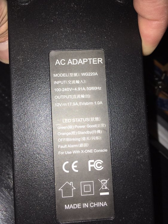

  3. Measured voltage at the PSU at 9.3v and the manufacturer is saying it should be 12v so I am waiting on them to see how we are going to move forward.

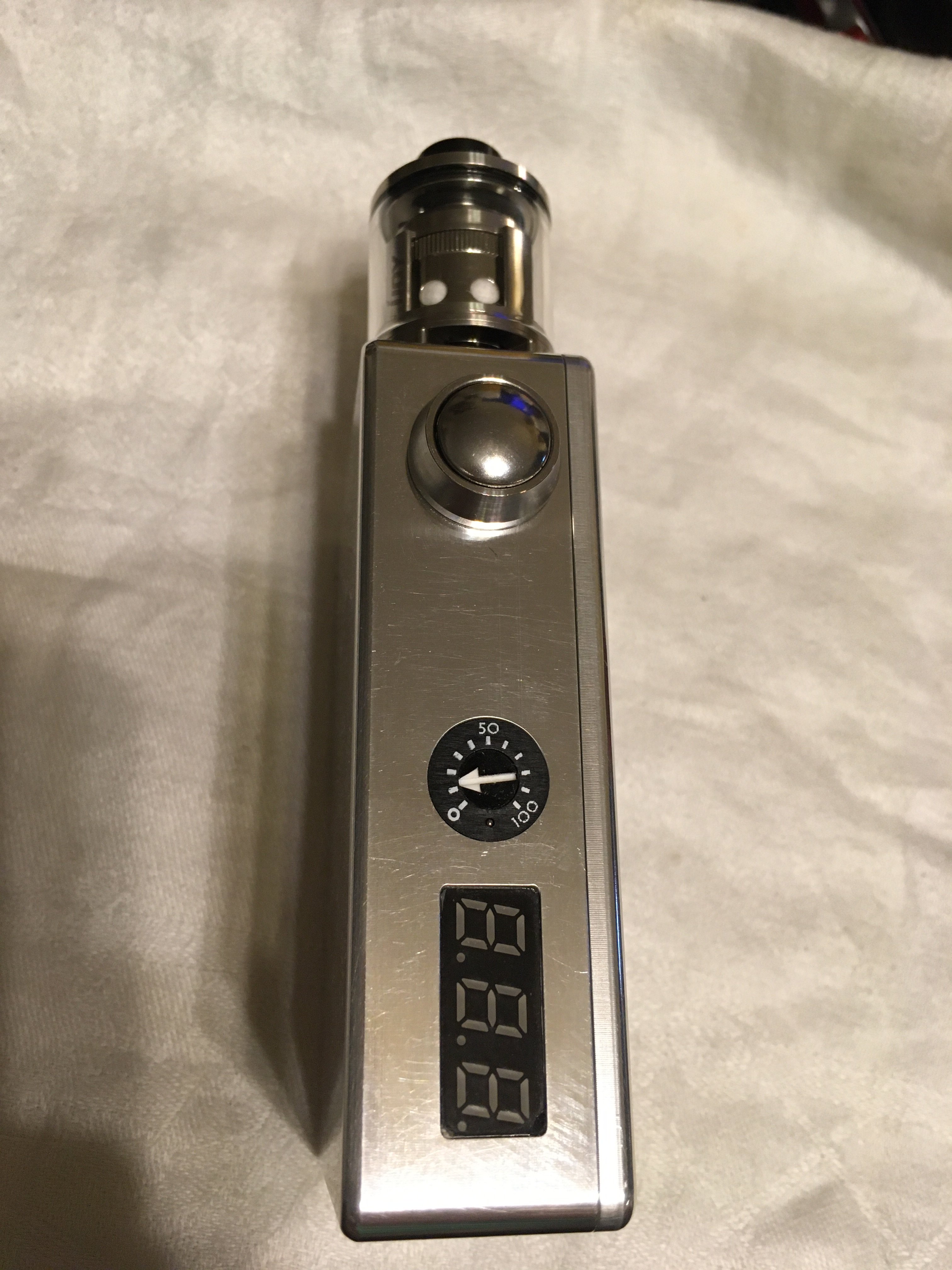

  4. I sent them an email. Thanks for the help. Ill update after I get an answer.

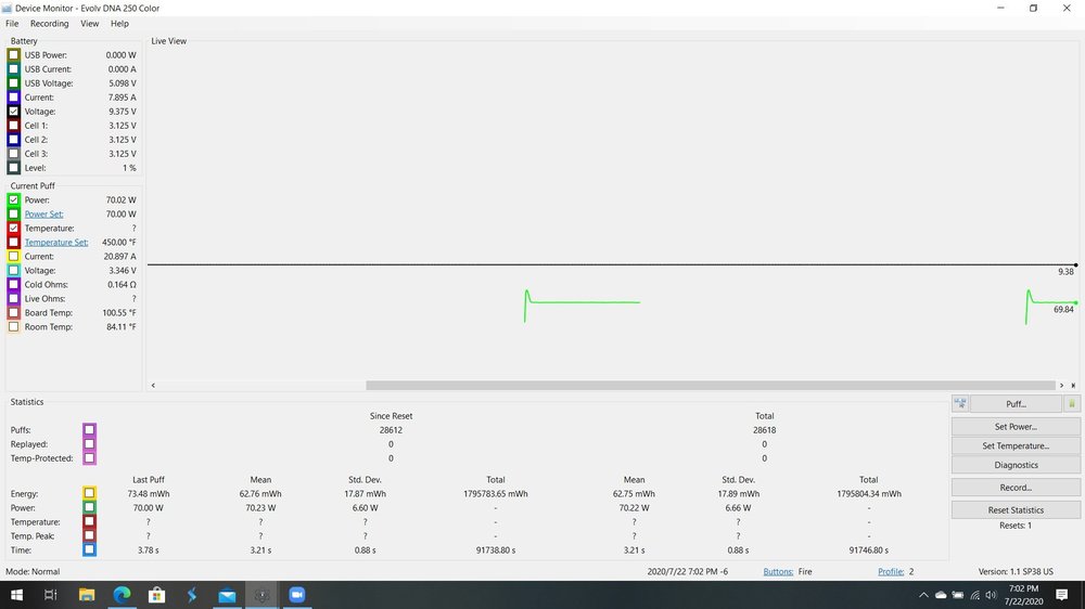

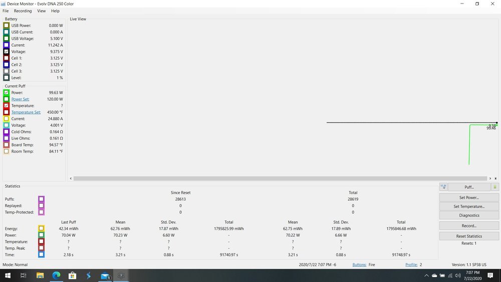

  6. Here is set at 120watts ...get 99 watts
  7. while firing
  8. But even at 9.375v shouldn't I be able to get more wattage out of it?
  9. output states 12v on label... Not set up to actually test it
  10. take a hit at 120 watts...puff info show 97.8 watts...wont go higher. . .16 ohm dual framed staple Ni80
  11. nope its set to power supply 12v
  12. That might be the problem its set to 9 volts and the power supply is 12v let me try it
