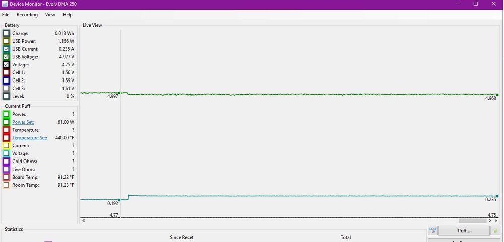

  4. now i'm hearing it might be a blown fuse. after it charged last night the battery almost dropped to zero for i don't know what reason. though the usb current is now higher at .23 it's still low. and i've let it sit charging for hours and its still stuck at zero percent. even with usb battery recovery. the usb power is at 1.1 now. do you guys think it's the fuse?

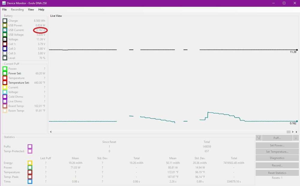

  5. ok i took out the board cleaned it now the usb current is at .19a its hard stuck. i think there is something wrong. not sure what i can do anymore. the board was made in 2017.

  7. Update i let it charge overnight. since it would be another 6 hours or so. i woke up to find that the battery has drained to zero. but now the usb current is .23a rather .16a
