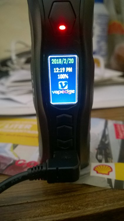

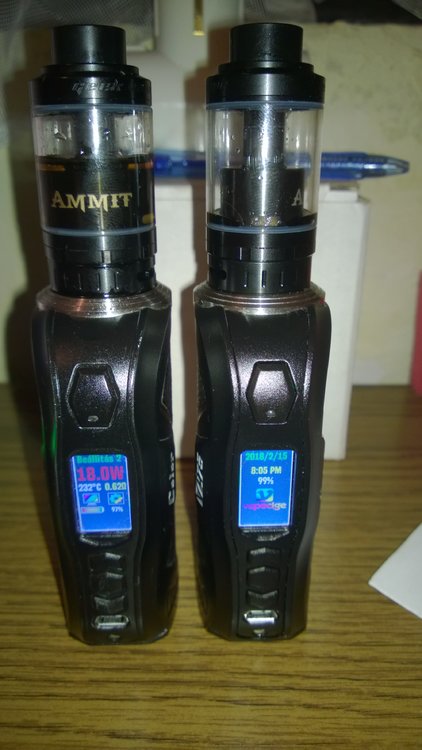

  1. In EScribe go to the mod tab and change your discharge profile so that the point for 100% has whatever voltage those cells measure when fully charged. If your mod still shows 99% or something, reduce the voltage value for 100% by 0.01V.
  2. battery charge level stops at 98-99%,That's my problem!
